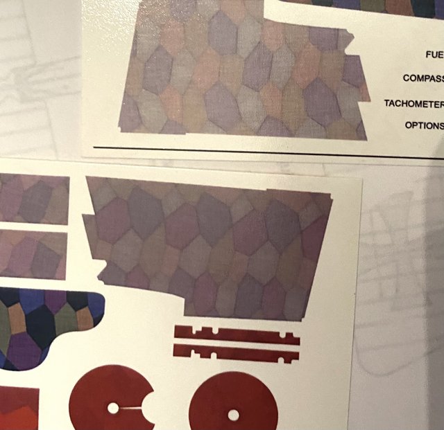

« Reply #4 on: January 27, 2024, 01:40:06 PM »
Hidde, I checked some Aviattic interior lozenge, and apparently Richard's research revealed pretty much what I was theorizing; he printed the fabric on Lothar's red-doped D.VII (bottom) a shade darker than the clear-doped linen on another D.VII sheet (above).

Re: Fokker D.VII interior
« Reply #5 on: January 27, 2024, 07:23:32 PM »
I should have done that myself..... thanks!!
I think I can get a similar effect by using a grey instead of a white base color, have to try that.
many thanks, Hidde
