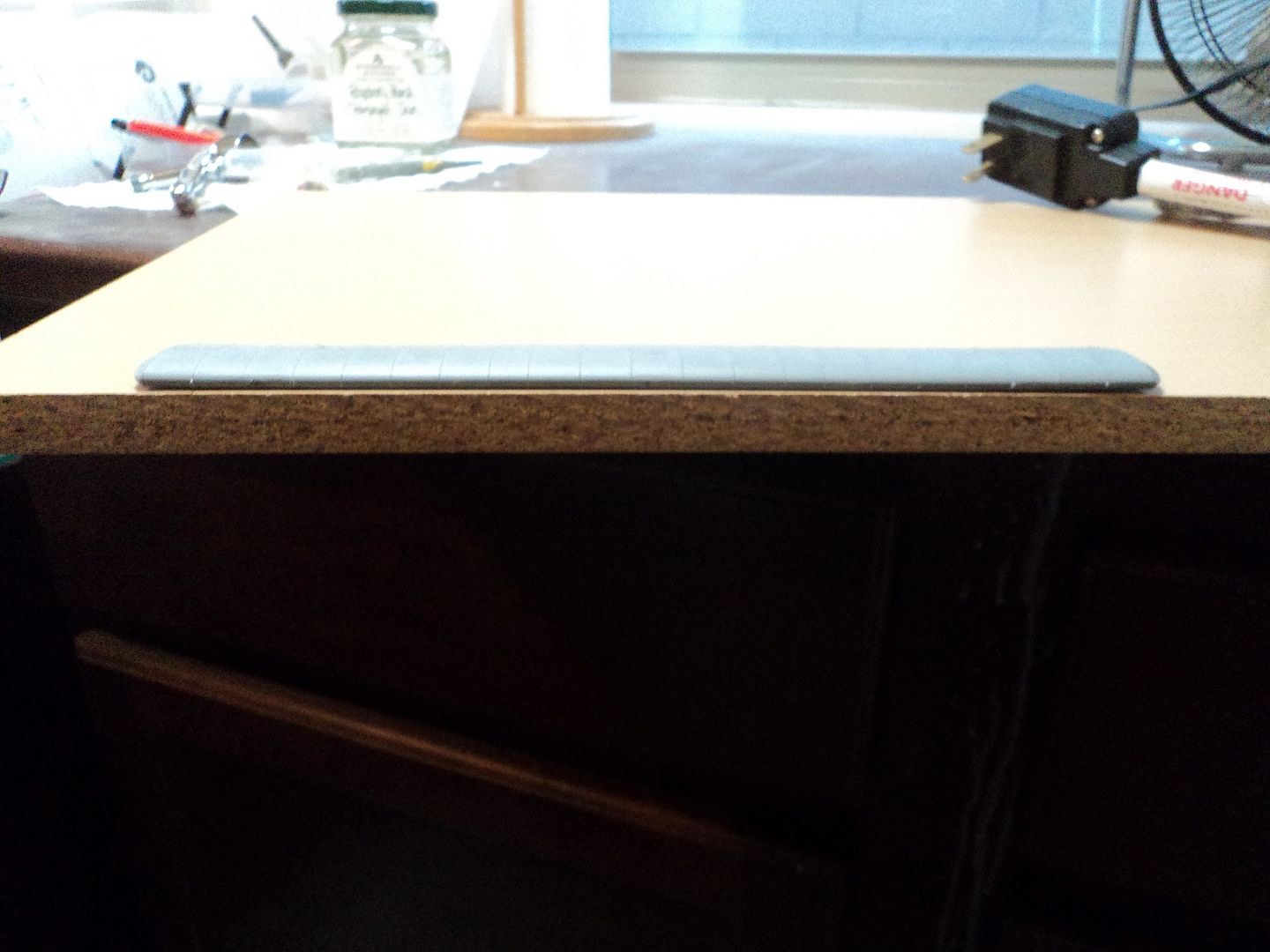

 I have read of modelers efforts to undo the dihedral on the upper wing of the Meng Tri-plane kit, from hot water, to just judicious bending and hoping the wing doesn't break.  Here is what I have come up with.  First, ensure you have a straight surface.  You can see in the images below I am using a particle board shelf that is pretty close to straight.

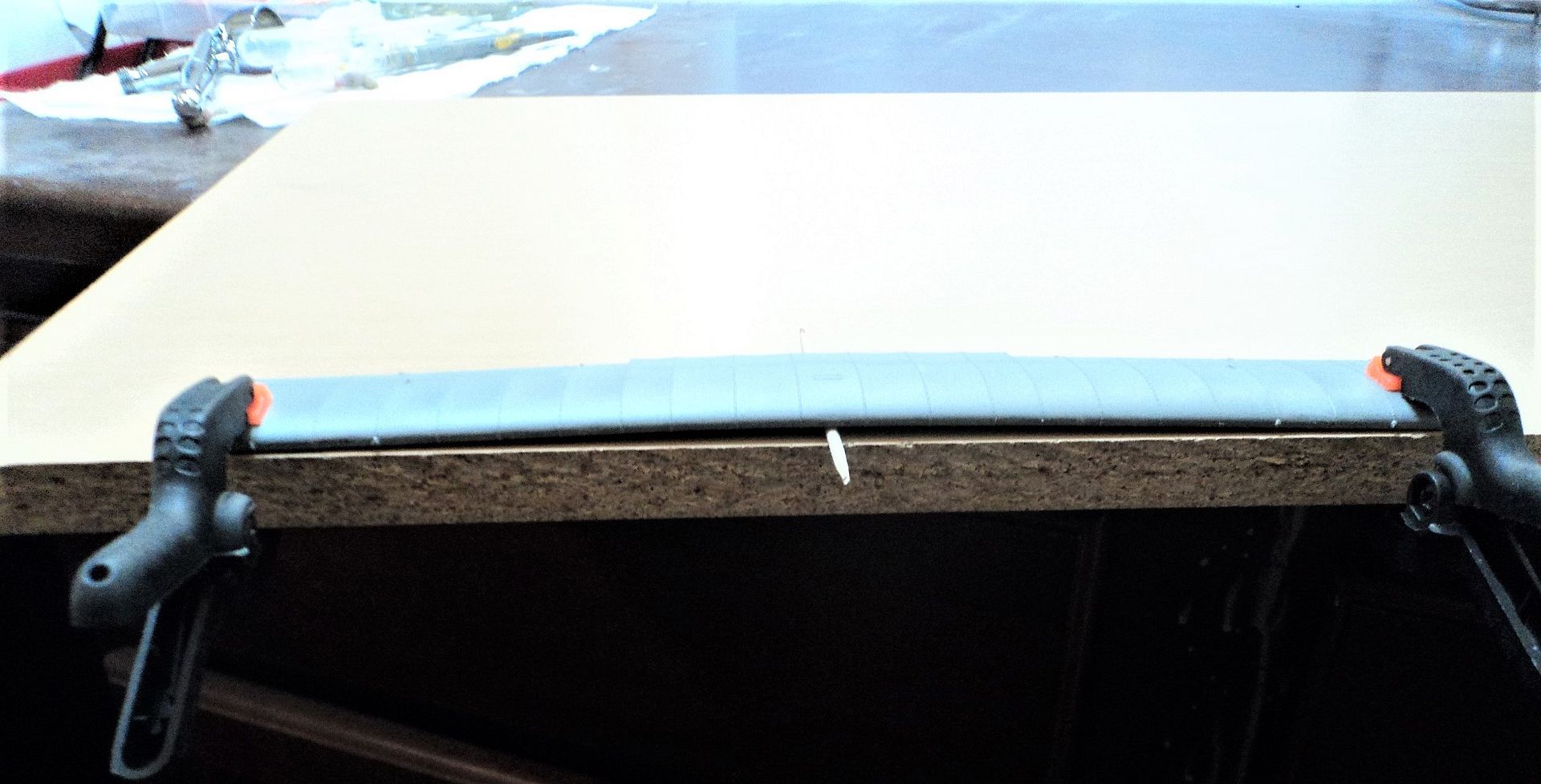

Using the clamps, clamp each end of the wing to the board.   Find center on the wing; it's the panel with the window on it, and slide the toothpick under the wing to give the wing "anhedral".

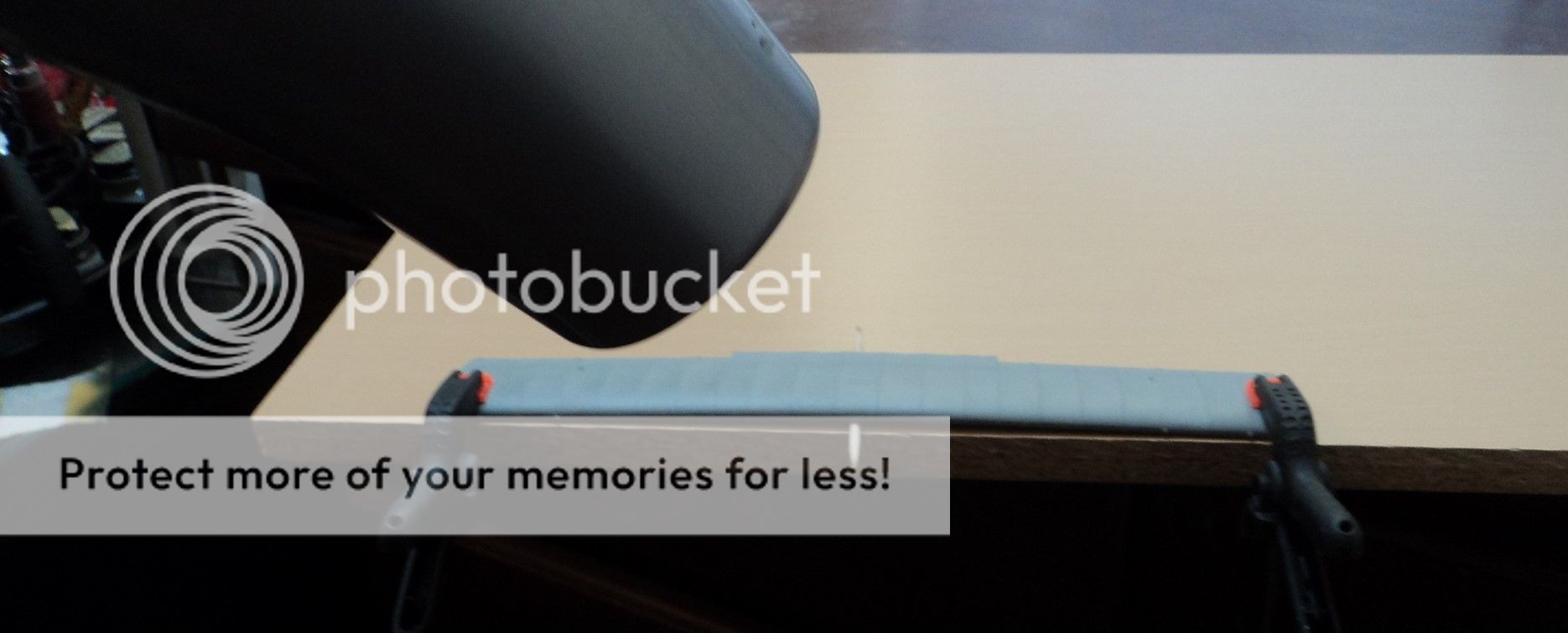

Next, with a hair drier on hot start to blow hot air over the wing.  Moving the hair dryer continuously back and forth.  Check frequently to ensure the wing is straight.  Once the modeler is sure the wing is straight, remove the tooth pick and clamp the wing to the shelf, let sit overnight.
And:  Viola!  You have a straight wing.

Hi Frank and Vickers:  I just put it on high and moved the hair dryer back and forth, frequently touching the plastic to ensure it wasn't at the melting point, which I don't think it is.  If  you keep it moving the plastic doesn't have a chance to get to the melting point.  Do it for about three minutes and then check the wing.  If it is still warped, do it again.  As the Meng kit is Styrene it worked fine for me.  I don't know and can't say how it would work on Resin.  The principle is the same as the modeler is applying heat to the object, but if you have resin, test it first.
