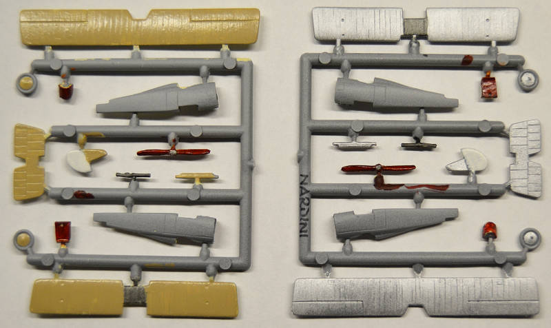

Here are the sprues:

I see two major problems on which I ask your educated advice:
- the struts are all provided as PE parts. The problem is not being too thin but too weak. Should I make them from thin plasticard? I am afraid to set them in tension when rigging the wings...
- Yeah, rigging here needs a genial idea, I need Ondra's advice here!!!!

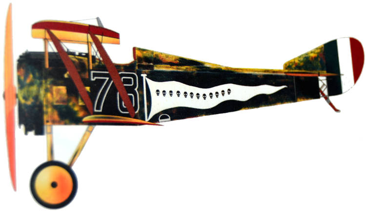

Fucini's Hanriot  was a Macchi built, so it was classic CDL and had the fuselage and the upper surfaces painted in a darker shade of beige.
The cockades were the normal ones, with the outside circle in green.
The camouflage of this plane was overpainted on the factory dark beige and, according to the big book by the Historic office of the Italian AF, was not exactly as depicted on the box, it should have two colours roughly painted. A reddish brown and a dark green.
Something like this:
The paint was thicker and darker on the fuselage sides and on the upper side of the top wing and less thick on the upper side of the bottom wing
This is a publicly available photo from which the historical office of the IAF deduced the colors, plus a couple of other photos in the book not available publicly on the net.
Number 78 could be black or red, in this case it seems red was the best hypothesis for visibility reasons
In another photo it appears with a white border
The big white pennant painted on the two sides had 12 black skulls representing the victories he claimed (he was officially awarded 7 kills).
My idea is to paint it like this version.
The Hanriot flown by Nardini was French built and the canvas was aluminium doped, the cockades were repainted from the French (the blue inner circle was repainted green).
Thanks for watching an I am looking forward to getting some suggestion!!!

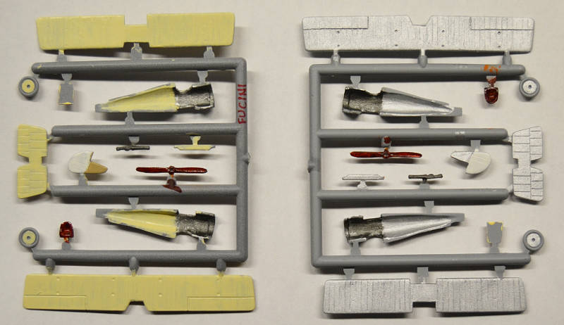

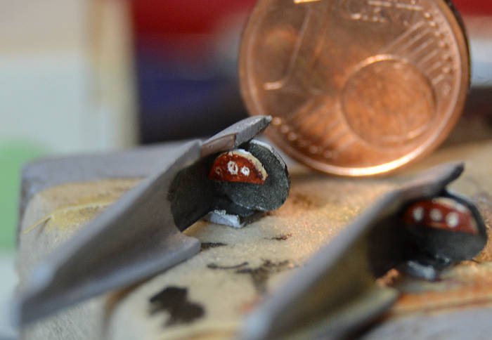

Here are the pieces painted while still on the sprues, too small to be held in the fingers!!!

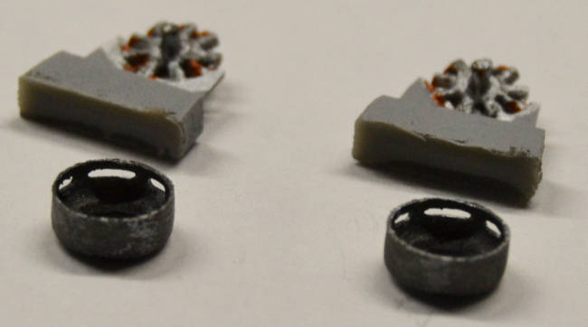

Engines and cowlings (you can see some electrons escaping their orbits if you look at the photo very carefully...

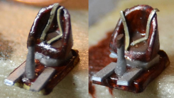

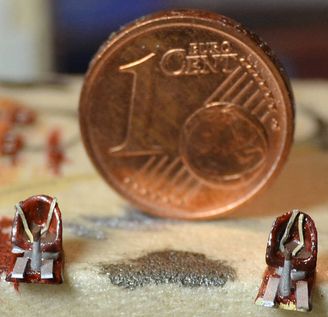

I tried to enrich a bit the pilot place, skids on the floor and control stick were not supplied by the kit.
The lumps of glue at the bottom of the sticks cannot be seen after the fuselages are closed. I used 0,5 mm diameter plasticard, a smaller size (I have 0,3) would have been nearly invisible.

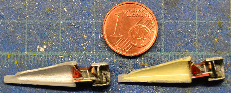

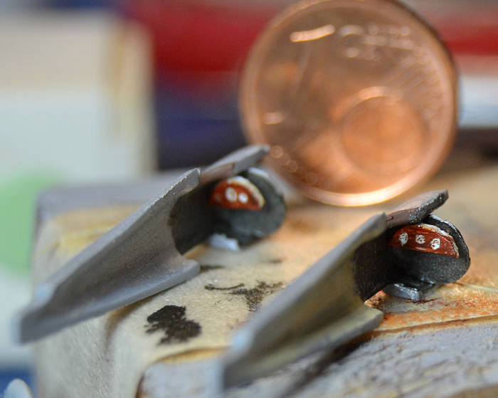

Instrument panels and firewalls (not supplied by the kit)
everything at its place
At the end of the evening session I closed the two fuselages, now they need some sanding and putty...
