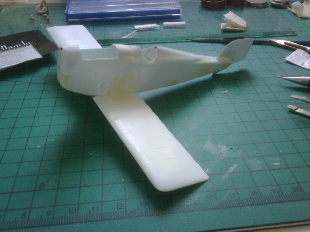

Some progress today. Cut open the cowlings, cockpit windows, made wooden slat effect on cockpit floor, made fuel tank. Decided to add some thickness to the fin/rudder, so glued it onto thin card (20 thou), sanded and reprofiled it. To add tapes to it. Also cut the lower wing in half, made temporary spar from brass tubing. Its starting to look better :)
There you go :)
« Last Edit: May 24, 2012, 03:52:27 AM by ta152c »

« Reply #26 on: May 24, 2012, 05:40:34 AM »
  David,
Wow the Aviatik is looking fantastic my friend. Outstanding work on her interior . Can't wait to see the interior complete and painted.I've got a feeling this is going to be really something else.
Re: Sierra Scale Aviatik D.I 1:48 vacform
« Reply #27 on: May 24, 2012, 07:24:44 AM »
Thats coming along nicely. Its like an injection kit now that the parts are cut out.

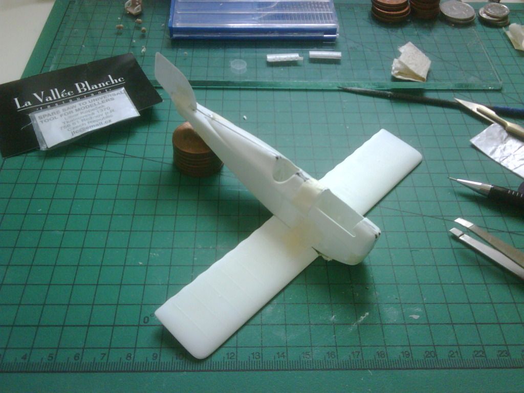

As promised, more work. Engine bearers, IP, fuel tank, opened up nose for frontal radiator, fitted it (cut a bit over :( but will repair). Cut out shell ejector chute and hole for mg barrel. Had to widen cockpit bulkhead with plastic strip, and noticed that port fuselage is a wee bit over-sanded at the nose. Thinned down the kit radiator part a bit, gap in cowling will be filled with plastic strip, and the condenser unit atop should also cover the join.
Added base for rudder bar.
Prop isn't the correct one, just there to give a general idea. Thickening the tailfin makes it look much better, I felt the one I sanded out was too slim in profile, but that was probably me, not the kit. Its very good, actually. I've learned a bit from it, and since this was my first thread, I need to finish it first.
Next job is rudder bar, control column, mounting brackets for fuel tank and buried mg, throttle lever and some internal stuff. Seat and seatbelt too. Its moving along.
There you go :)
« Last Edit: May 26, 2012, 07:21:20 AM by ta152c »
