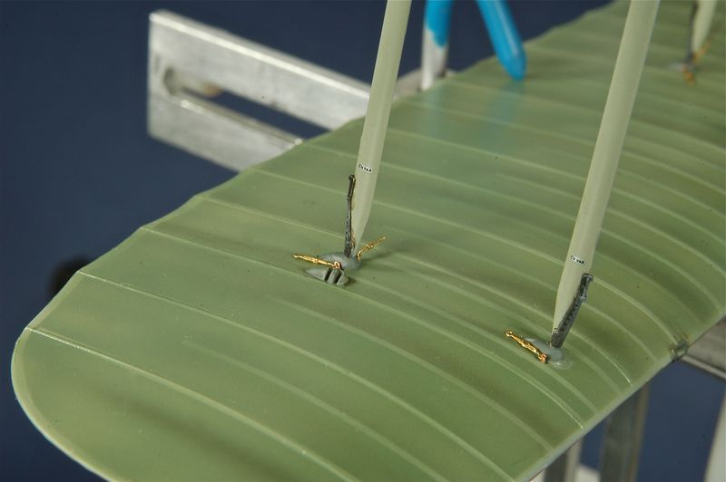

I was all ready to start putting the wing rigging onto my model today, making a good start with my first two EZ Line wires.
But studying the reference photos, there appears two mis-placed tie-points on each of the lower wings of the model. The base of the outer struts has an outside point moulded into the wing, to which I faithfully added a loop and turnbuckle. This tie point didn't exist on the aircraft, and the points that make the lower part of the outer strut "X" bracing have to be re-situated. I also have to add the lower ties for all of the "X" bracing between the rest of the struts. Not too easy, since the top wing is now firmly glued in place.
Prsemyslaw Litewka (PrzemoL) made this correction on his Polish version of the aircraft - but I've only just discovered this :-( So it's back to some minor surgery to correct my project for now.
