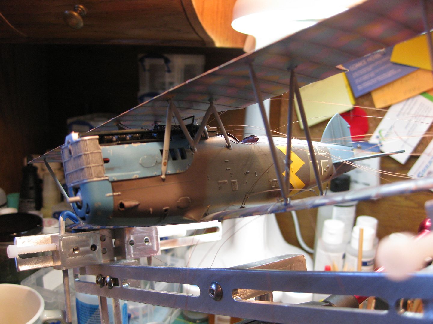

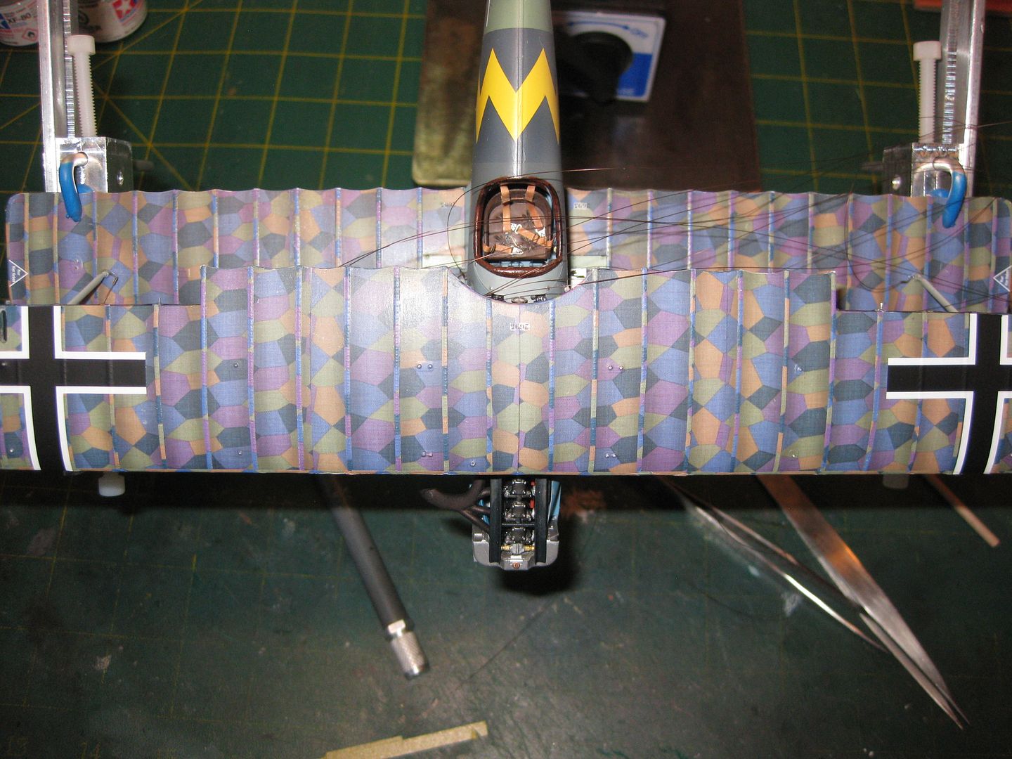

« Reply #188 on: July 24, 2016, 12:07:31 AM »

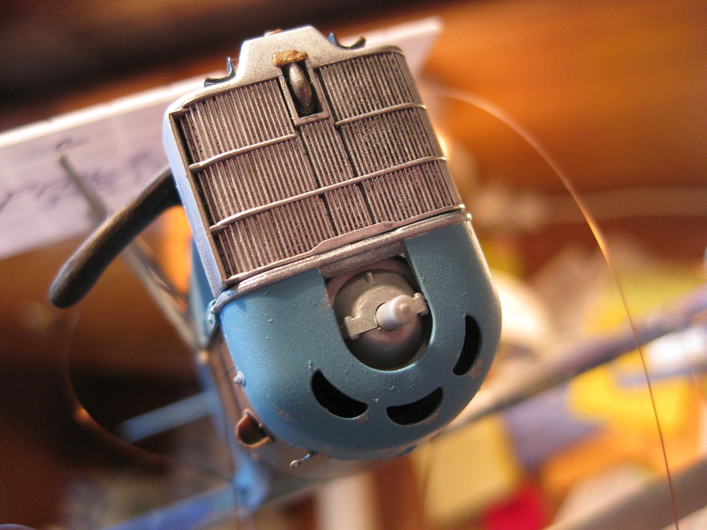

   I was finally able to put together several hours at the work bench and have made some progress on this Build.

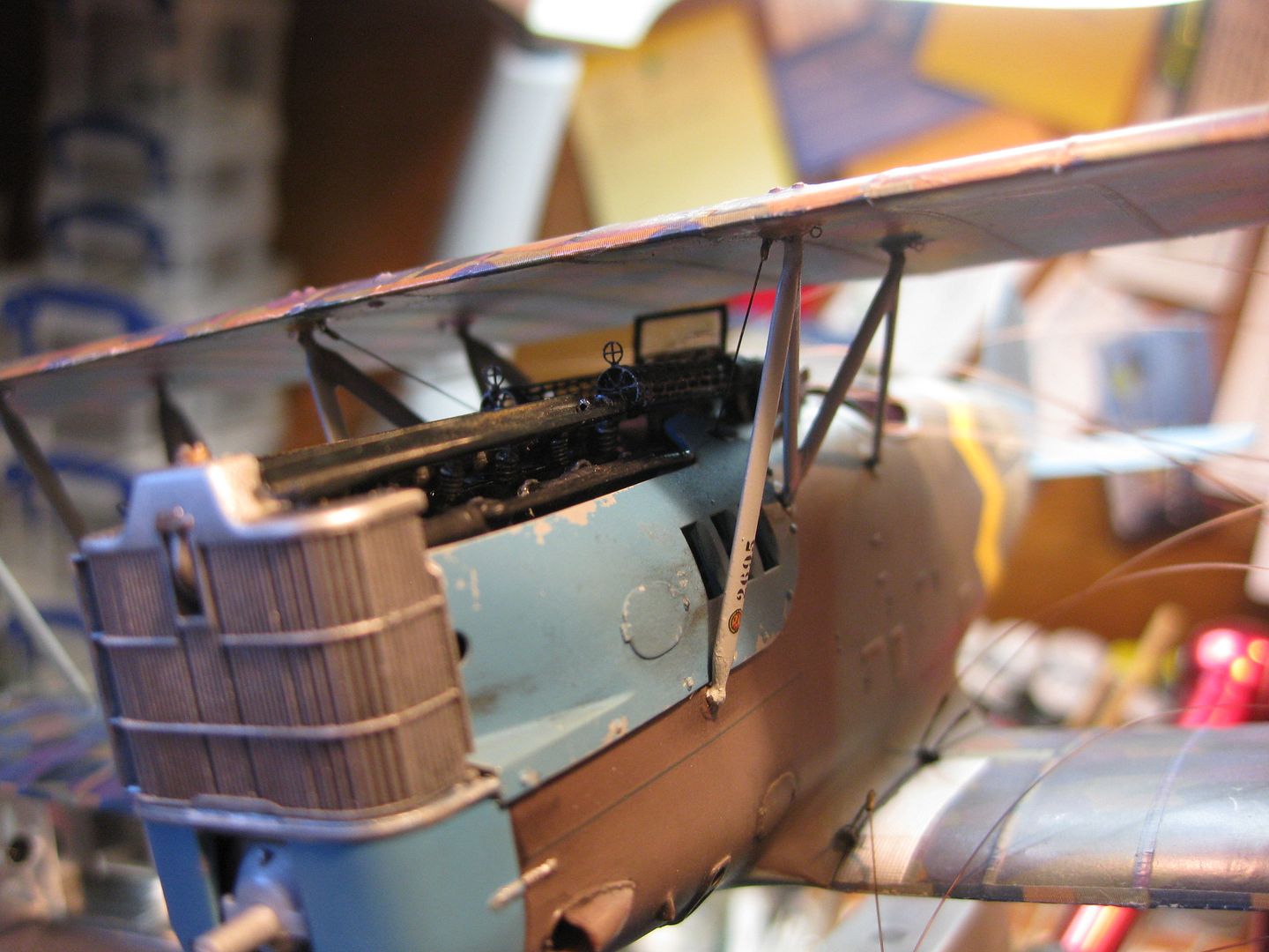

   The first order of business was to touch up the nose cowling and radiator assembly, as pointed out by Gary earlier part of the radiator had been overpainted with the personal blue marking. The lowest portion is now back to it's proper aluminum finish, nice pickup Gary!

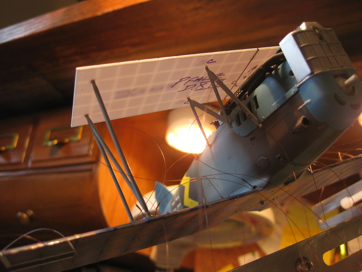

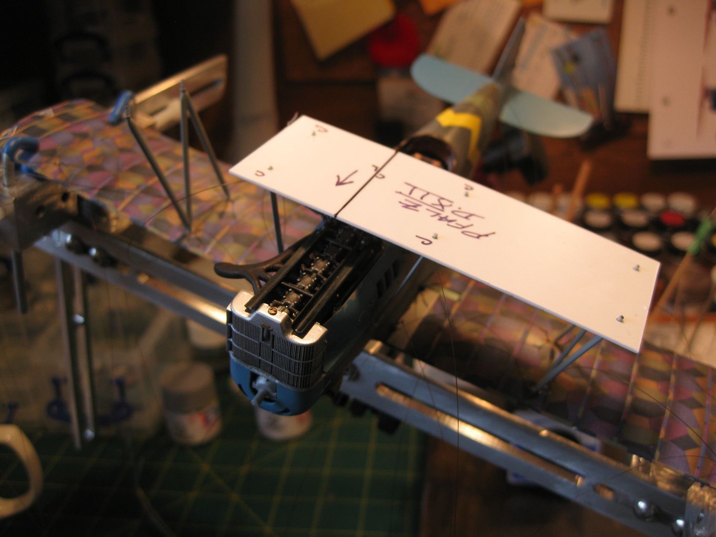

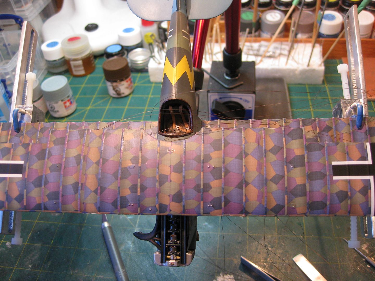

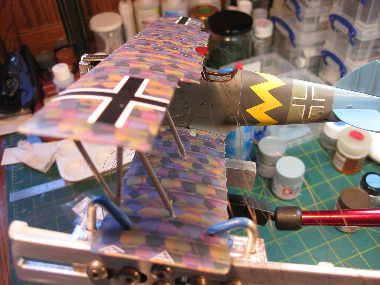

   Next came that most dreaded big step of Biplane construction however getting the struts done and the upper wing installed proved a relatively simple operation. All rigging lines had been pre-installed to the GasPatch turnbuckles on the lower wings and a simple template to ensure spacing of the cabanes and inner bay main struts was used to install the pre-finished struts. Medium CA was used throughout and, once dry, the outer bay struts were installed to the lower wings as well. I should add that the model was mounted in the "Magic Third Hand" device throughout this operation; it proved an absolute "godsend" and I am now a complete fan of the product!
   At this point the model was removed from the third hand, the upper wing placed top down on the work surface, the model placed inverted on the wing surface, and the struts then attached with Medium CA again to the upper wing from the cabanes outward alternating from side to side to optimise lateral alignment.

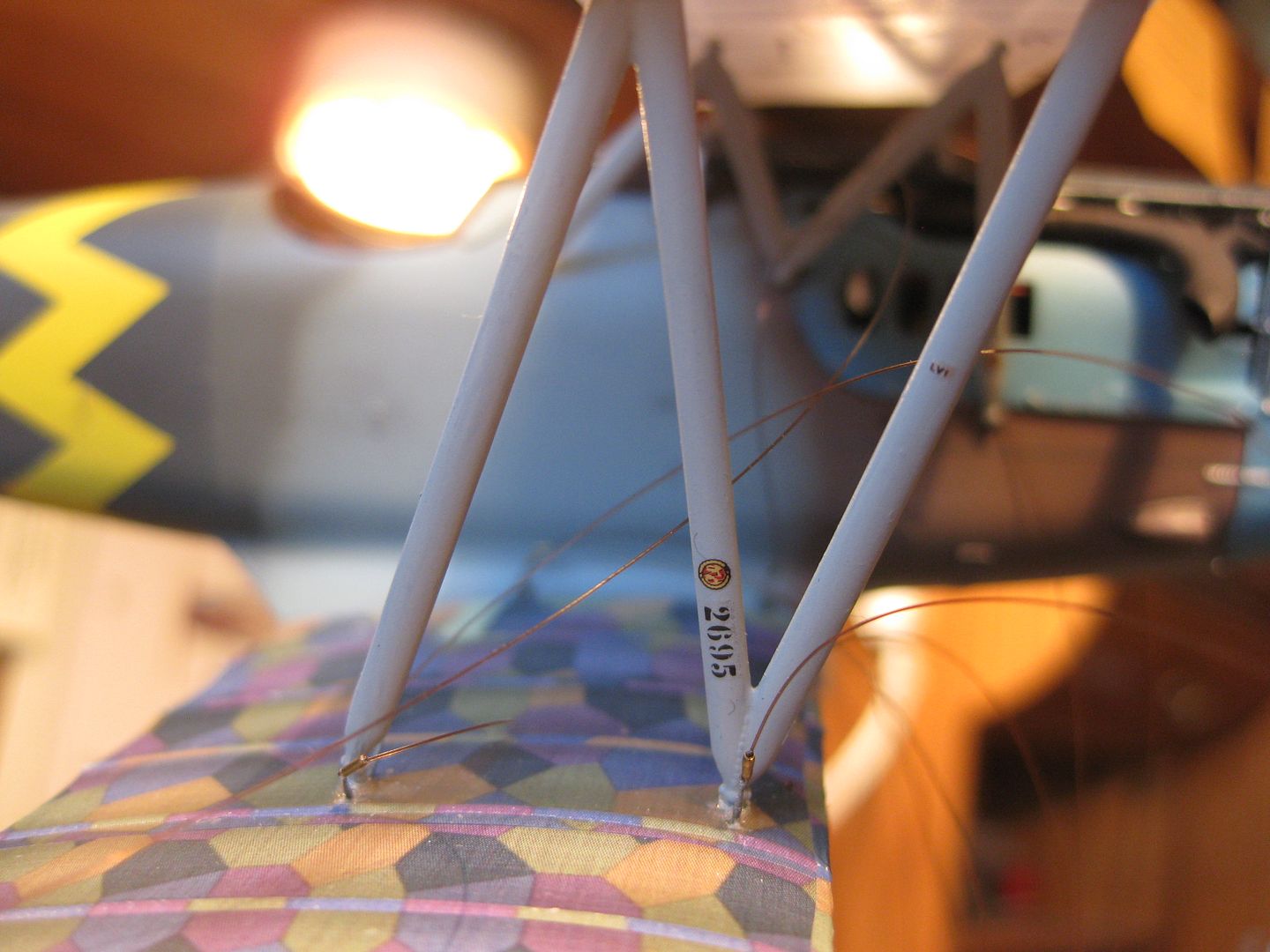

    Once in place and cured with a shot of accelerator on each join the model was re-mounted on the Third Hand and the single front cabane wires were attached to the upper wing anchor points as the first step of the rigging operation. This proved to be a delicate step given the very restricted space to work in between the upper wing and the fuselage decking, guns, and windscreen.
    I'm pleased with the results of this step; the wing is firmly attached and the alignment as good as it gets. There's a few small spots of CA to cover up with some satin over coat and all should be well.
    Next comes the main rigging exercise, she's starting to come together now!

Thank you Borsos. Yes, I never get any more confident about installing the second (or third) wing no matter how many times I do it. There is so much potential for problems, but it sure feels good once done, and the rest is relatively easy! I find I start thinking about what's next on the work bench!

This is looking very good now Lance. Yes fitting the top wing is always the real test of a biplane model and it is always satisfying when it works properly first time. I can see why you are using a jig to get the wing right on a model of this size - my assorted paint tins, tweezers, wood blocks, card and other jig material simply would not work with something like this (but it would make an interesting experiment to try!!)

Looking great with the upper wing mounted Lance! Your rigging turnbuckles are also looking terrific.

I very much welcome and appreciate your comments, Rick and Stephen. You are not far off with your comment Stephan, I resort to all manner of objects and material to get through the rigging and alignment stages. I'm hoping the Magic Third Hand clamping device provides for that missing set of fingers I always experience, but I suspect not entirely. The crazy part is when I hang various tools etc. on lines to provide tension, and then spend literally an hour searching for it later! :-[

It's looking very good indeed Lance  :) I like the idea of the reversible jig rather than one that does both sides at the same time -perfect symmetry ! (and stored in the memory bank for the future  ;))
Being able to move the model through all axis's with that third hand is a pretty impressive addition too - something also worth further investigation
