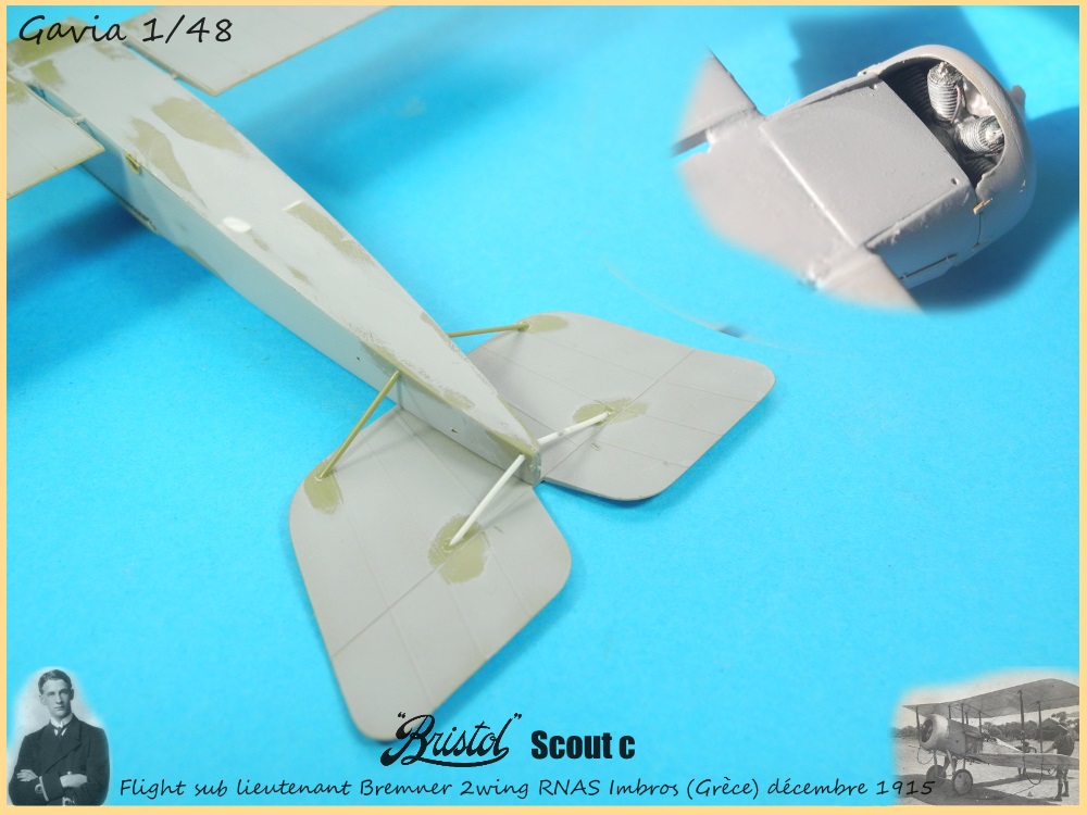

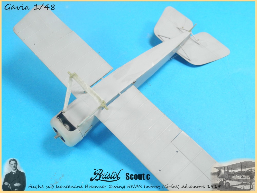

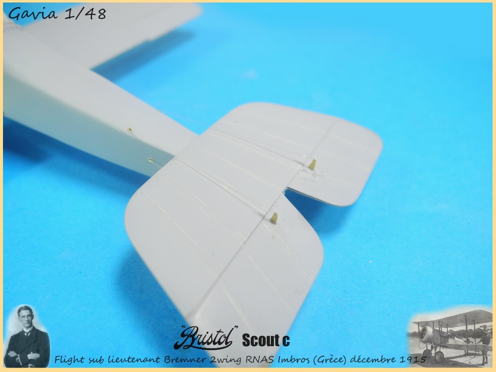

Under primer , those rib tapes look pretty damn good  :) Is this a decal ? or is something on the lines of thin tape ?
!yes it is. Decals in archer style. but after you put it, you have to take of a film. only the decal stays.
look the result
- Was the kit designed to have the lower wings fit flush against the fuselage? If so, will you have to move the strut attachment points to compensate for moving them both out?
Yes it was. they were two plastic attachment poits I take them off and remplac them by metal attachment...

yes i have this kit they address the space but with small plastic attachment it will break off i did just like xan. those rib tapes look great, really dress up the wings.

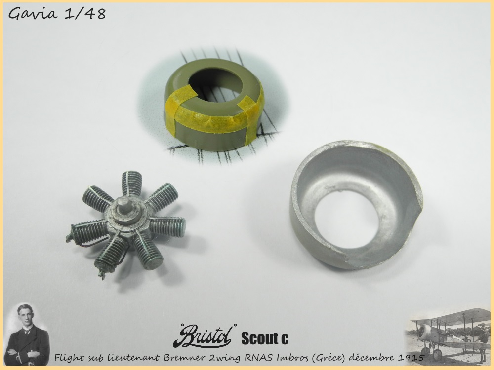

I did the engine , a Gnome Lambda 7 cylinders.
in fact, the 1264 have used two engines: Donald change the Gnome for a Le Rhone 9c, more powerful.
i did a gap in the engine ring (?)
It was evidentely to let the oil escape, but all the scout had not this gap:

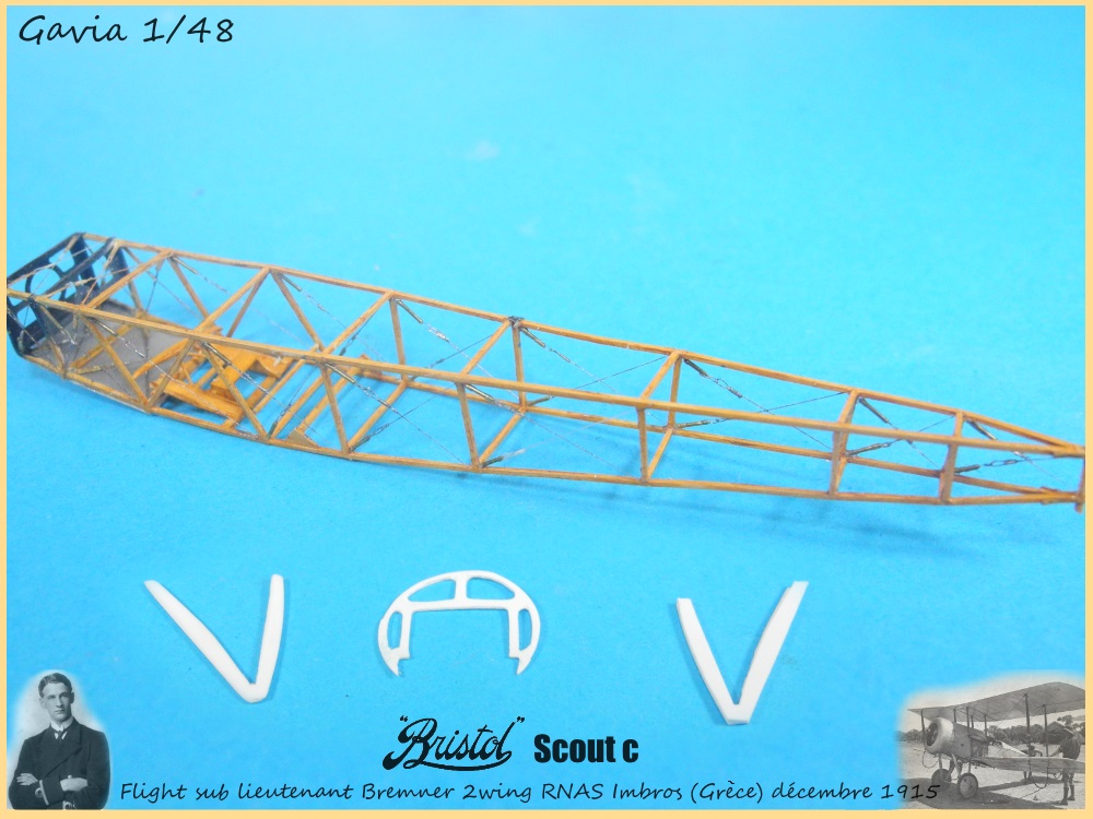

in the fuselage I did the foot rest, and put the seam (archer), and some photoetched:

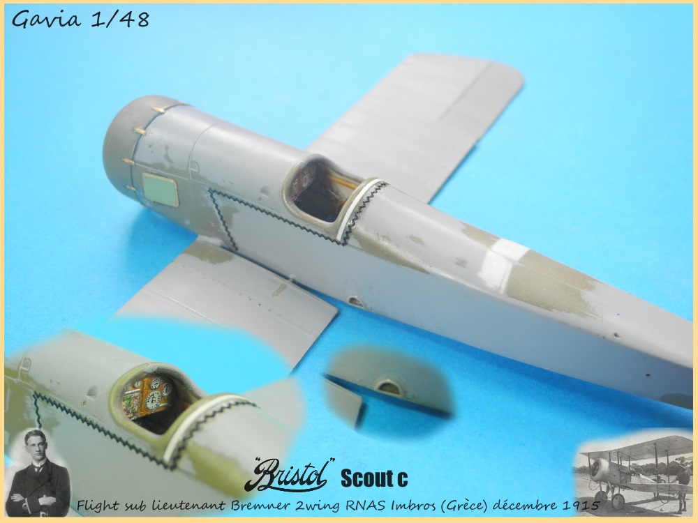

and with a little bit of surfacer:
I have to detail the tank, and some other details and we can soon start painting...

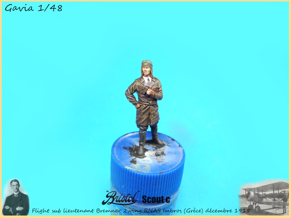

the figurine  had moustaches so british , burt "bunnie" nere had it so I cut them of
Xan

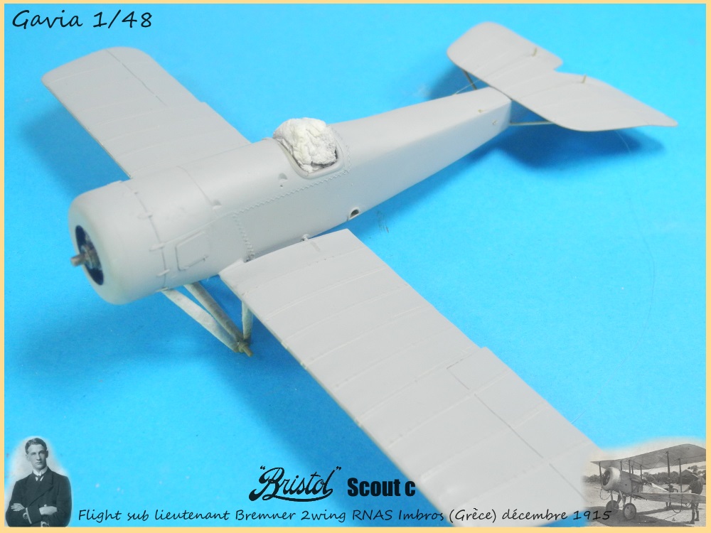

I  forgoten the ring attachments, and detailed the fuel tank with archer.

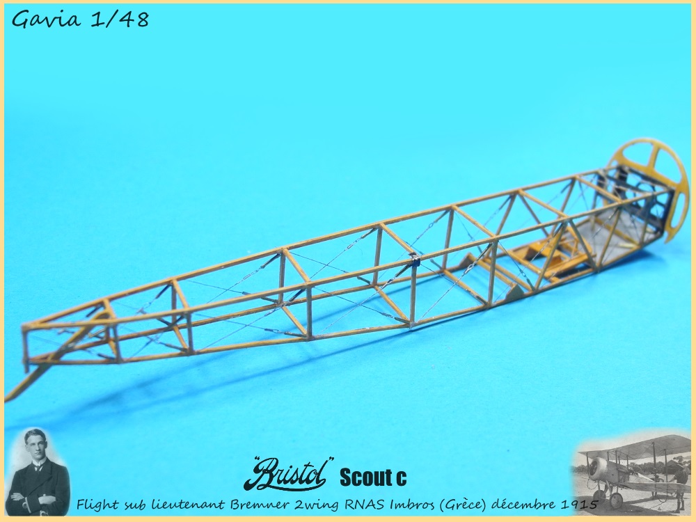

for the fuselage:
