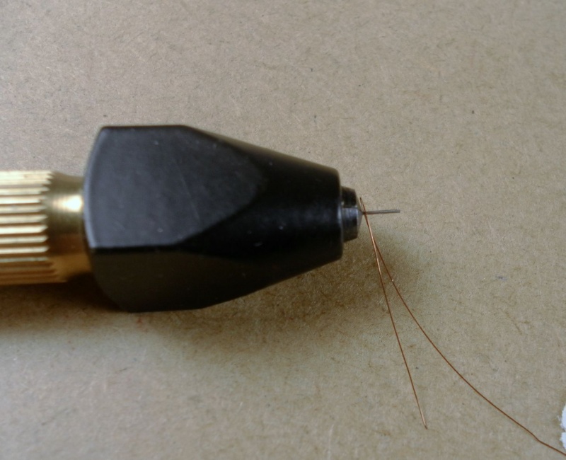

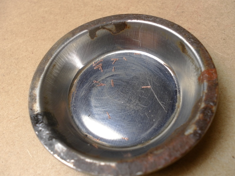

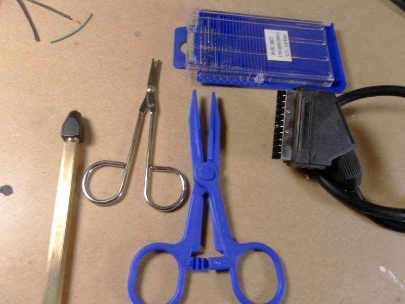

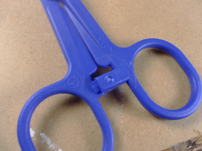

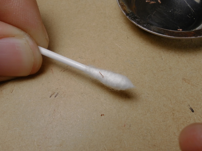

and here is what I'm going to spend the next sceance of workshop:
eyelets for tie downs shrouds
I show you my method that n is probably not a reference

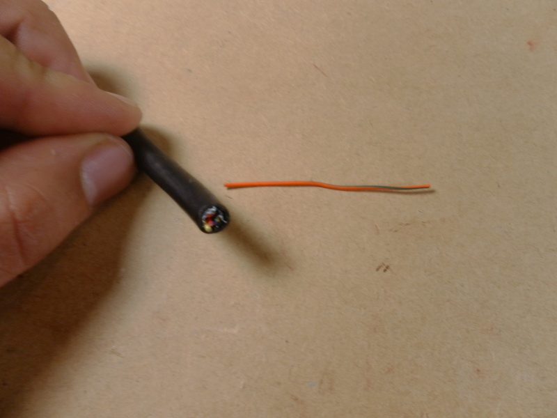

for that you need me
an old SCART cables
scissors has a very fine nose
micro drill
pliers to clamp
and a drill bit holder

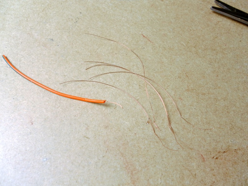

I recovered in the cable the thinnest strand

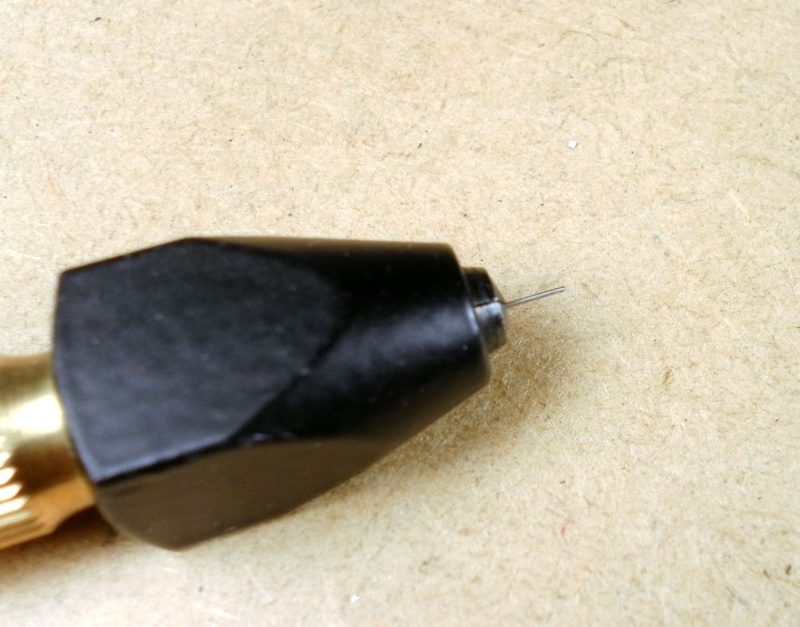

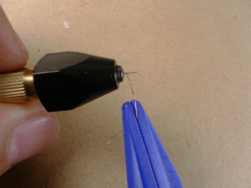

on the drill door I get a drill 0.40 mm to al

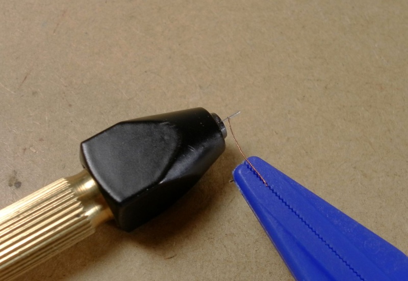

the wire is bent on the drill
the wire is caught firmly in the clamp has clamping and the latter is locked
it only remains to have the clamp trourner

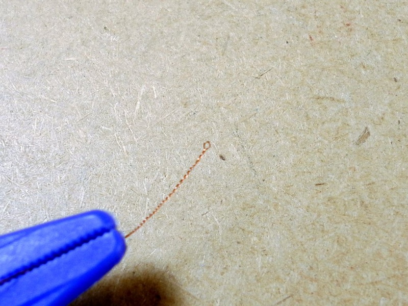

and here is almost done
and here it gives AC will further cut once the stem at the last moment
and still make a hundred ........................
Offline Ronkootje
  • Posts: 229
Re: GOTHA G IV wingnut wings 1/32
« Reply #57 on: January 05, 2015, 09:07:07 AM »
There is an easyer way to make them. :)
Ron
« Reply #58 on: January 05, 2015, 09:41:01 AM »
Have a look here Jeanluc  http://www.ww1aircraftmodels.com/page47.html  I make all my own eyelets and find this method extremely simple and fast.
Offline stefanbuss
  • Posts: 976
« Reply #59 on: January 05, 2015, 08:23:10 PM »
Quote
Yes. I have to agree. Des' method works much faster.
