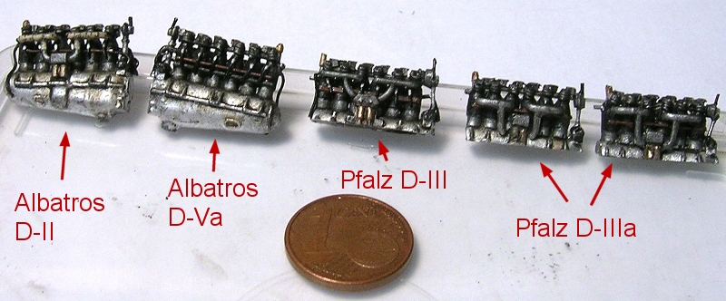

I've started building five Mercedes D-III engines. 3 will be more simple models for the Pfalzes, since only the top of them will be visible. The remaining two are intended for my coming Albies (D-II and D-Va). I finally got rid of the Milliput-cast engine since parts are too thick and too difficult to sand to have the halves match. Plastic copies of Roden engines are more suitable.

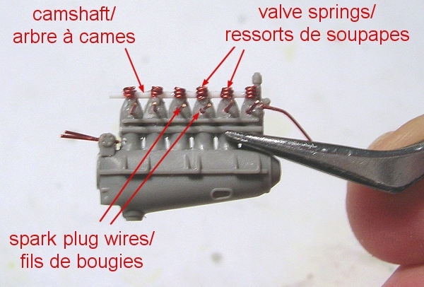

Let's start with detailing the engines. Those for the Pfalzes are simplified since only their tops will remain visible. Only the two for the Albies have been fitted with piping and spark plug wires. Valve springs are built by wrapping copper wire around a pin. For the third Pfalz, the exhaust stack is a copy cast from Milliput. Gas/air ducts have been cut away from the engines to make painting easier.
Next, valve springs were added after the camshaft has been glued on top of the cylinders:

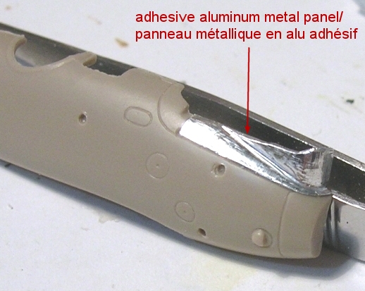

Metallic panels are just scribed on the fuselage, which is not very realistic. I've started replacing them with adhesive aluminum sheet, which will add the required thickness and replace plastic with real metal at the same time:

Thanks. It was actually a good surprise that adhesive aluminum can match such a complex shape! I hope it will work well with all metal panels.

The five engines after painting and oil weathering.
I've then rebuilt the fuselage metal panels with adhesive aluminum. It works very well, the metal strectches and matches the complex shape of the front fuselage. It can even be drilled or scribed (with care...). After I took the shots, I reworked the metal sheets with some tool I found on my wife's workbench (as usually...), so the surface is smoother. The rounded hatches have been cut with a punch. The idea of this metal covering is to give a little thickness to them on the kits, since everything was only scribed down on the original plastic parts.
