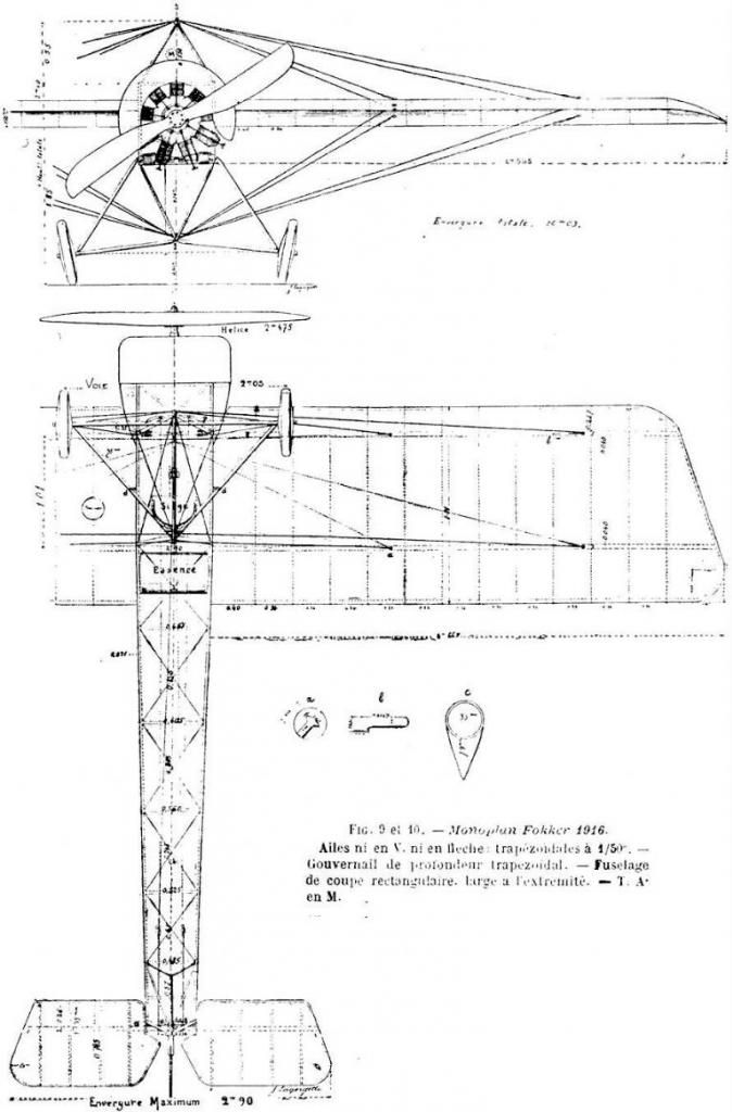

I spent eight years in the Navy, many of those at sea, and yes, port navigation light was red. But Scott indicates that on the Eindeckers, red is on the starboard side, green on port... Perhaps as the riggers were standing in front of the machine, red was on their left side. Or...? I believe his information came from the markings stenciled on the wingtips telling the riggers which color turnbuckles to attach.
I recall that when Achim Engels was building his E.III replicas, he also had identified the coloured turnbuckle assembly convention and yes, it was port green and starboard red. Not been in the RN (or any other navy...) but I've sailed for a number of years and of course it is the "wrong" way round (it struck me as odd at the time) but it is nonetheless apparently historically correct.
