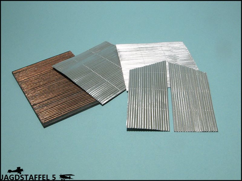

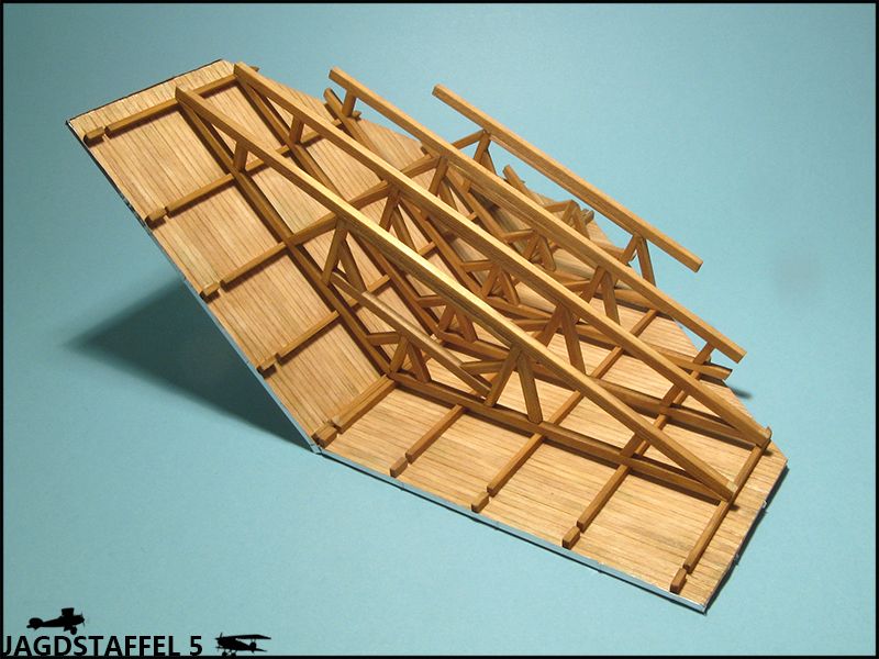

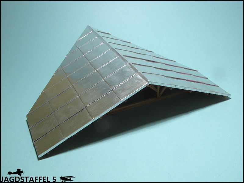

Work on the hangar continues.
I laid several layers of stain on the wooden roof structure and assembled farms with ribs and plating.
I laid on top sheeting using aluminum foil from food box.

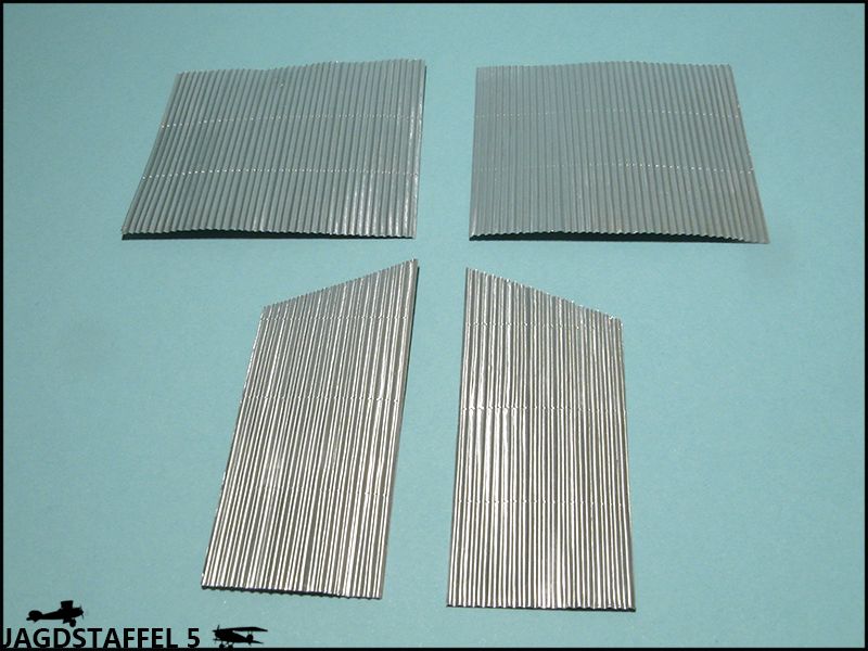

I'm made a matrix that will help me to attempted to emulate sheets of corrugated galvanized steel.
These sheets I will put on the facades of the hangar, as shown in one of the reference photographs above.
Aluminum foil, however, did not like galvanized steel, so I'll need to paint them.
I'll be glad of any tips on how to achieve this effect:

Offline Squiffy
  • Posts: 602
Re: Jagdstaffel 5 - july 1917 - Albatros D.V - 1:72
« Reply #106 on: May 29, 2015, 11:47:11 PM »
That is lovely work on the corrugated cladding. How did you make it?
Quote
Galvanising is bright and silvery when new but it soon dulls to a metallic grey colour. Perhaps a mixture of light grey and aluminium?

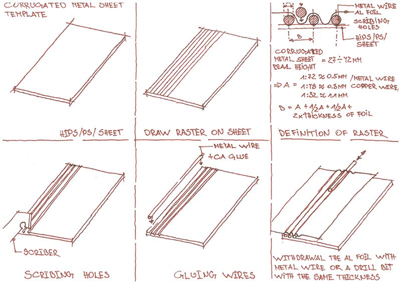

Very nice work on the hanger roof. It looks like you've used tooth-picks for the corrugated metal sheet template, haven't you?

« Reply #111 on: June 01, 2015, 10:07:30 PM »
Hello everyone!
I'm glad you liked my work on the hangar.
As for the tool with which I worked corrugated sheets is very simple, and because I have not photographed exactly how I did it, I decided to draw the process:
Best Regards
Hristo

Hi Frame, Here's a corrugated iron roof I did the same way as you.I've painted it with several shades of grey and red .If you want to depict a factory fresh roof you might just leave out the rust and dry brush with gunmetal and aluminium instead.

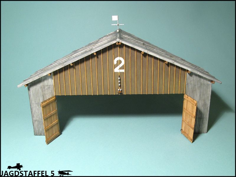

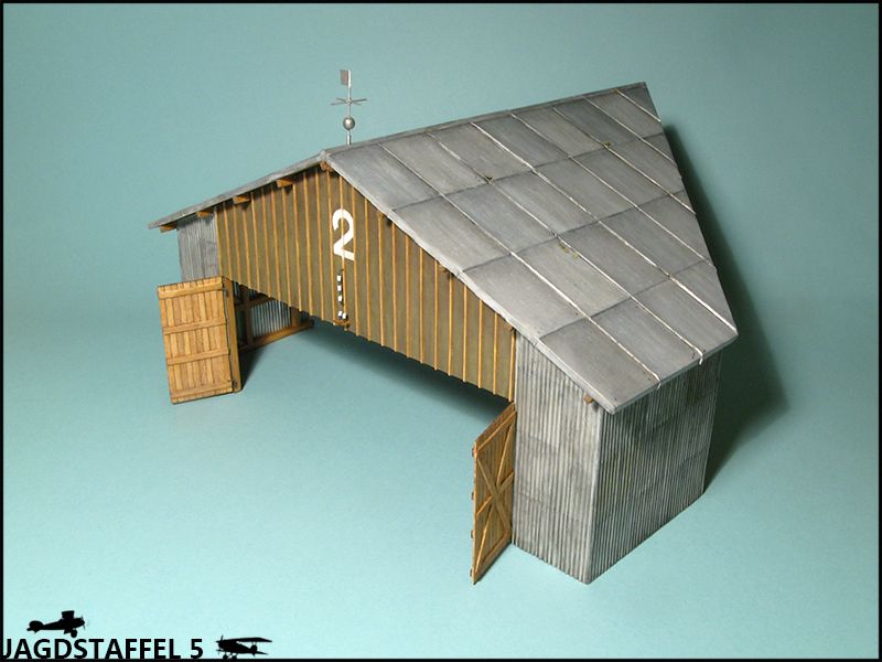

« Reply #113 on: July 31, 2015, 07:26:28 PM »

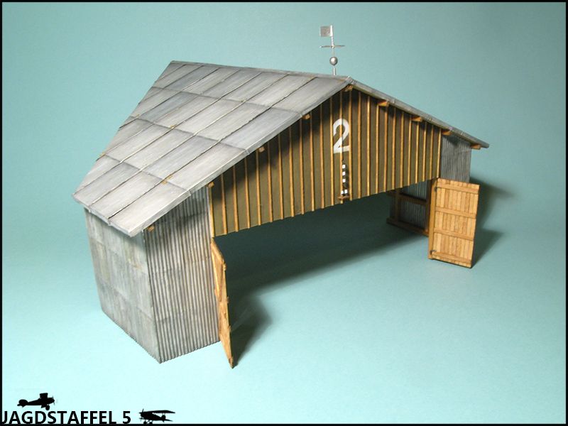

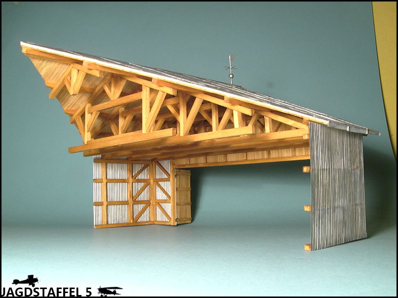

Hello everyone!
I finished work on my hangar. For coloring а sheet metal I use a couple of washes mix with oil and acrylic paints. I'm not apply primer on the aluminum foil, which was stupid, and therefore places the paint is washed away at work, leading to repeatedly clean and start again. For gable tried to imitate coated fabric, with the help of wrapping paper of shoes box, glued on planking inside. Then painting and tinting with dry pastel. The number of hangar is made by handbrush. Doors them mounted on hinges of some fishing hose, and for my great surprise can be opened and closed.
Well that's it for now. I started working on the ground, and then resume work on airplanes.
Best Regards
Hristo

« Reply #118 on: August 02, 2015, 08:15:44 AM »
Really impressive. A masterpiece of a hanger! Maybe the roof would need a little more rust?
Offline frame
  • Posts: 60
« Reply #119 on: August 03, 2015, 04:40:09 PM »
Thanks for the kind words about my work, guys.
Vincentm you're right, it looks a bit sterile hangar, but I was afraid at this stage to keep it tо weathering it.
Forbad me fact that the hangar was built in the same year, and I think there is no way to look very old.
Will try to weathering more when diorama acquire slightly more finished look.
