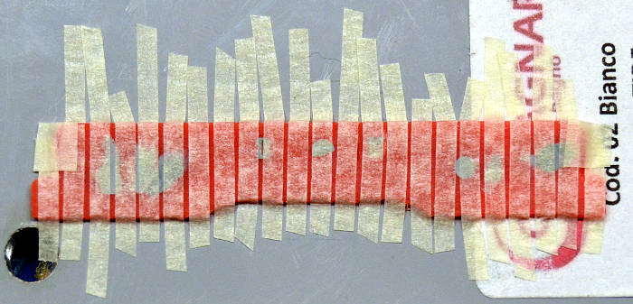

As I said, the undersurfaces of the wings had no ribs traces so I masked the wings and painted two thick coats of Mr Surfacer.
here is the result, the large stains are due to use of the same coating to fill in the extractor marks and the traces of the parts that were abducted.

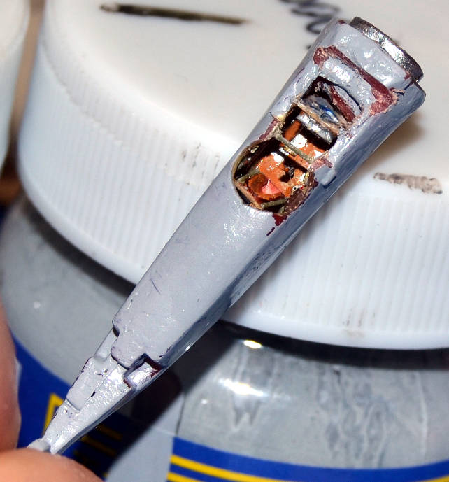

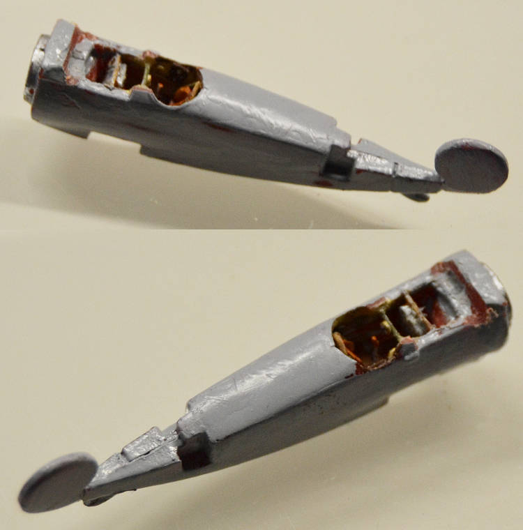

This is the fuselage closed and primer-ed with Mr Surfacer.
I did not bother filling the join line on the tail because it will be covered by the tail plane.
A glimpse of the cockpit, I know it seems a sort of fruit salad where the single pieces are hardly perceived.
I hope you'll be able to see the parts...

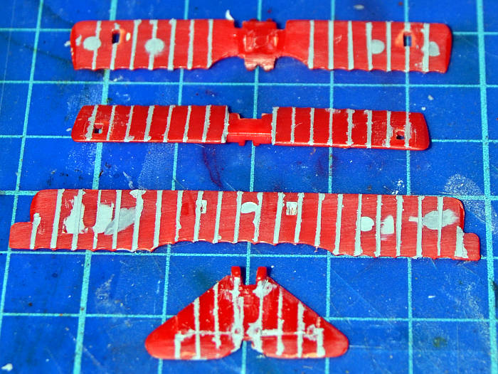

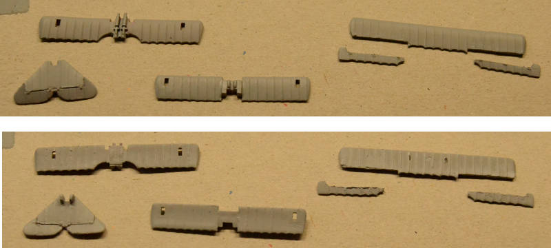

Tamiya gray primer sprayed all over the wings and tail planes

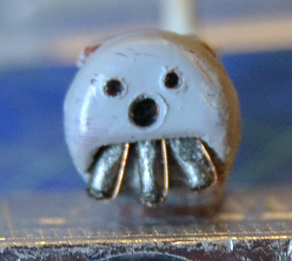

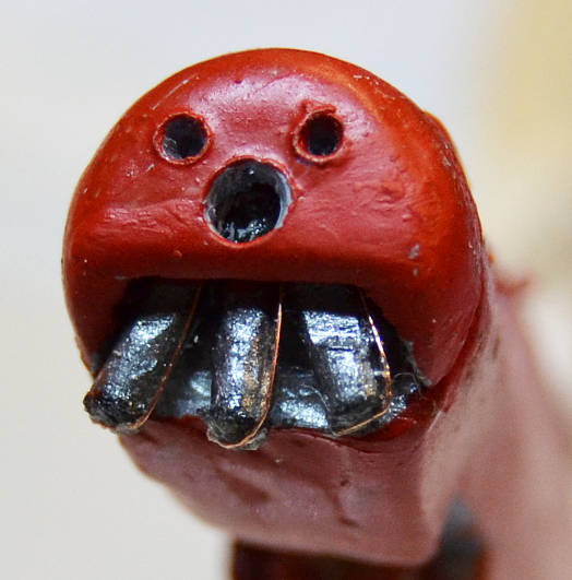

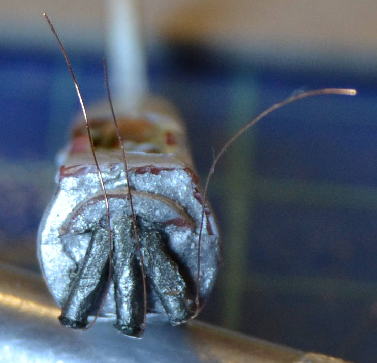

The original cowling had the cylinders moulded on it, so I decided to make 3 cylinders from a styrene rod 1,3 mm diameter and stuck some copper wires to simulaste the tubes
here is the cowling at tis place

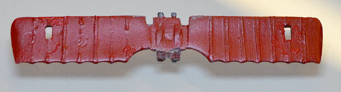

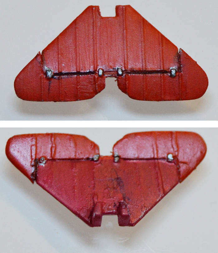

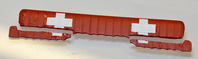

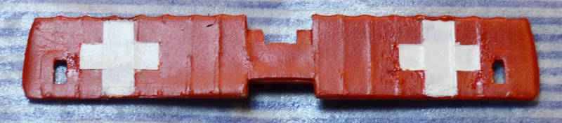

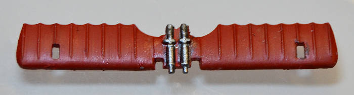

The wings were painted with acrylic bright red diluted enough to let the gray peep through, so it became a dark red which I personally like very much.
Middle wing with MGs
Tail planes
Bottom wing (lower surface) with the white field to paint the crosses
Top wing (upper surface) + ailerons

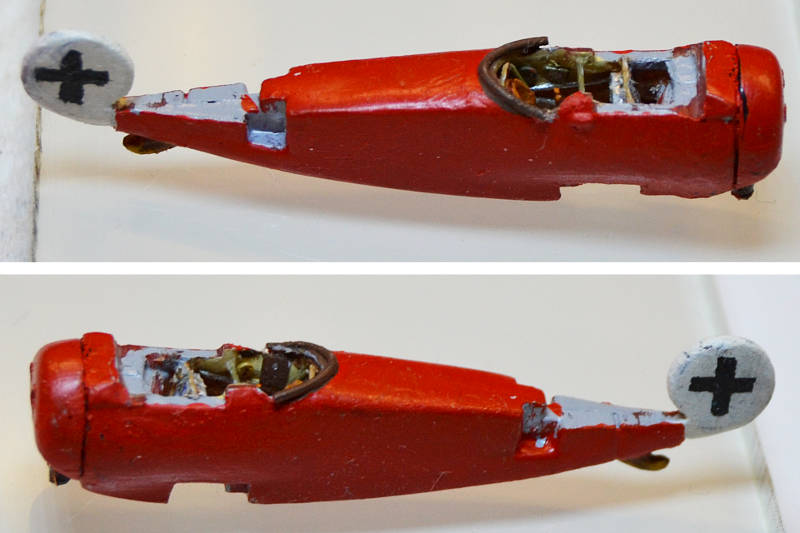

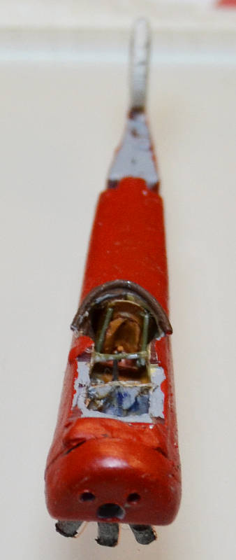

The fuselage has been painted as well, but not yet started the work with the crosses:
My program is to finish the black crosses and hopefully the fuelage crosses by tomorrow evening...

Someone pointed out that the cylinders are too long and wouldn't have enough room rotate in the cowling... ok it's right! I will see if I can shorten them withou spoiling the cowling

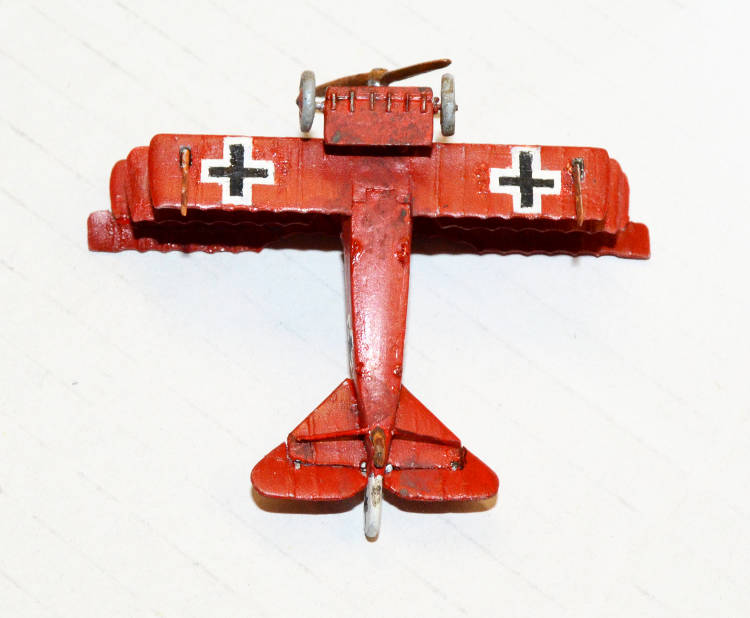

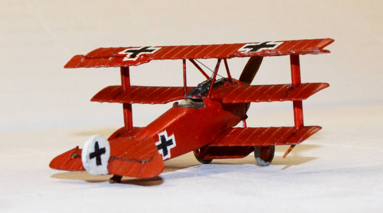

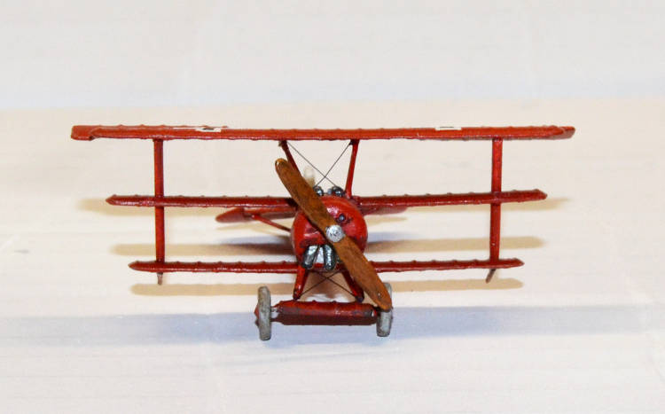

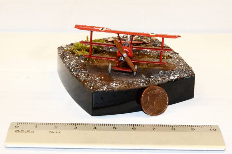

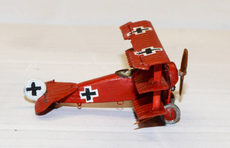

Here we are: I finished my DrI and I am pretty happy with it.
Here it is: a few shots on a white BG to better show some details:
rigging (fishing line 0,1 mm), wing struts, cabane and undercarriage struts, sticks beneatu the lower wing are scratch built...
here you see the cockpit access step self made with a electric wire
Undercarriage structure was self made as the tail planes struts. Crosses are self painted as you know.

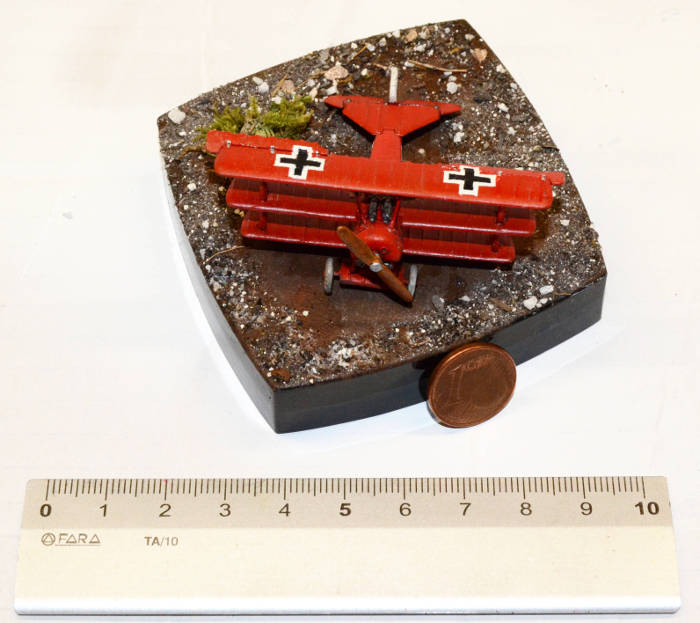

Here below are a couple of pics with the usual cent coin...
I prepared a base using the lid of a cream my wife uses for her pretty face :-D
More in the Completed models section...
Thanks for looking!

Simply amazing, Antonio, and really beautiful!  Just the fact that the control surfaces are deflected in this scale is mind boggling.
Brilliant!

Sorry that I missed the end of this one - a truly inspiring effort! I thought that 1/72 was small enough but you have shown that even smaller scales can produce stunning work. Many congratulations.
