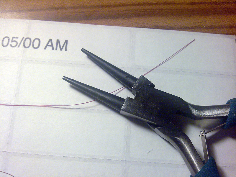

« Reply #10 on: December 07, 2013, 07:12:56 PM »
Dave,
 Running fishing line (Maxima 2lb breaking strain) line through round nosed pliers gives you a nice streamlined look. Patience and care will be required when installing, avoiding twist at all cost!  ;)
I hope this helps.
Von Streamlined

Re: Barker's Snipe -rigging wires what size?
« Reply #11 on: December 07, 2013, 07:17:28 PM »
Great idea Bob,
-thanks very much.
 I will try that and report back!
