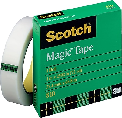

Here's another possibility: as pointed out, one of the problems with masking the individual panels is the inevitable build up of paint against the making tape. While it won't completely solve this problem, using super thin tape will go along way in reducing the build up.
3M makes adhesive tape that comes in a green box and is called Magic Tape. It's been around for years but will really help reduce the paint build up at the seams.
http://www.staples-3p.com/s7/is/image/Staples/s0099112_sc7?$splssku$
