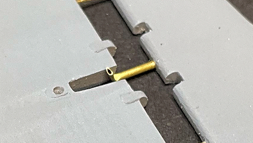

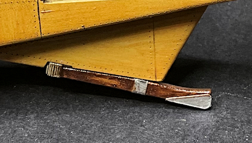

Hi all,
Just a couple of updates.
The tail skid is fitted.
Also, 0.8 mm diameter Brass tube was bent to represent the aileron operating levers, which are not supplied in the kit.
Now its onto painting the flight surfaces,
