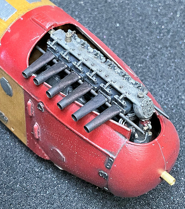

Hi all,
The kit supplied engine exhaust pipes are flattened along their entire length.
However, most photographs of the aircraft show the exhaust pipes at the engine end being flattened, but then changing to tubular shape at their outer ends.
The replacement exhaust pipes were made as follows:
File or sand away the locating stub on the engine side of the exhaust pipe flanges.
Carefully cut away the exhaust pipes close to the flange.
Using thin CA adhesive, secure each flange centrally onto the exhaust outlets of the engine cylinders.
Cut a 10 mm length of 2.0 mm diameter Brass tube, such as ?Albion Alloy?s? (MBT20) or similar.
Using flat pliers, carefully flatten one end of the tube and reduce the flattening outboard to approximately half way along.
The bore of the flattened end should be approximately 0.5 mm wide.
Cut a length of 0.5 mm diameter Brass rod, such as that from ?Albion Alloy?s? or similar.
Insert the rod centrally into the flattened end of the tube, leaving approximately 4 mm protruding.
Secure the rod in the tube using either thicker, slow setting CA adhesive or soft solder the rod in the tube.
Drill a hole of 0.5 mm diameter centrally into an exhaust flange.
Test fit the exhaust pipe into the engine, making sure it?s 90 degrees to the engine when viewed from above and from the front.
Repeat the procedure to create the remaining five exhaust pipes.
No photograph I've ever seen shows these flattened exhaust pipes, I've no idea where LukGraph got the idea for these from. It was pointed out to them during the development of the kit but for some reason they ignored the input (like several other suggestions to make this model more accurate). Oh well, you've done a great job correcting this and explained how to do it.
I'm so glad you built this kit before I did..... :)

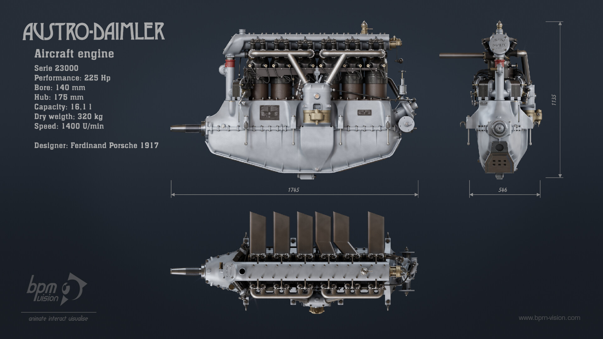

Hi Nigel,
Probably this render.
Not known for taking suggestions.
I pointed out the resin cast BE2c front end looked more like the RE8.
Ignored, so I modified the kit,

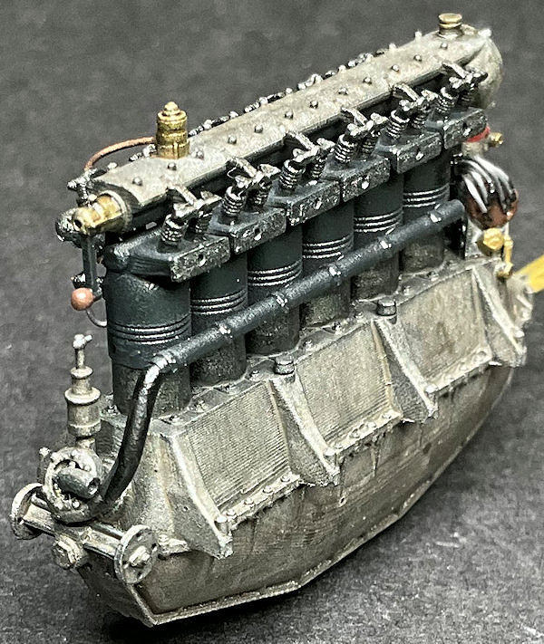

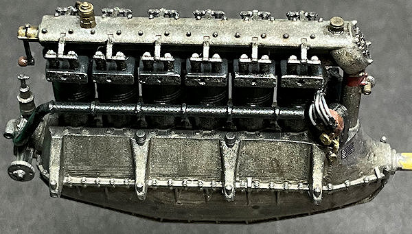

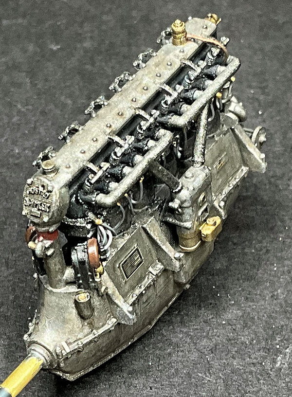

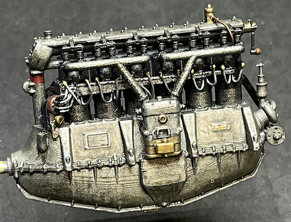

Hi all,
Engine finished.
Always tricky painting a fully detailed 3D printed engine.
The paints used were Tamiya, Mr. Metal Color, MRP and Alclad.
The only mods to the engine were the twelve ignition leads and the pipe from the valve at the rear of the camshaft cover.
I also drilled out the propeller shaft locating hole to 2.0 mm and fitted a Brass tube.
The shaft of the kit supplied propeller was smaller in diameter, so a sloppy fit.
The propeller was drilled out to.
Next up is fitting the engine into the fuselage then the nose cowl,

Nice work on the engine. Quite a lot of build lines evident (although they won't really be seen). I think the quality of the 3D printing seems to have improved further since this kit....

Hi all,
Engine fitted including the replacement exhaust pipes and nose cowl.
Machine gun blast tubes replaced with blackened 0.8 mm diameter Brass tube.
