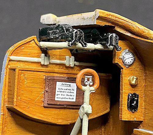

Hi all,
While I'm waiting for the MDesign AW FK.3 kit to arrive, I'm working on another model.
It's the older resin cast Oef D.III (Albatros) from Lukgraph (not the later 3D printed kit).
The aircraft is D.III (Oef), Series 253.12 as flown by Oberleutenant in der Reserve Ludwig Hautzmayer, Commanding Officer of Flik 61/J, operating from Ghirano, Italy, during the the
Summer of 1918.

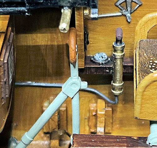

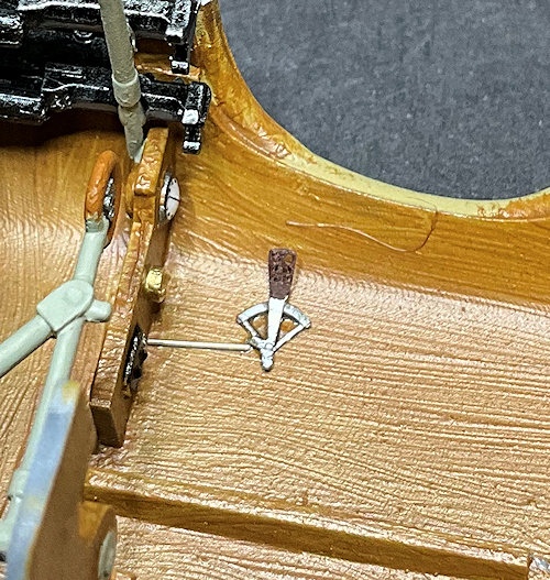

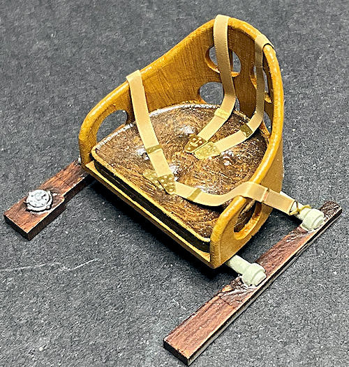

Some details of the cockpit needed modifying to better reflect a Series 253 series aircraft.
The pilot's instrument panel was not a single span panel, but two separate panels (left and right).
The rear of the two machine guns were mounted on a cockpit cross bar.
Also, the pilot's seat was not normally solid wood, but had several large lightening holes
Therefore, I've cut the instrument panel into two panels, added a Brass rod/tube cockpit cross bar for the machine guns.
Also added lightening holes in the pilot's seat.
I've removed the cast hatch panels and cooling louvres from the fuselage.
Kit photo-etch alternative panels fitted with 'Proper Plane' replacement cooling louvres.
Support rods added to flight control surfaces etc,

It's one of the few 1/32 kits I own (in the alternative Polish boxing) I did wonder about the cockpit and briefly considered just lobbing a pilot in to fill the space and distract from the errors, but think your way is a better option so following along with interest

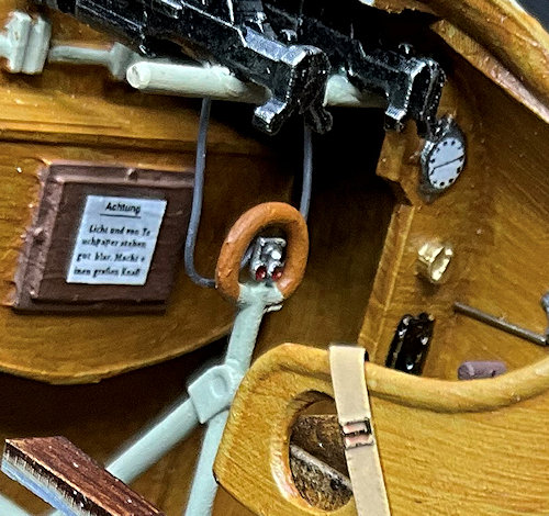

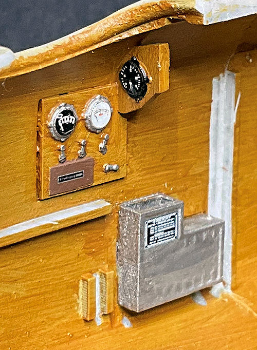

« Reply #6 on: July 02, 2026, 07:03:00 AM »

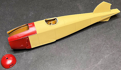

Hi all,
Some progress on the Albatros.
This is the original resin cast model from Lukgraph.
I've modified as much as I could to make the cockpit a series 253 version (kit is I think a series 153 version cockpit).
The fuselage is painted ready for applying external wood effect.
I've also removed most of the flight surface rib tapes.
As Nigel points out, these aircraft had the linen covering stitched directly to the wings, so no rib tapes as such,

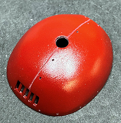

Hi all,
The nose cowl required three modifications.
When offered up to the joined fuselage halves, the outer edges of the nose cowl overlapped the edges of the fuselage.
Therefore, those edges were sanded until they aligned to the fuselage edges.
The joint seam down the centre of the nose cowl is printed as raised, when it was a shallow joint with fasteners (thanks Bertl for the heads up).
The vertical seam/joint running down the centre of the nose cowl was sanded away.
The joint line was scribed into the cowl.
The five cooling slots at the bottom, centre of the nose cowl were printed as raised ridges, not as slots.
A rectangle was cut out of the nose cowl to remove the five raised cooling 'slots.
A strip of masking tape was applied to the inside of the nose cowl to cover the opening.
Thin strips of plastic rod were cut to length then located into the opening and held in position on the masking tape.
The strips were then secured in position using thin CA adhesive.
The masking tape strip was removed and the nose cowl painted,

« Reply #11 on: July 13, 2026, 03:15:32 AM »
Thanks for that Mike, really helpful! I think I can manage those cooling slots now.

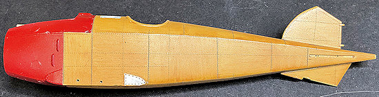

Hi all,
I've applied light plywood effect by brushing Windsor & Newton Griffin Alkyd (Raw Sienna) oil paint over the fuselage, fin and tail skid.
Once fully dry, used a 1.0 mm Rosie Riveter to represent the panel nail lines.
I then brushed Flory Models dark dirt wash wash along the nail lines then wiped off the excess.
Finally sealed the finish with Tamiya Semi-Gloss (X35) clear coat.
Now it's onto adding the fuselage photo-etch parts,

« Reply #13 on: Today at 07:13:25 AM »
The nail heads - how well does that work with this resin material using the riveter, Mike?

« Reply #14 on: Today at 08:52:39 AM »
Servus
Bertl
Hi Bertl,
OK really.
Just have to be careful you don't apply too much pressure as the cast resin is quiet soft compared to plastic.
Other than that, no problem,
