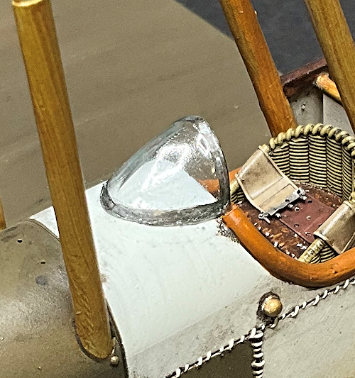

Hi all,

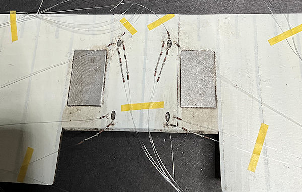

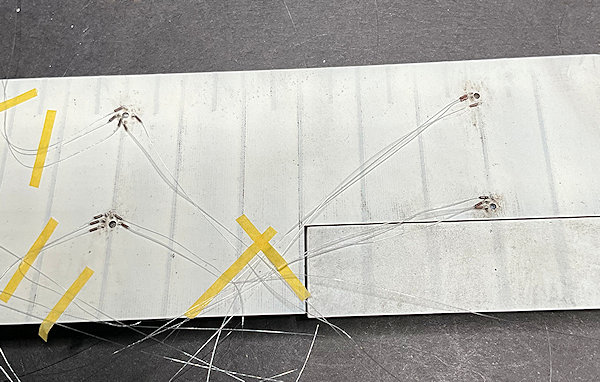

The vac-formed windscreen has been fitted.
Also, the underside of the upper wing pre-rigged.
Now onto the rest of the pre-rigging,

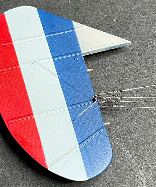

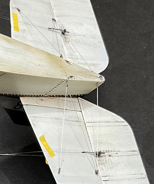

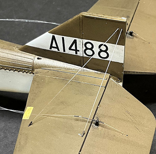

Hi all,

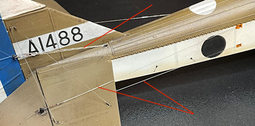

The rudder, elevators and fin bracing has all been rigged.
Gaspatch Type A and C turnbuckles with 0.08 and 0.12 mm mono-filament and 0.4 and 0.5 blacked tubes.
The tail skid and landing gear have also been fitted.
Next is to fit the upper wing,

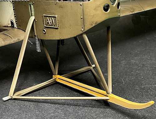

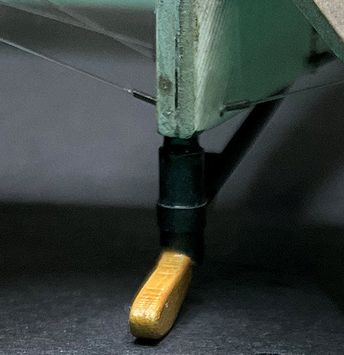

Hi all,
The landing gear and the tail skid have been fitted, prior to fitting the upper wing,

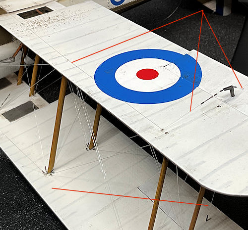

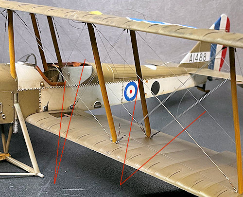

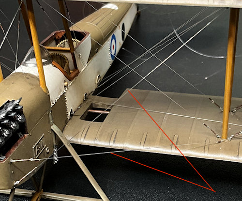

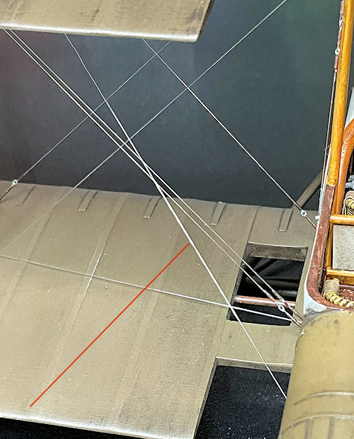

Hi all,

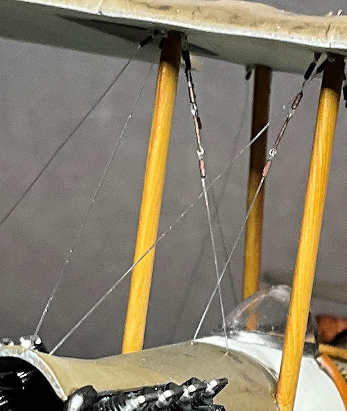

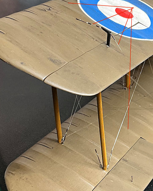

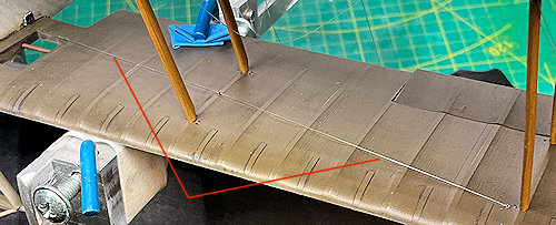

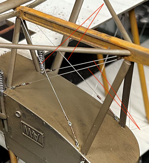

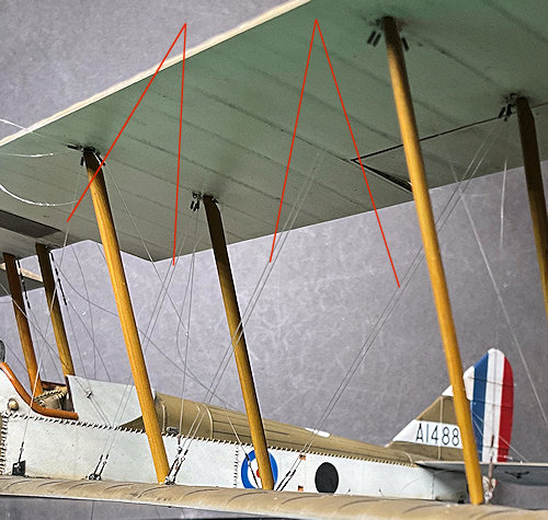

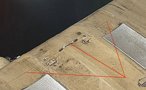

All rigging now completed.

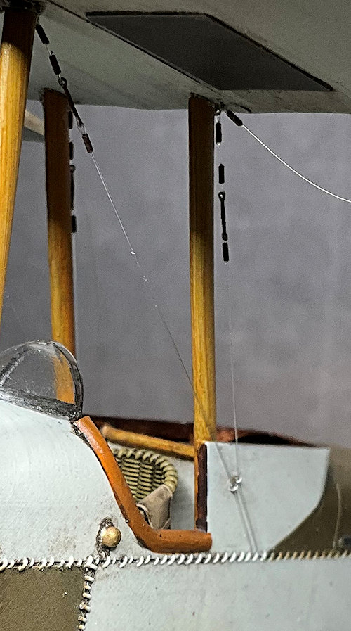

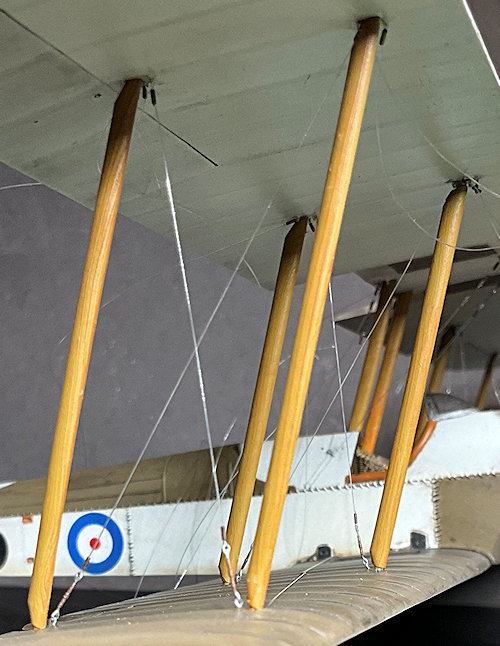

The shots below show the rigging during fitting.
Twin and single flying wires.
Single landing wires.
Interplane incidence wires.
Drag wires.
Anti-drag wires.
Cabane strut bracing wires.
Landing gear bracing wires.
Aileron control cables (upper and lower wings).
Fin bracing wires.
Twin rudder control cables.
Elevator control cables.
Left to fit are the engine exhaust pipes, landing gear wheels, propeller and wing hoops.
Two more modifications to add that the kit does not supply are the pitot-static pipes and fuel tank filler cap.
Then it's just the display case and of course figures,
