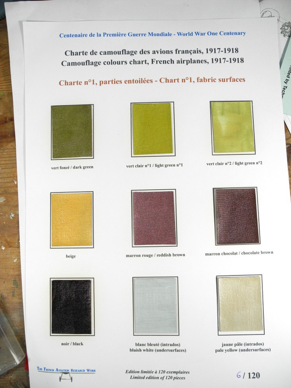

hi, if you are interested  here youi have colors proposition in Gunze:
there are based i Marc Chassard work who realise with pigments the Toelle's betterfly project colors compostion:

Thank you very much to all of you.
But special thanks to xan for the color sheets. They're quite interesting. Even the first color for "undersurfaces" does not match with the color suggested by WnW. WnW suggests Tamiya XF57/buff, which is already darker than XF55/deck tan. Your color table even suggests to brighten up XF55 with XF2/white in relation 1:1. However, it seems to fit much better to the Pheon suggestions.
I really would like to give that color suggestions a chance. Func fact: I have no experience with Gunze colors, how to delute them etc.
And the sheet even demands for a mixture from Gunze and Tamiya (light green no.1). That looks like some serious spray testing.  ;D

By the way, Gunze paints can be easily thinned with Mr. Color Leveling Thinner (probably available from your local dealer), which also works with Tamiya XF paints, and you can also mix Gunze with Tamiya paints using Levelling Thinner.
Greetings
Joerg
Re: WnW 1/32 Salmson 2-A2 "USAS"
« Reply #40 on: March 05, 2025, 03:49:24 AM »
Fantastic job on this very busy interior.
I can only repeat what Joerg said. Also, mixing Gunze and Tamiya colors is no problem. Both are alcohol based acrylics (vs. the <<real>>, water diluted acrylics from e. g. Vallejo) and so they can be diluted with isopropanol, too.

Beautiful work xan, thanks for sharing the colouring sxhemas!
Are they part of a more complete work? And in case is that work available for purchase somewhere?
