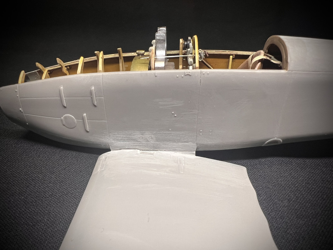

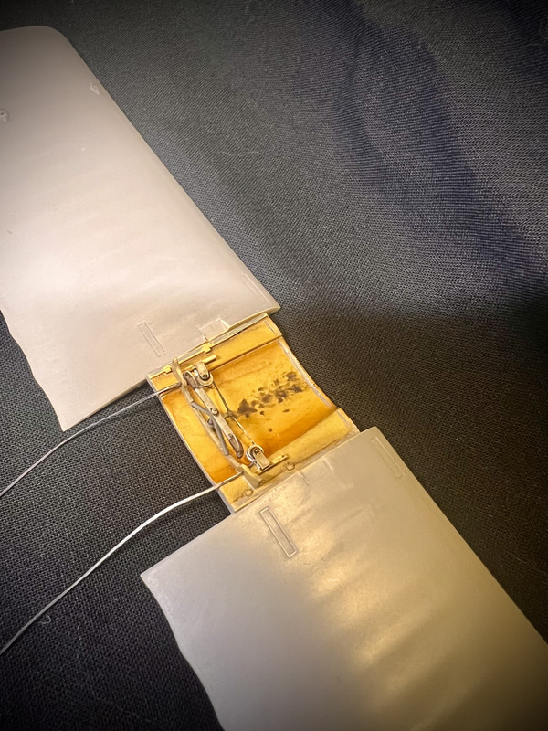

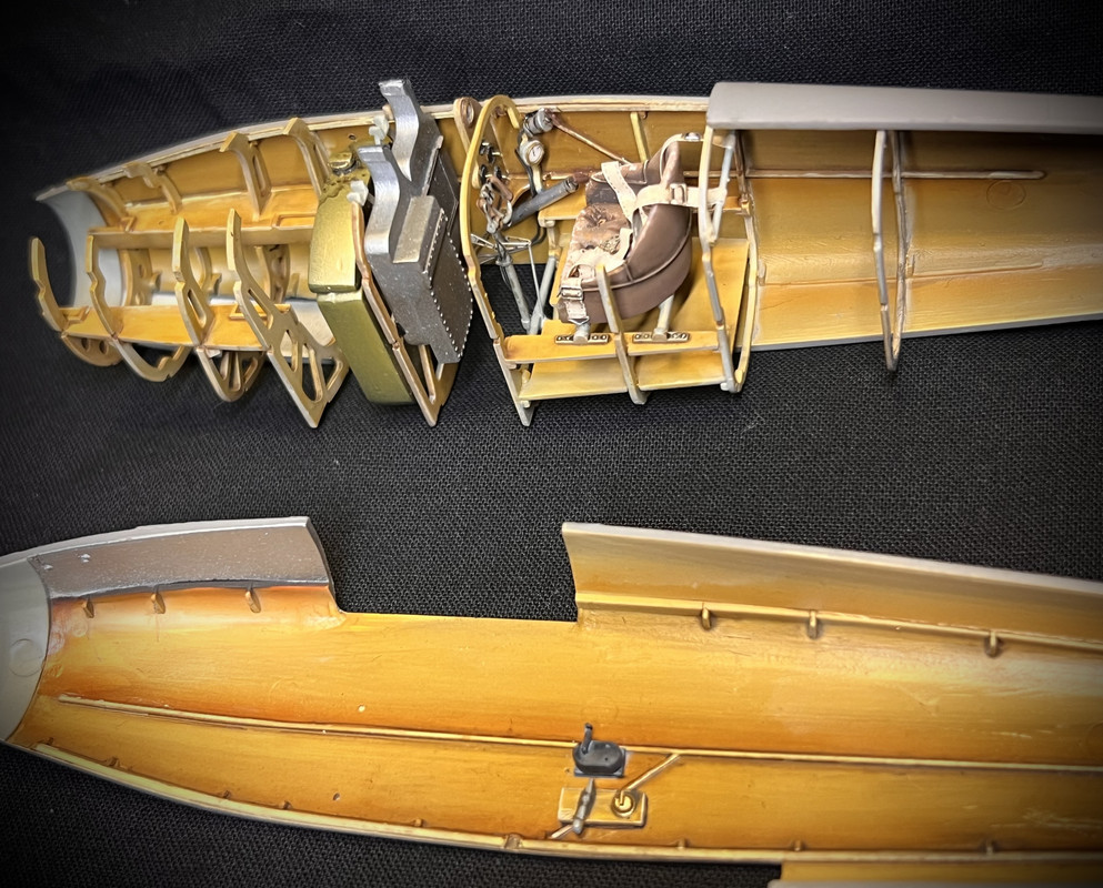

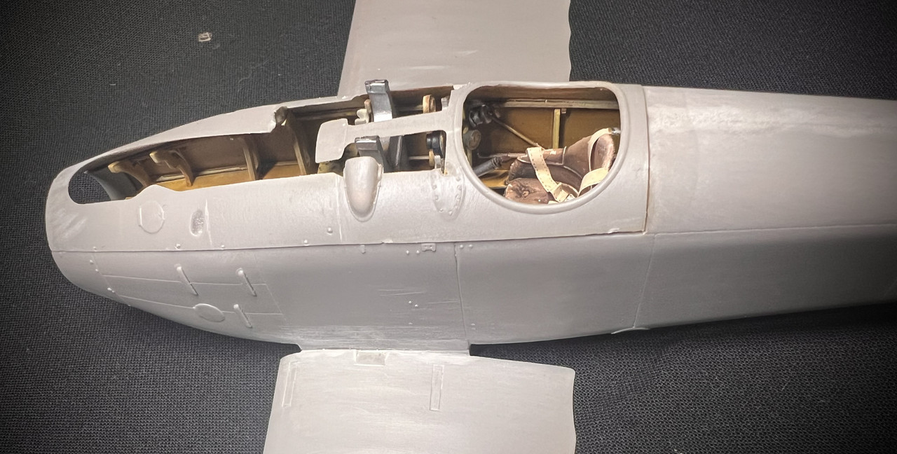

I finally got the fuselage halves closed and added the lower wings which are connected by a small part of the underside of the fuselage; an usual approach that keeps the wing dihedral and gives sturdiness. I however acted so stupidly this time adding the lower wing that I almost surrendered. I cannot remember having such fit issues on my last Albatros from 2016 and I never read of such problems in any build report so I need to explain this only with my own clumsiness. It fit quite well in the end with much patience and some bad words.

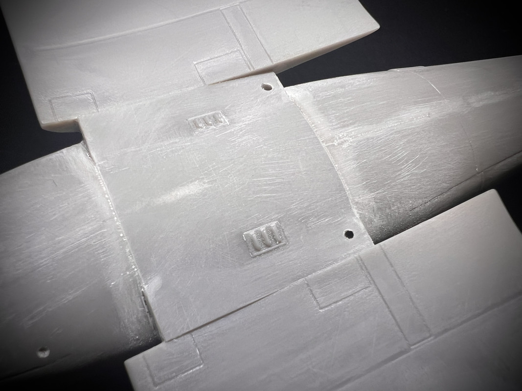

One needs to fill the two holes on the fuselage right over the wingroot. They are meant as anchor points for rigging wires, but they sit too high. These rigging wires need to enter the fuselage directly at the border between fuselage and wing where I sanded and scrapped a little recess.
I sanded away the inspection hatches to replace them later with PE parts. These sanding scars look terrible in the photos. They are way less prominent in real life ? promised.

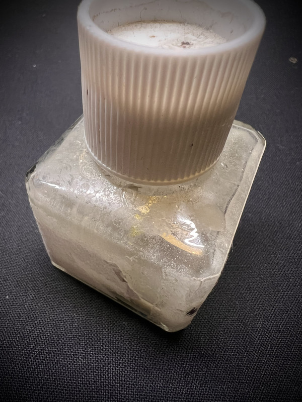

I spent an evening just slicing sprue bits into tiny flakes and putting them into an almost empty bottle of Tamiya glue.
Letting this react overnight one gets some great filler that I prefer over all these custom putties when it comes to putty fuselage gaps.

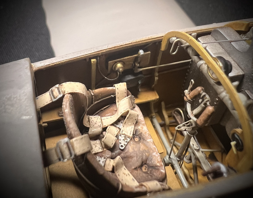

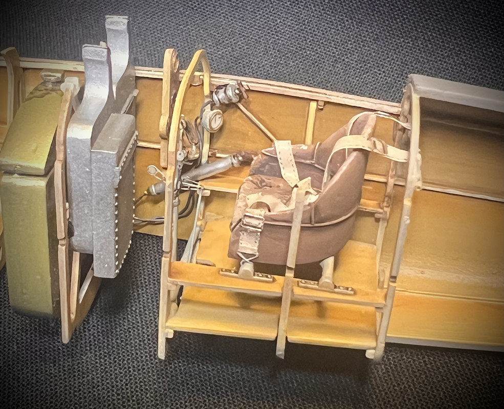

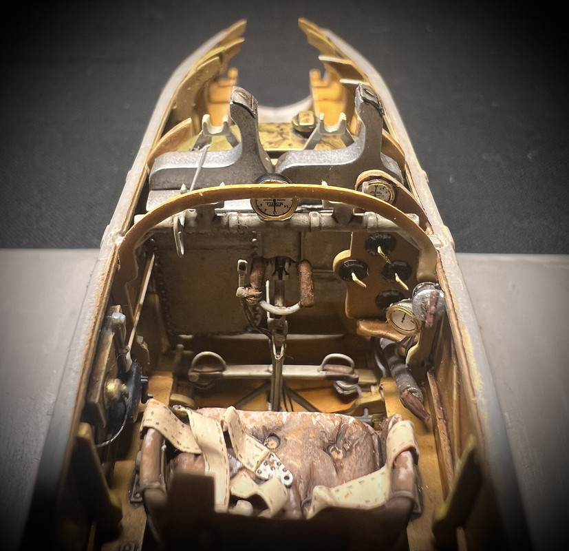

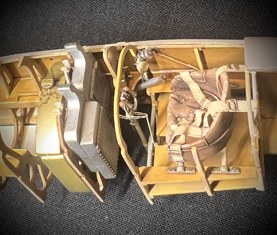

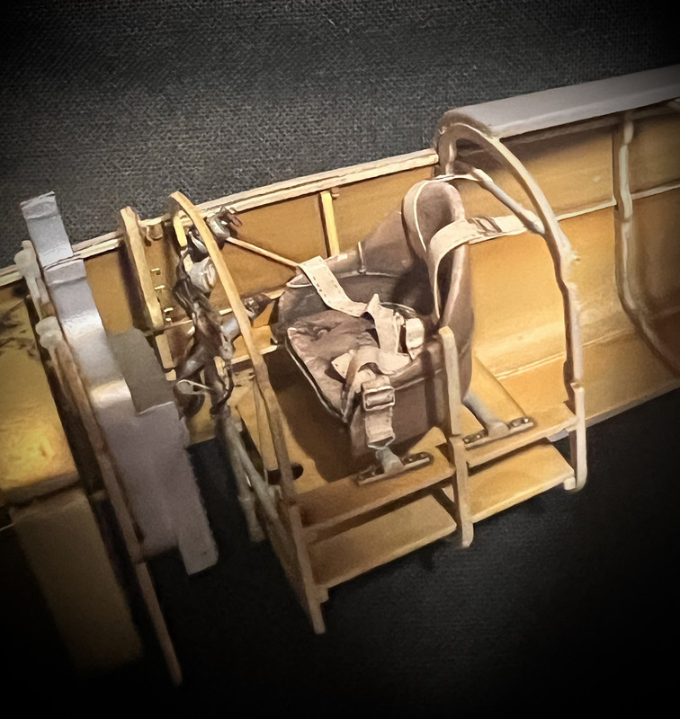

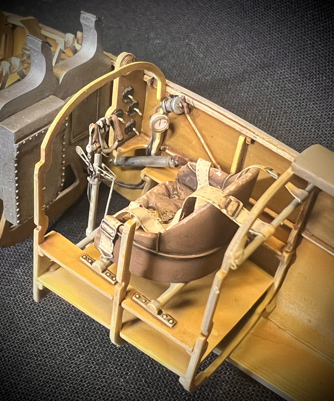

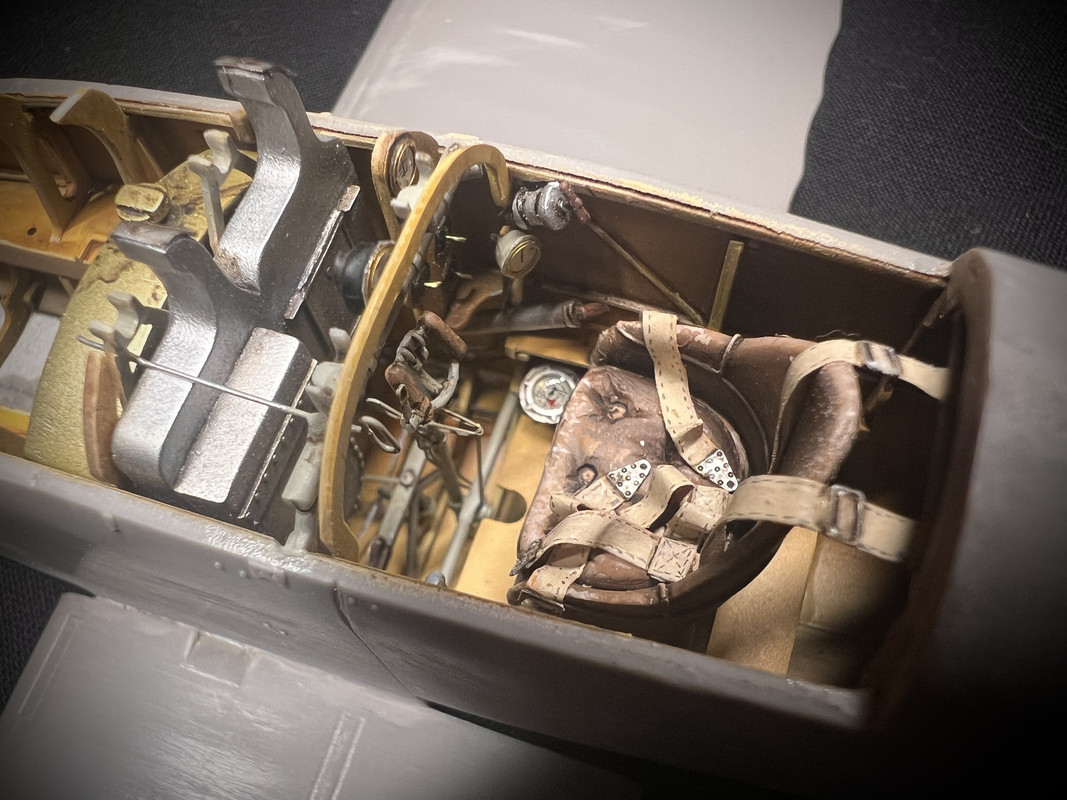

That is the almost finished working place of the pilot now. Some cables are still missing.

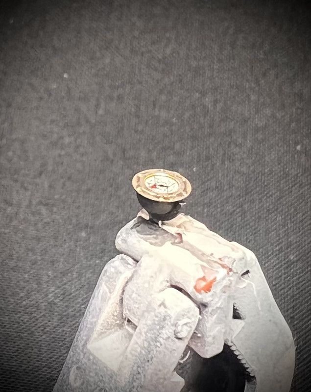

Last time I plundered a Roden Fokker Dr. 1 kit for the compass. I did not want to do this again, so I scratch build one with some plastic waste, a PE part from airscale and a spare decal from WNW.
I have seen many better compasses than that, as it is a little primitive and does not reflect the actual construction if this device, but that is not really visible once installed, so it is fine for me.
Compass installed:

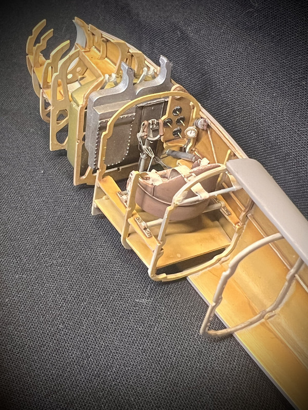

And with this last picture showing the upper decking of the fuselage dryfitted, I am calling the cockpit done.
