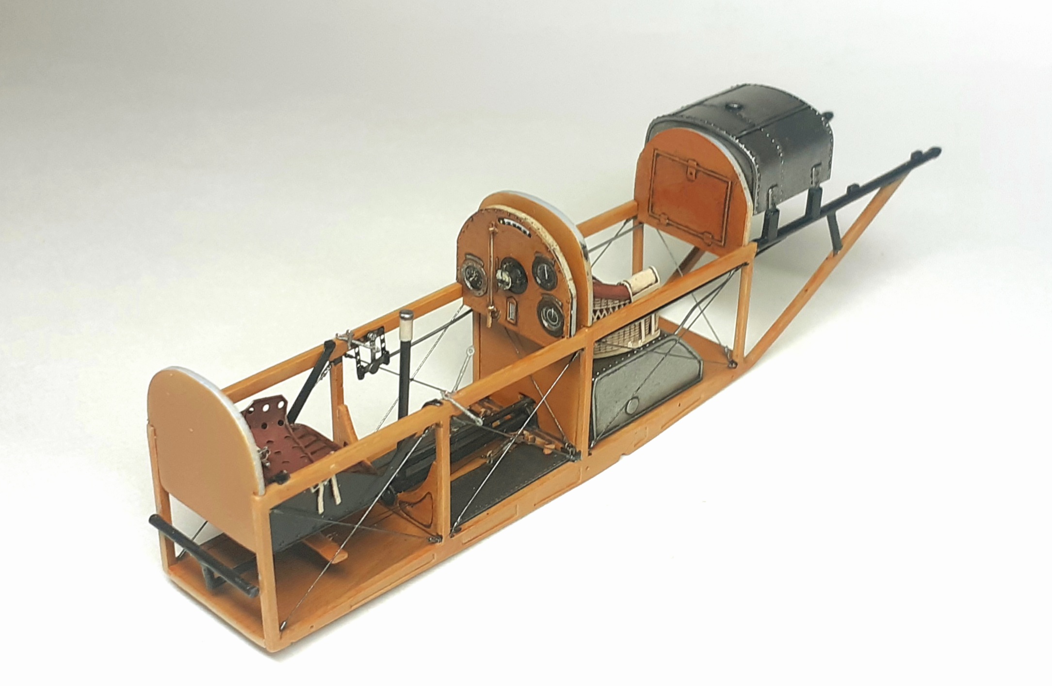

« Reply #22 on: November 20, 2024, 08:27:37 AM »
Todays progress on the interior. The instrument panel has the scratch built oil indicator pipe - made from a streched clear sprue and bits of self adhesive metal foil.

  • Posts: 5669
Re: RAF BE.2c (1/32, Lukgraph)
« Reply #23 on: November 22, 2024, 08:17:13 PM »
Assembly started. The seats and the main tank are not yet attached firmly.

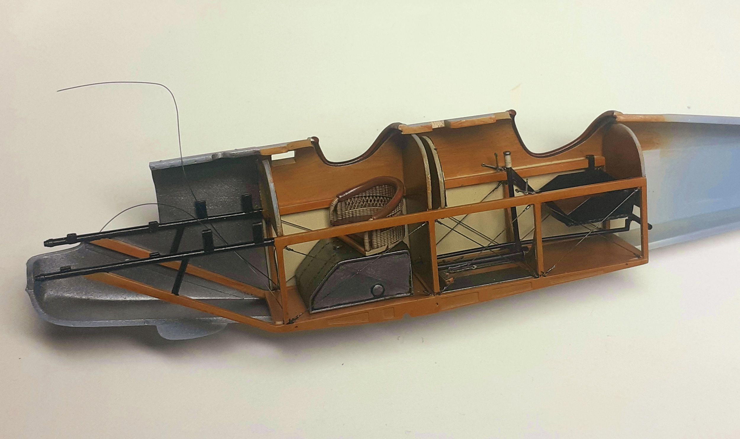

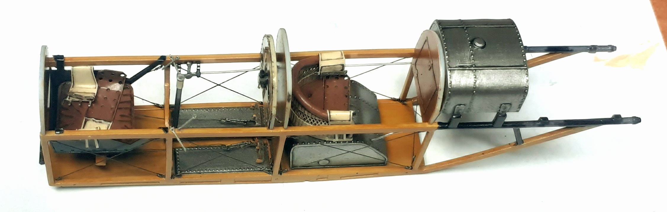

  • Posts: 5669
« Reply #24 on: November 23, 2024, 09:02:53 AM »
Interior is almost ready.

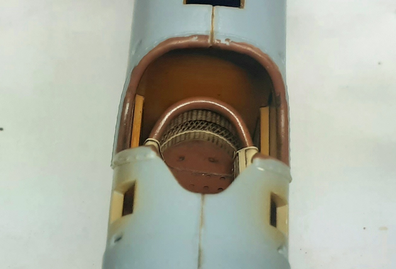

  • Posts: 5669
« Reply #26 on: November 24, 2024, 02:42:41 AM »
You are very kind, Edo.
Fuselage closed! Quite a lot is visible from the cockpits but not easy to take a decent photo.
