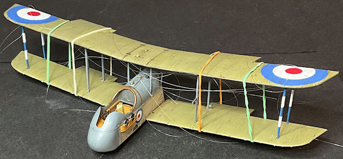

Hi all,
I've pre-rigged the upper wing, nacelle and landing gear.
Now the upper wing has been fitted.
Next is to finally rig the wings before assembly continues,

Hi all,
A slight faux pas with the interplane struts.
The rear outer struts are blue with a central white segment.
The front outer struts are blue with two white segments.
When I was test fitting the upper wing, it was going well so I decided to cement it onto the struts.
It was the following day I saw that I had the blue/white struts in the wrong positions.
The painted struts were fixed in position and the model already pre-rigged, so airbrushing the struts was not an option.
So I brush painted the struts blue then add the white segments using white 'Xtradecal' strips.
Lesson learnt  ::)
Oh dear, we've all been there! But you have saved this very well. Crack on!

Hi all,
The basic wing rigging is complete.
I've added:
Twin flying wires (x 16)
Single landing wires x 8
Interplane strut bracing wires (x 16)
Cabane strut bracing wires (x 4)
Still to add later:
Rudder, elevator and aileron control cables
Upper and lower drag/tail boom wires
Landing gear bracing wires
Now it's onto rigging the two tail booms before continuing with assembly,
