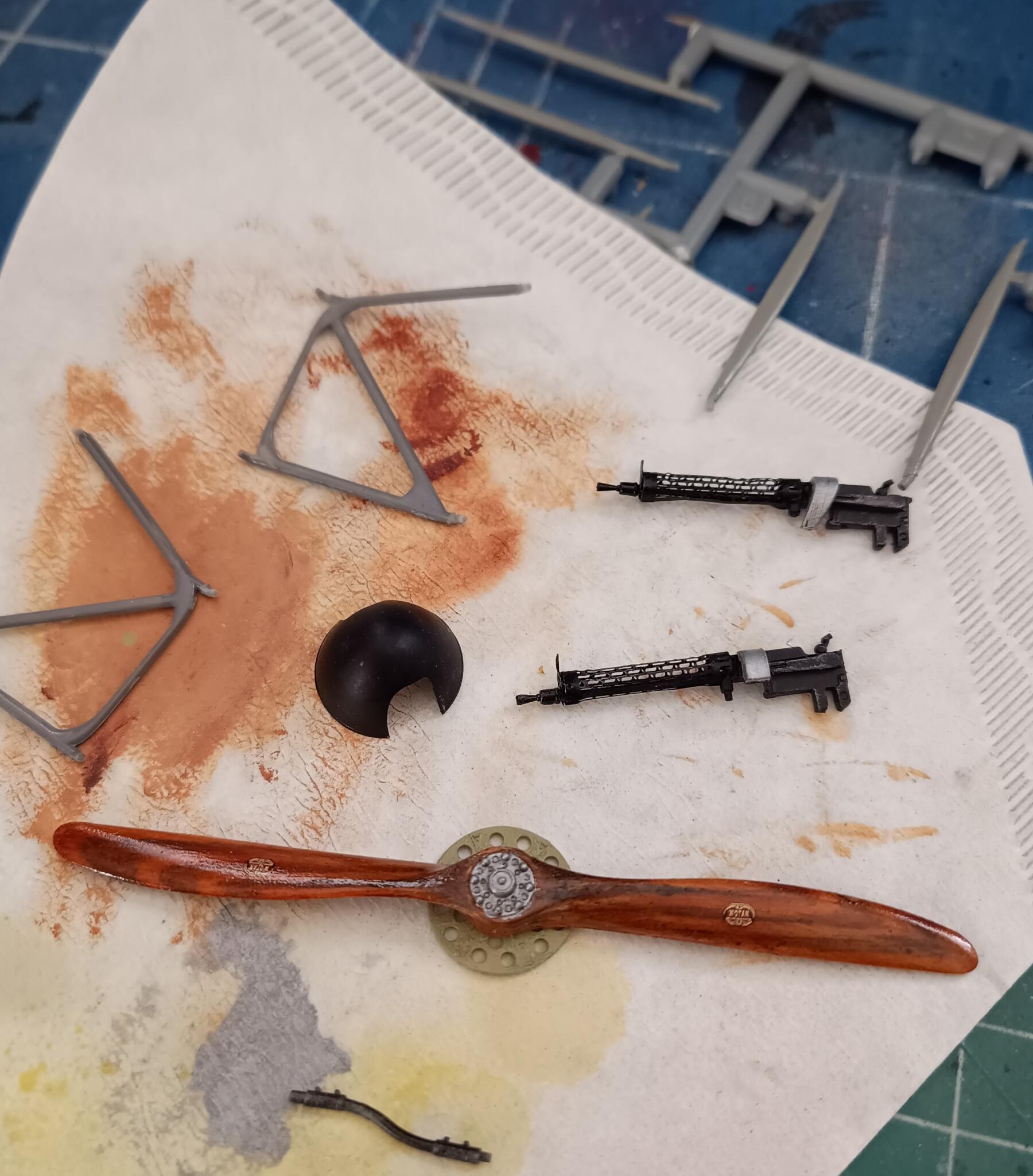

Thanks Rick
October looms, I'd better get a move on.

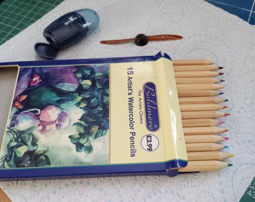

Some detail work, mostly propellor - watercolour pencil striations on a beige basecoat and varnished.
Onwards and upwards

That Prop is Gorgeous! One thing I feel I have never fully Mastered!!

Nice work Sandy, I too agree that the prop looks fantastic. I found watercolour pencils a bit too soft for this, so I moved to normal pencils. What brand of watercolour pencils did you use?

Thanks Rick
and Nigel - yes, at first I put Revell Aqua Beige silk matt then started to draw the laminates but as you say, the pencils were too soft and were just skidding over the paint, so I stripped, put Beige down again, then coated with (quite thick) W&N Galeria Matt varnish. After this the pencils worked fine, although I had to keep sharpening them to get a good edge to the layers. Then a light coat of Tamiya X22 Clear to seal it in, followed by a light brushing with Winton Burnt Sienna oils and then more Clear after drying.
Pencils are nothing special, just a box from 'The Works' - where I pick up a lot of cheap art supplies. Sadly their brushes are nowhere near as good as they used to be (but I bought stacks of the old ones!)

Thanks Sandy. I think the matt surface is the key, something that Bertl pointed out when he explained his approach.

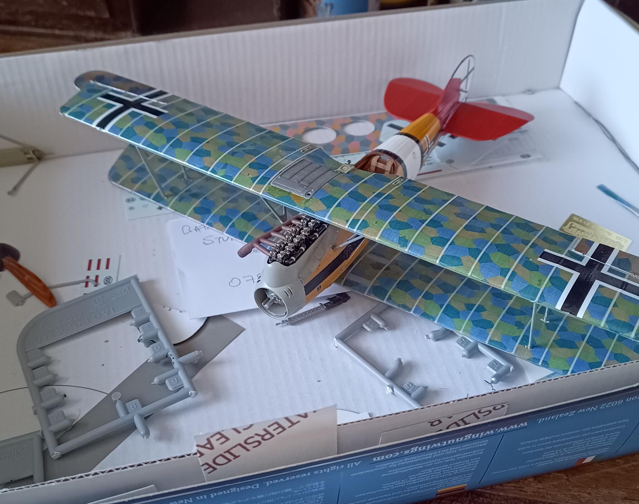

Funny how as you get towards the latter stages of a build, lots of little details that you forgot about earlier suddenly reassert their significance and need to be dealt with. Just when you want to get on with mounting the top wing.
Oh well, better to to get them done now rather than trying to drill holes, paint, etc once you cannot get access!
Getting there, though.

Yes, strange isn't it?! You have just gotten a feeling of speed and progress and then everything slows down again. Regardless of your current speed and progress, this is a very nice build!

Looking very good and definitely getting there. I know I should read the WNW instructions more thoroughly because I always find there's always a few things I have missed....

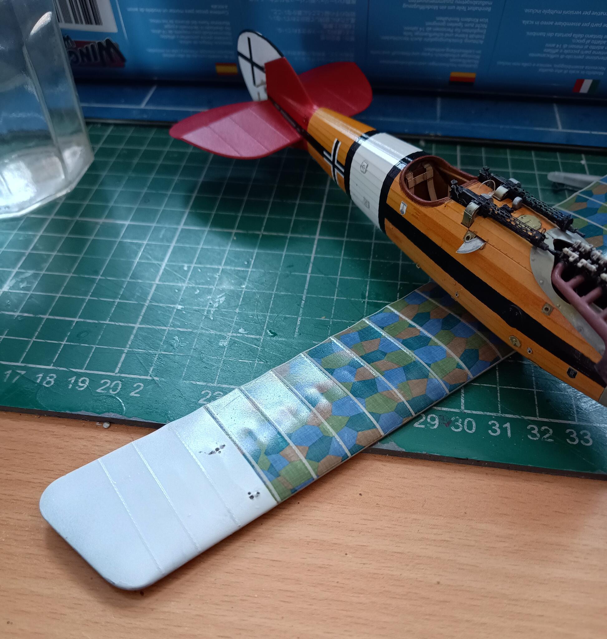

Much needed? well, yes - something happened which put this project in the 'at risk' category. 'At risk' because a stupid eye-off-the-ball miscalculation put the whole thing in jeopardy - fear not though, all is well now.
Getting excited as we approach the finishing line I opted to open out the wing holes prior to installing rigging lines. I usually use small drills or drill bits in a pin vice, but this time I thought I'd speed things up by using one of my favourite USB drills. Port lower wing - no problem, all cleared out. Starboard lower - I went too near the lozenge surface with the drill and must have touched the collet to the Aviattic decal. Suddenly a chunk of decal was caught in the drill and ripping off the wing. No oaths were issued - I was actually too shocked. I stared at the mess in disbelief.
As comprehension set in, I realised that I needed to fix this quickly or I maybe never would.

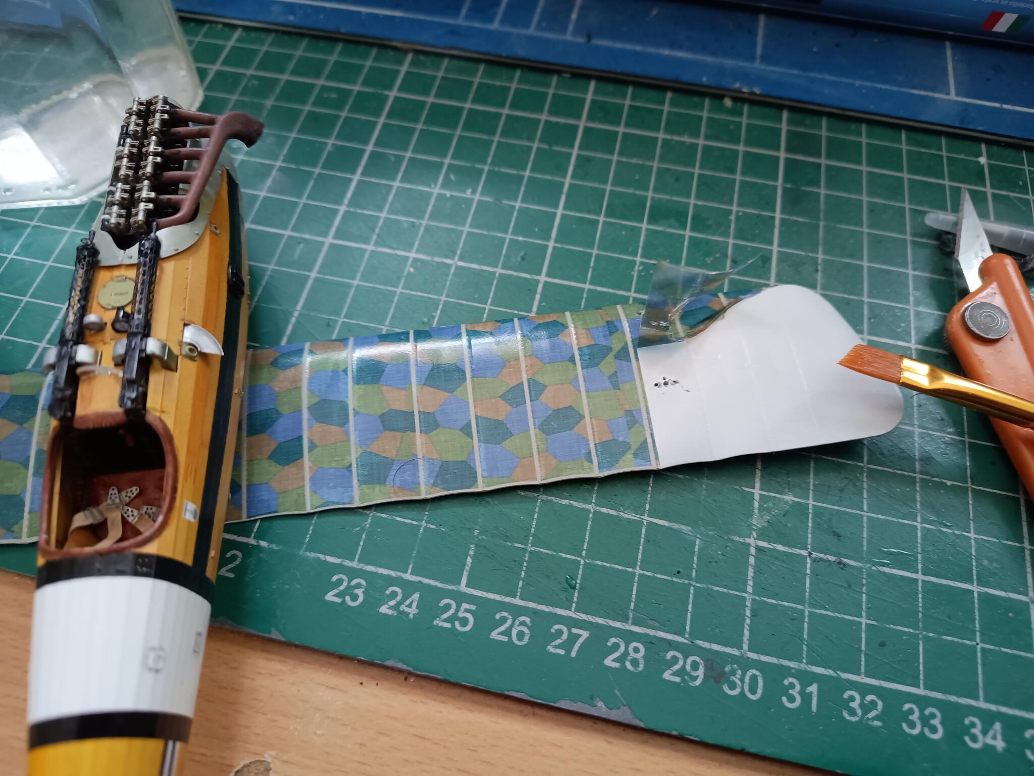

I sliced a straight line next to the nearest surviving rib tape and worked the torn decal off with a flat brush and lots of water.

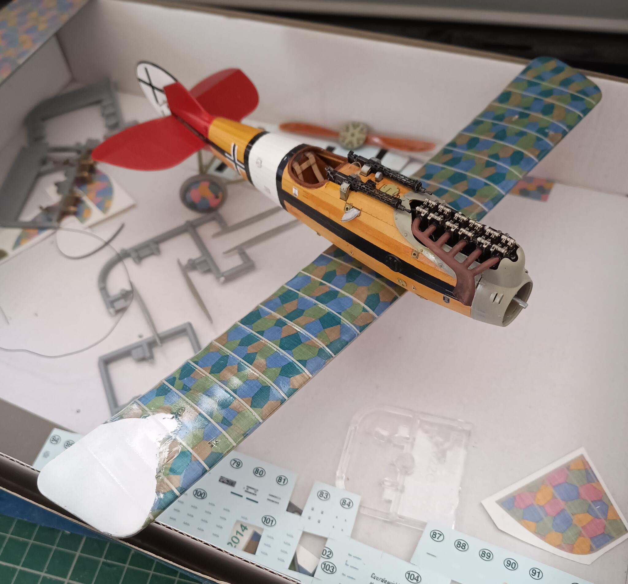

Slowly working the torn mess off I had a neat surface to work with.

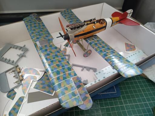

Fortunately, Aviattic include spare wing tip segments which came in handy, as well as a spare piece of lozenge that was just big enough to patch and match the pattern. Last job was to paint some spare decal film with pale gray/beige and slice into strip to apply as rib tapes over the new plain section. In fact it only took maybe an hour to fully repair as good as new. There's a lesson in there somewhere about just getting on with things rather than overthinking the difficulties!
As you can see I've now got the top wing on, with nice big black crosses and the rigging is started. I'll push on with this and mount the undercarriage - Not far to go now.

Great save - we?ve all been there! It?s looking very nice - one of my favourite planes.

   Brilliant recovery Sandy, the photo was terrifying and especially at this late stage of the build! No harm done. a good lesson for the rest of us as well and it's going to be a magnificent model when completed. Well done and congratulations in advance!

Things getting stuck in drills can turn out real bad. Glad there were only material damages. No visible trace after the repair either.
It?s a beautiful machine!
