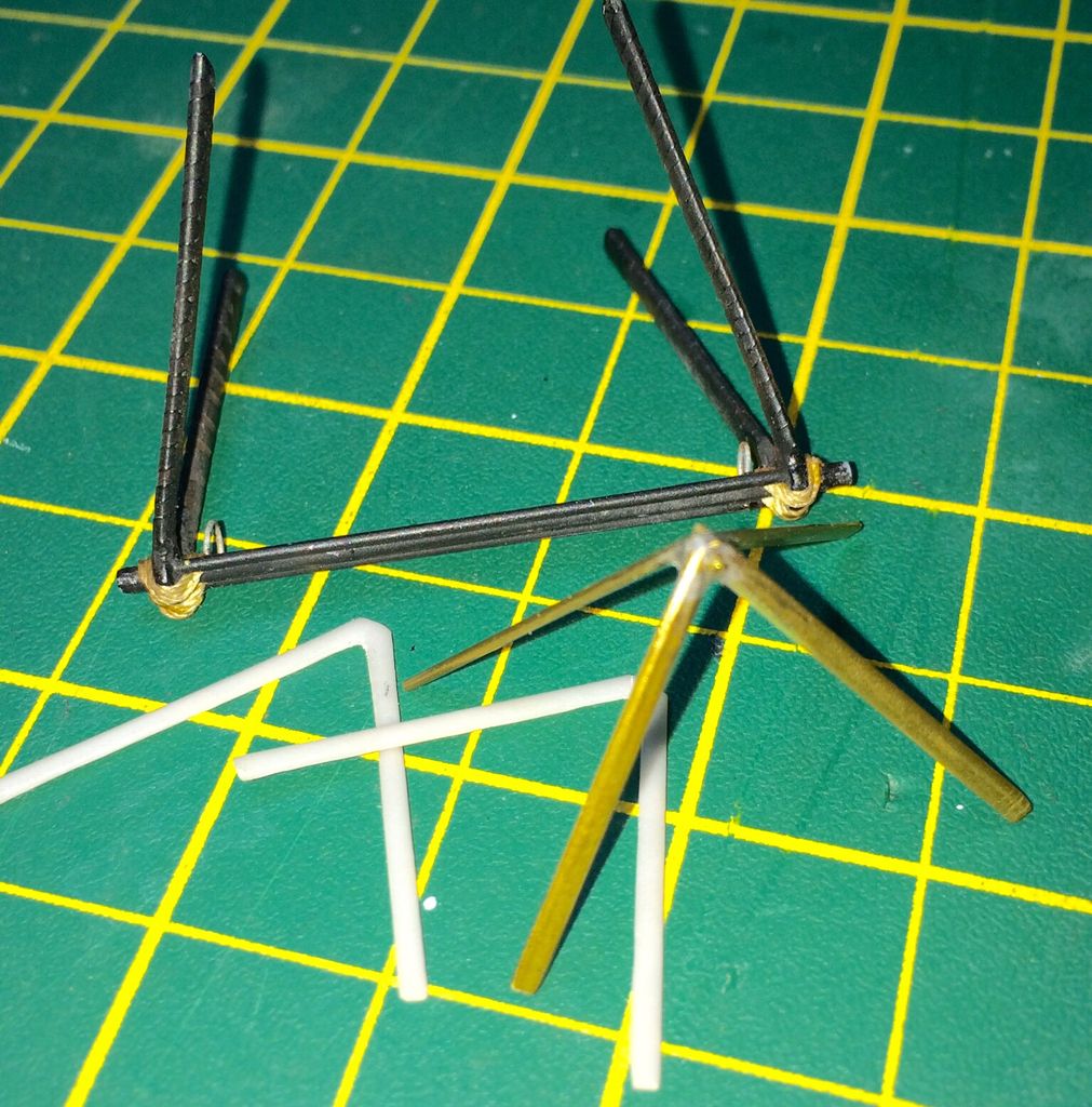

I've made the rigging frame which goes over the fuselage out of squeezed brass tube in place of the resin version in the kit. The resin pieces seemed to be if anything thinner than scale judging from the limited selection of WWI era photos of the aircraft to hand. Also they aren't very strong & I intend to use the rigging to avoid any long term droop of the fairly heavy wings so brass replacements seemed the way to go.
It's worth bearing in mind when looking at photos that one flying replica incorrectly uses circular tubes.
I apologise for the less than ideal photo but there's a short section of tube just visible at the intersection of the four struts, this is to take the end of the turnbuckles.
The undercarriage is finished other than the tread representing the rubber bungee cord needing a touch of grey tone & some overall weathering.
The legs of the original are wrapped in some sort of reinforcing tape & it leaves a distinct ridged effect in a slow spiral up the leg. I tried to replicate this (see much earlier photo of them in grey primer) by wrapping narrow strips of masking tape around them & spraying a couple of extra coats of primer, then removing the tape. After a light sanding & a coat of black paint (very dark grey really) they look ok.

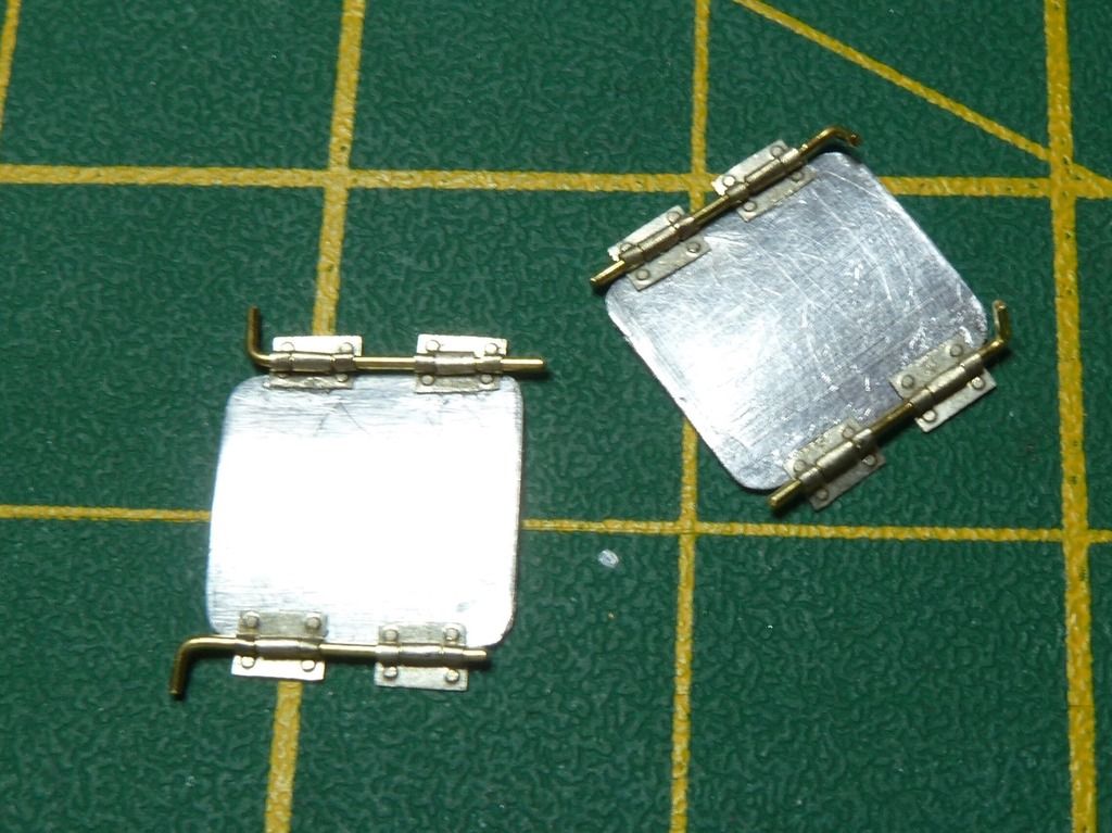

The inspection doors are made from thin aluminium. The hinges work & the retaining pins are removable but they'll stay shut on the model as I couldn't 'do a Bo' and rebuild that part of the interior to 'inspect' through any open panels.
A coat of primer, then paint followed by a bit of suitable 'scratching' is next.
Russell

Excellent work on the two panels, the hinges are extremely well done, and small.

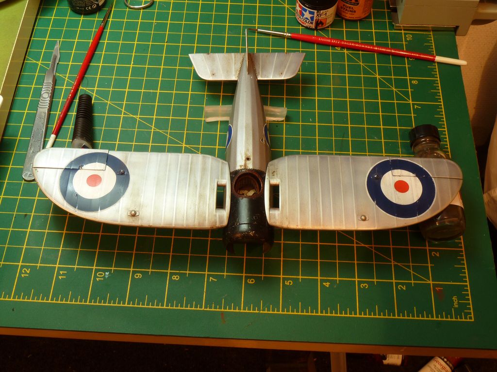

Coming together slowly. The wings are just pushed in place at the moment.
The access panels are on now.

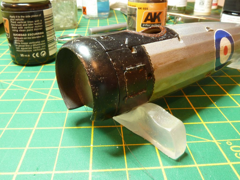

The cowl has been washed with Mig 'fuel stain' to represent castor oil.
The paint chipping looks less noticeable on the bench than in the photo but some photos of late war / early peacetime Bristols show very heavy abrasion to the paint on the cowl & nose areas.

   Really nice "wear and tear" on the cowling Russell, and those tiny panels are pure magic. She's really coming together nicely now, keep up the spectacular work!

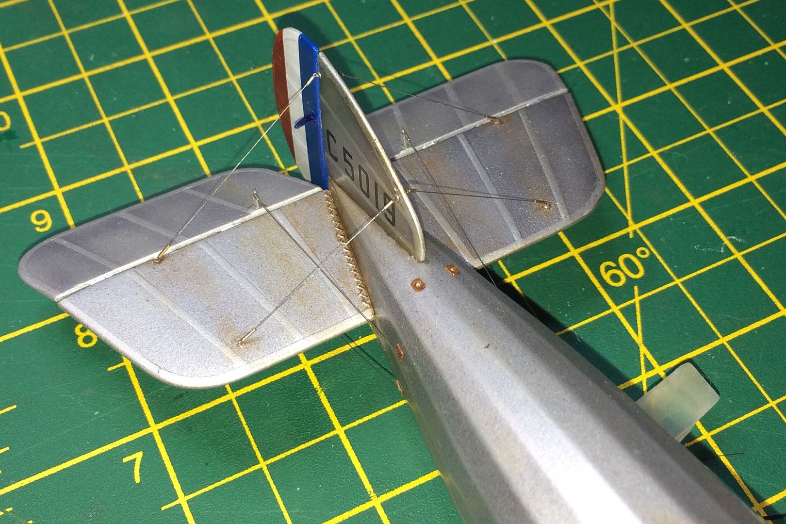

Very intermittent progress but the tail rigging is almost done, just the control cables to the rudder to go.
