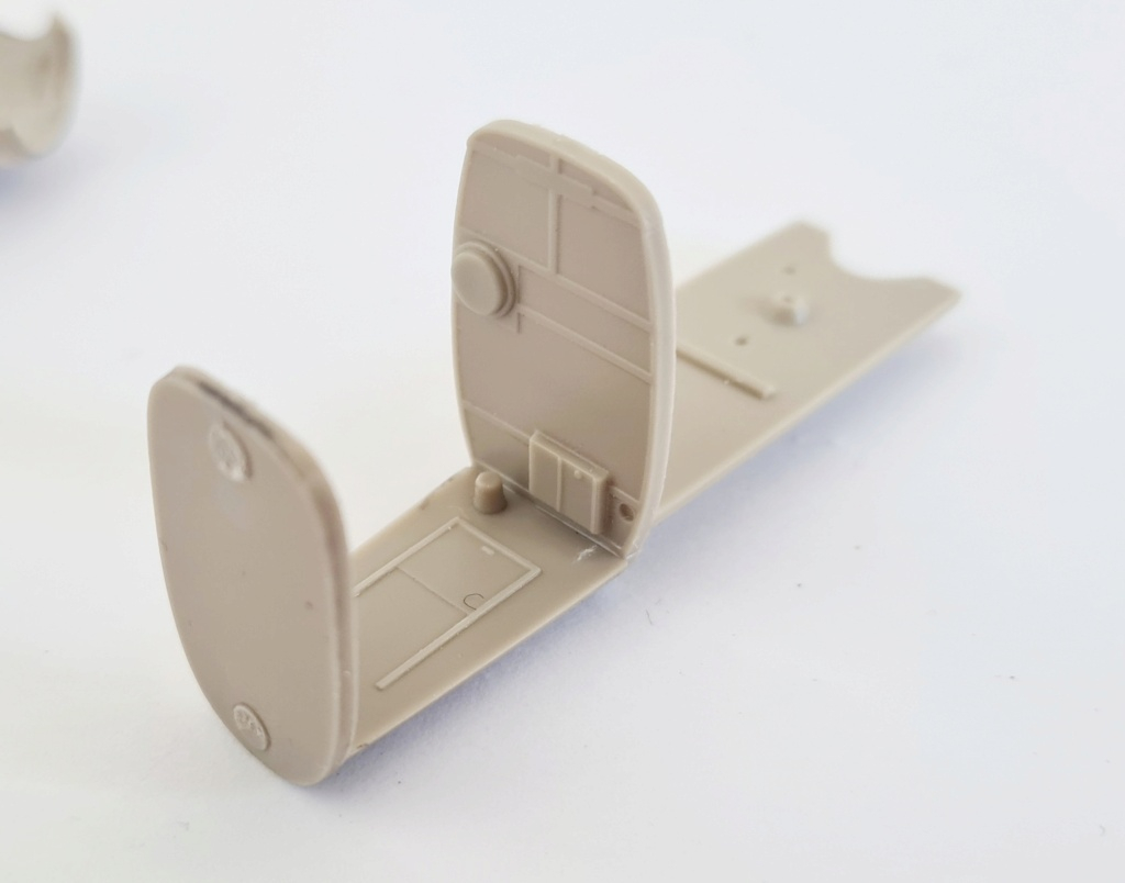

Let's see what Eduard has to say about the walls:
There's an idea! And it's not so bad. I think we can live with it. On the other hand, you'll have to get rid of those ugly ejector pins, which are indispensable, if only as a matter of principle.
But as far as I'm concerned, I prefer to eliminate everything and redo the entire internal structure independently.

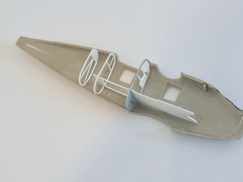

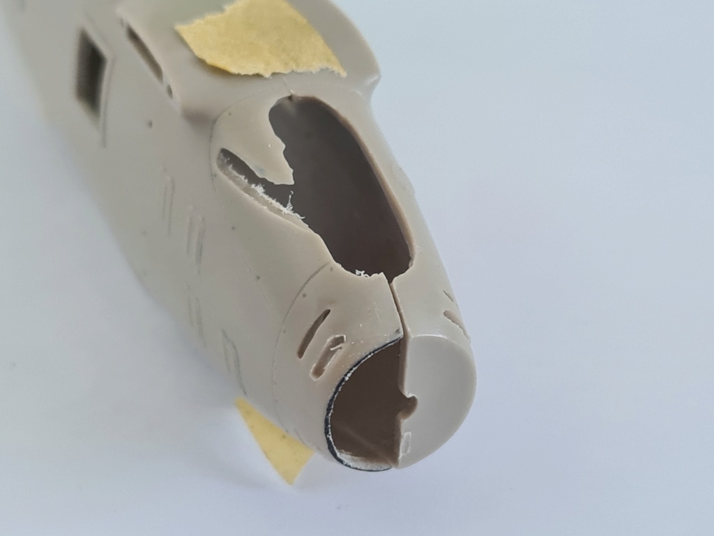

As I've decided to redo the internal structure that I'll place in the fuselage, a thorough sanding is in order.

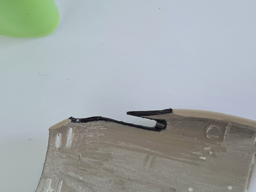

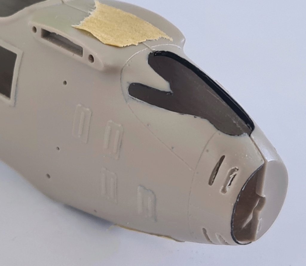

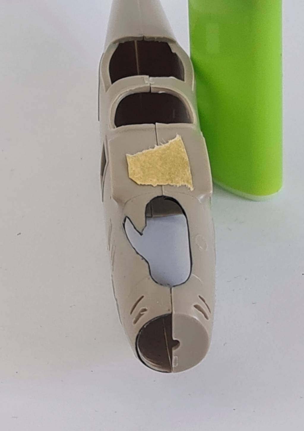

I took the opportunity to remove the front bulkhead, which doesn't exist on the real thing, and to refine the engine covers. To do this, I use a dremel. It's fast and efficient for roughing up as much as possible, before using fairly fine sandpaper:
To guide me, I mark them with a black permanent marker.
It's a good guide for sanding, whether with a dremel or sandpaper:

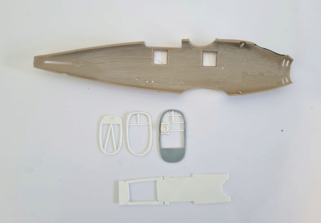

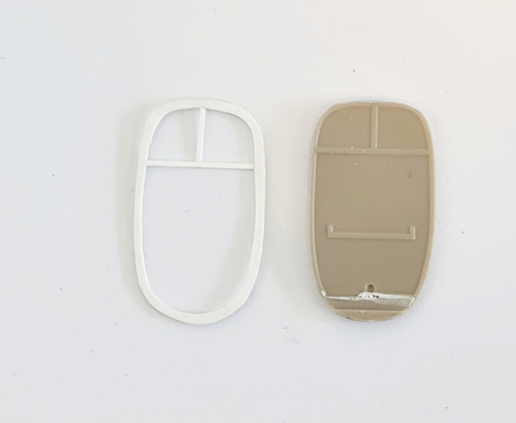

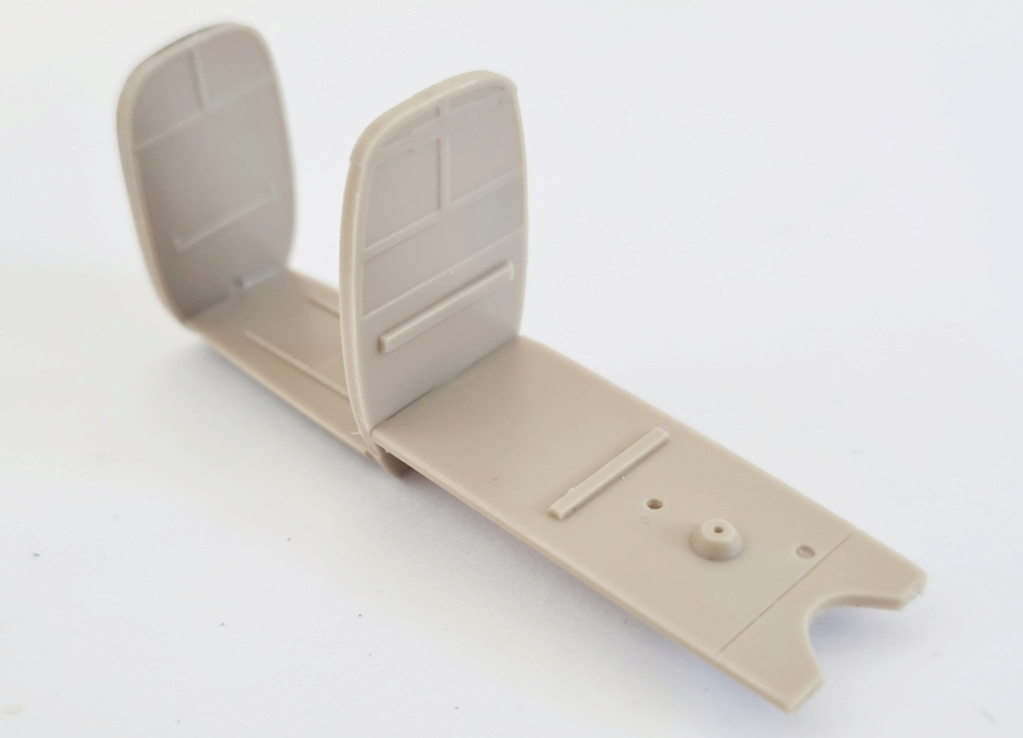

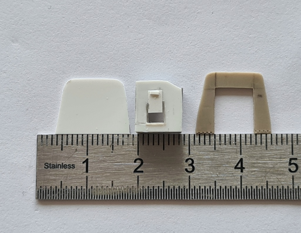

Here's what Eduard proposes: solid panels that give the impression that they were wood panels separating the pilot from the observer.
But....

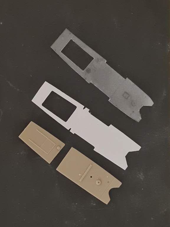

So I draw the new parts on tracing paper.
These drawings on tracing paper are then glued with white glue to a piece of Evergreen, and forward to cutting with the X-acto blade:

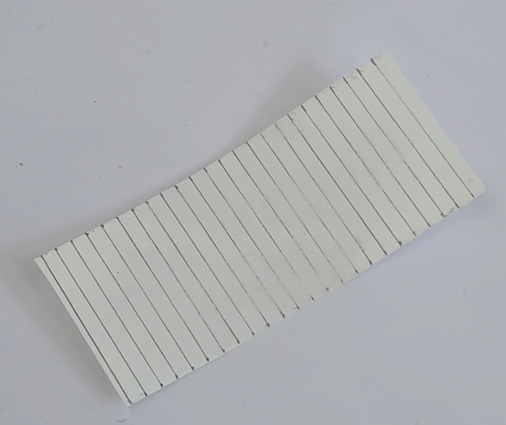

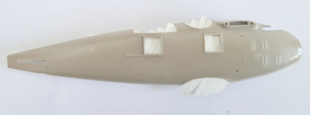

Today I redid the fuselage walls

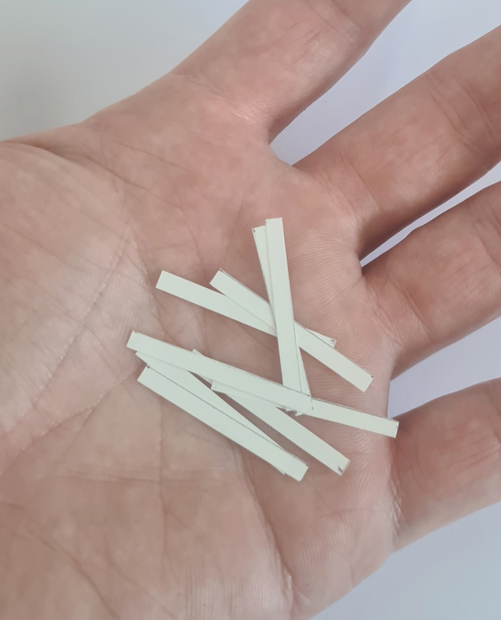

I started with a 0.13mm thick Evergreen sheet, so as not to add too much thickness to the walls, and to be able to bend them in curves without risk of breakage.
I drew 3mm widths.
Then cut:

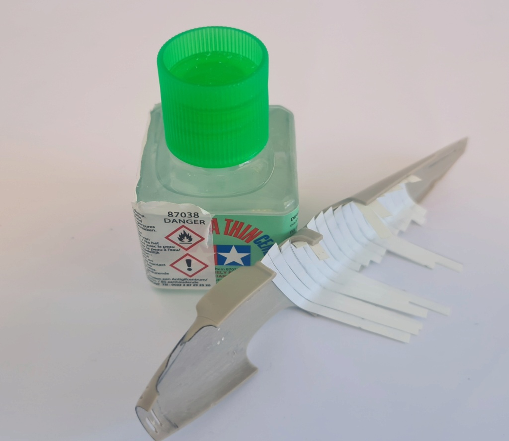

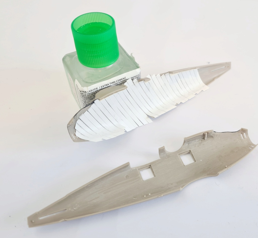

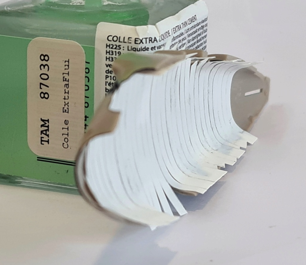

Then I glued them one by one, without worrying about the fact that they protruded from the half fuselage, or that they covered the windows:
Once all the laths have been glued in place, you can remove any protruding laths and hollow out the windows.
See you soon for the next part :)

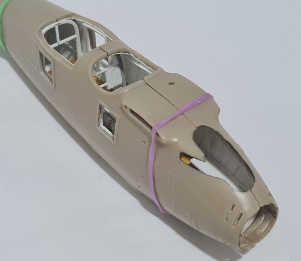

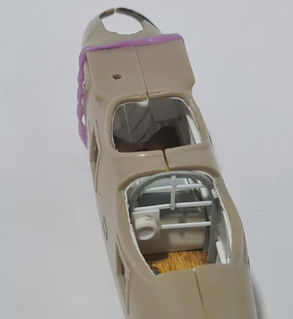

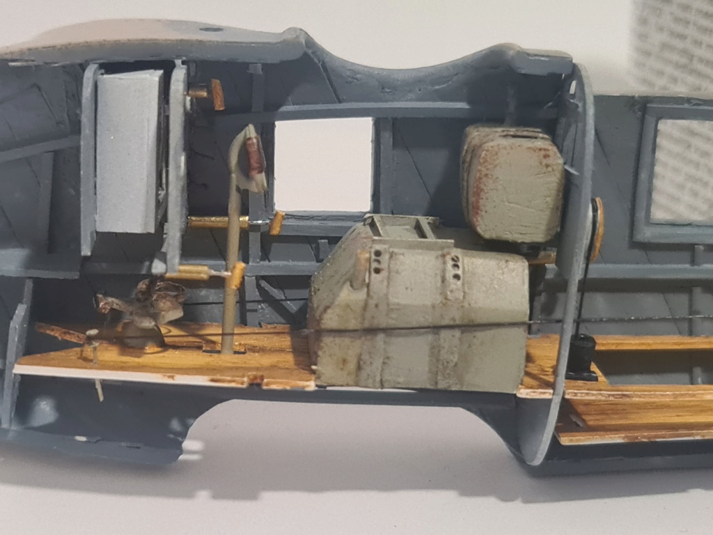

I did make a lot of progress with the Roland C.II!

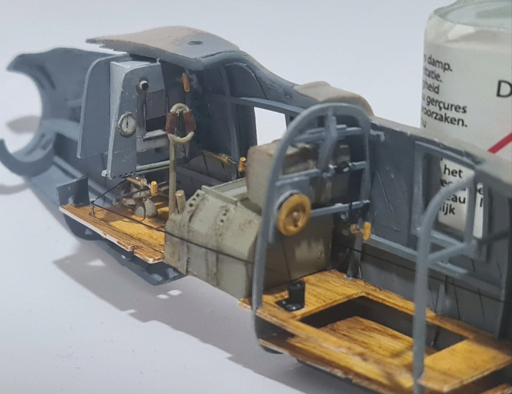

I'll try to summarize, but overall, the whole cockpit has been redone.

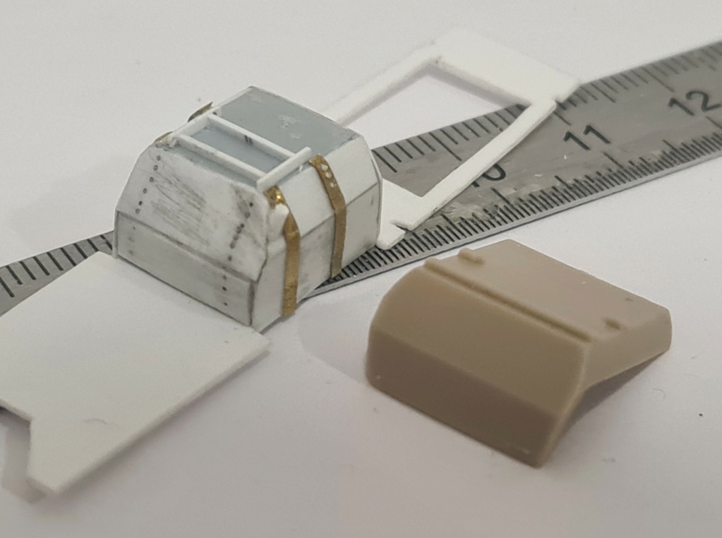

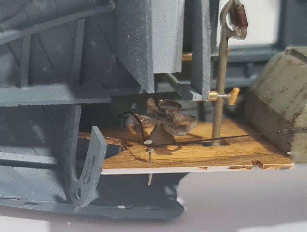

Both tanks:
Fuselage walls:

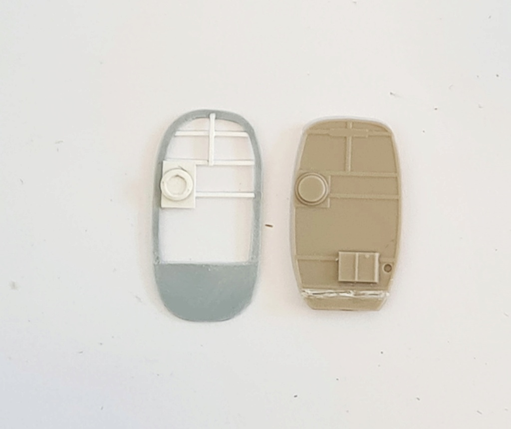

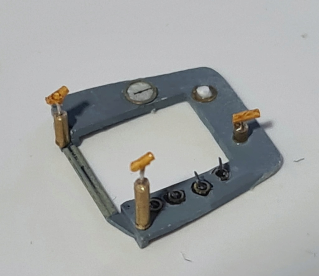

The instrument panel, including the pumps, and the ammunition locker are also rebuilt.
Adjustments are checked and validated
The whole assembly is painted and then glued into the fuselage.

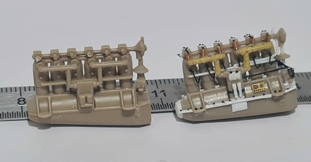

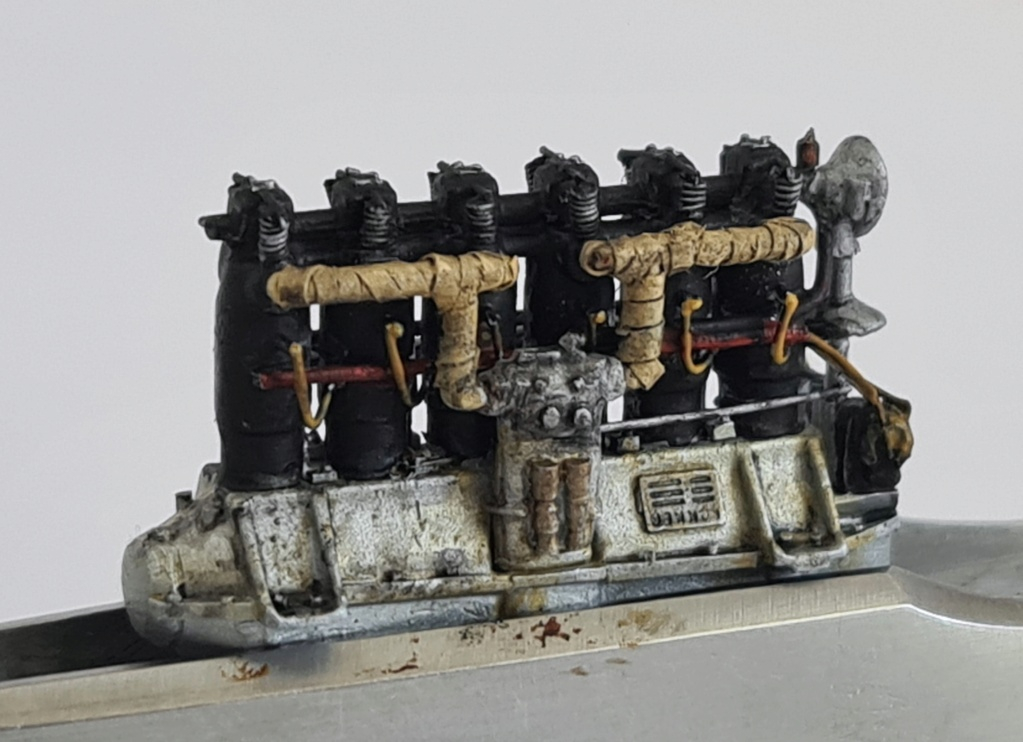

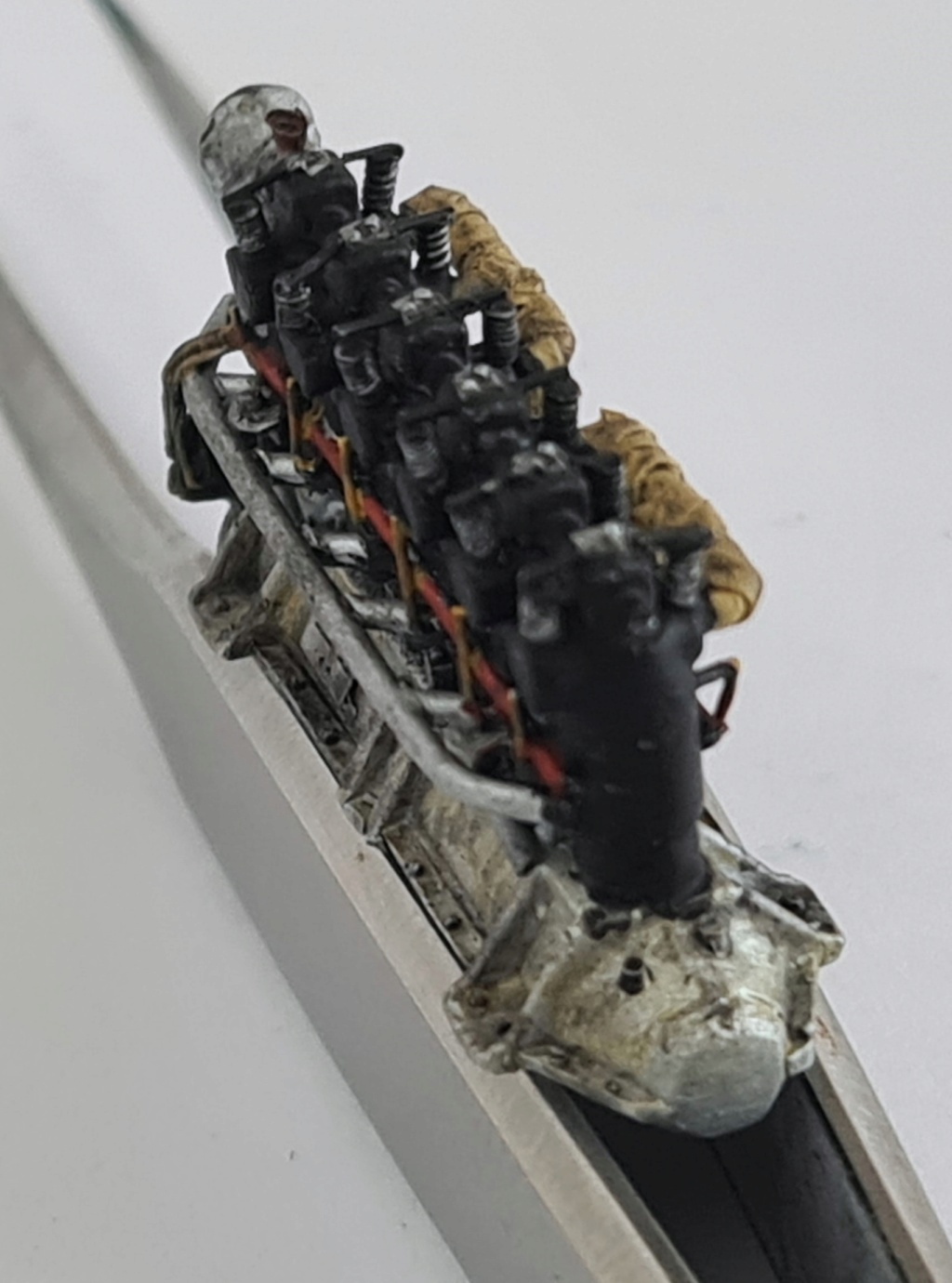

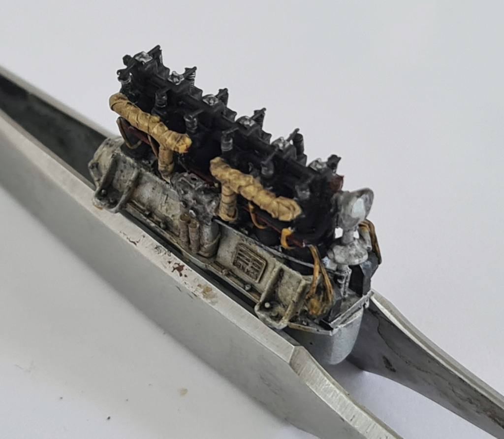

The engine is heavily modified
I started painting it. There are still a few details to add.
All that's left are the scratch-built seats.
Then a few details to add, and I'll have to close the fuselage  ;D
