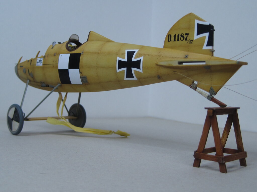

The main work is almost all done, so slowly but surely the building curve for this Albatros D.V is coming to an end.
The D.III Mercedes engine is currently under construction.
A few small details are still missing on the Albatros' belly.
A few current pictures from the "Albatros Werkstatt".
The landing gear and the windshield are only loosely attached in the pictures - both will be glued at a later stage of construction.
Servus
Bertl
