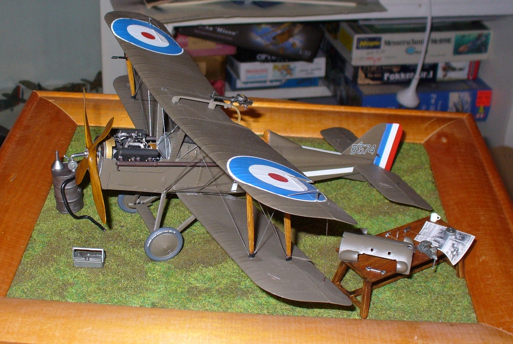

As a brush painter I have for many years used Humbrol enamels and mixed a PC10 batch using two parts of Humbrol 29 dark earth and one part Humbrol 33 matt black.
Here's my Wingnuts SE5a using that mix:
Incidentally Wingnut Wings recommend Humbrol 155 green for PC10 and I've used that too.
I used to be an enamels-only brush painter but have converted to acrylics. Humbrol acrylics are the best so the mix formula is the same as with the enamels.

By the way I like how you used that picture frame as the base of your model.  Clever and effective idea.
