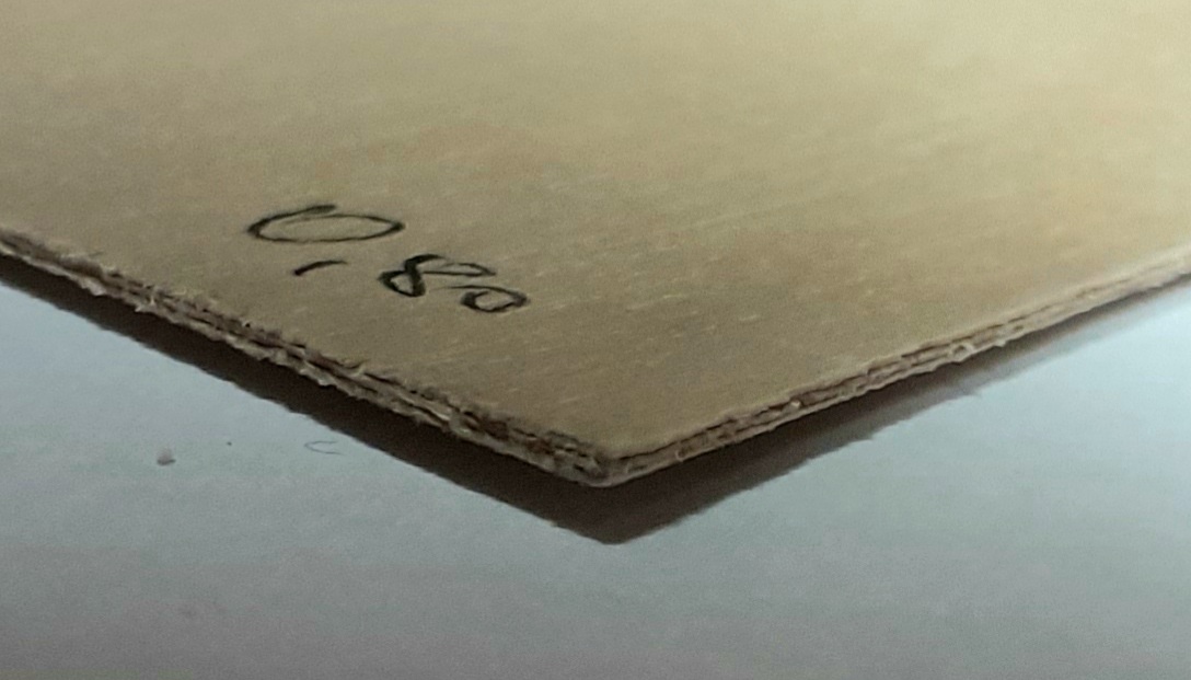

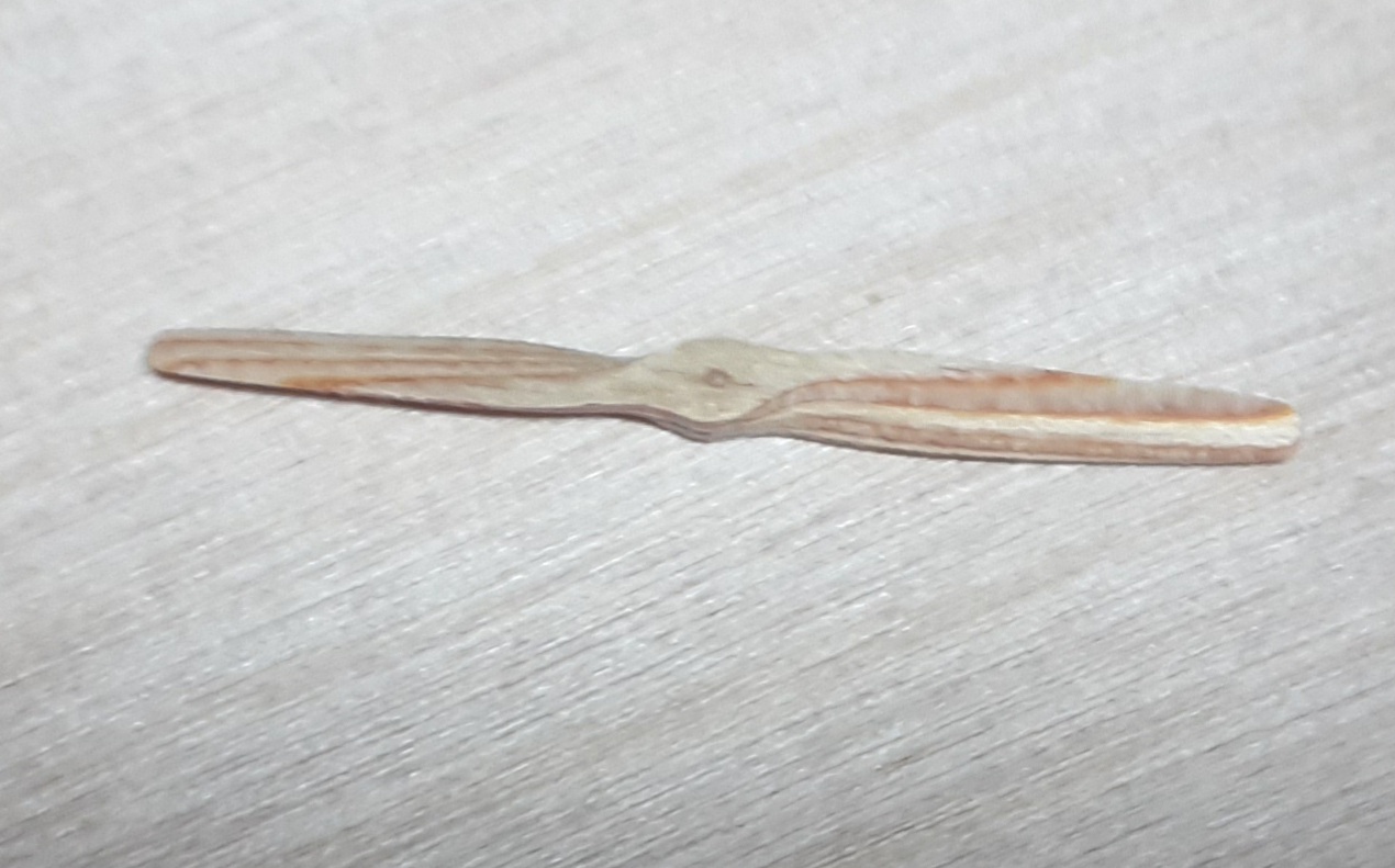

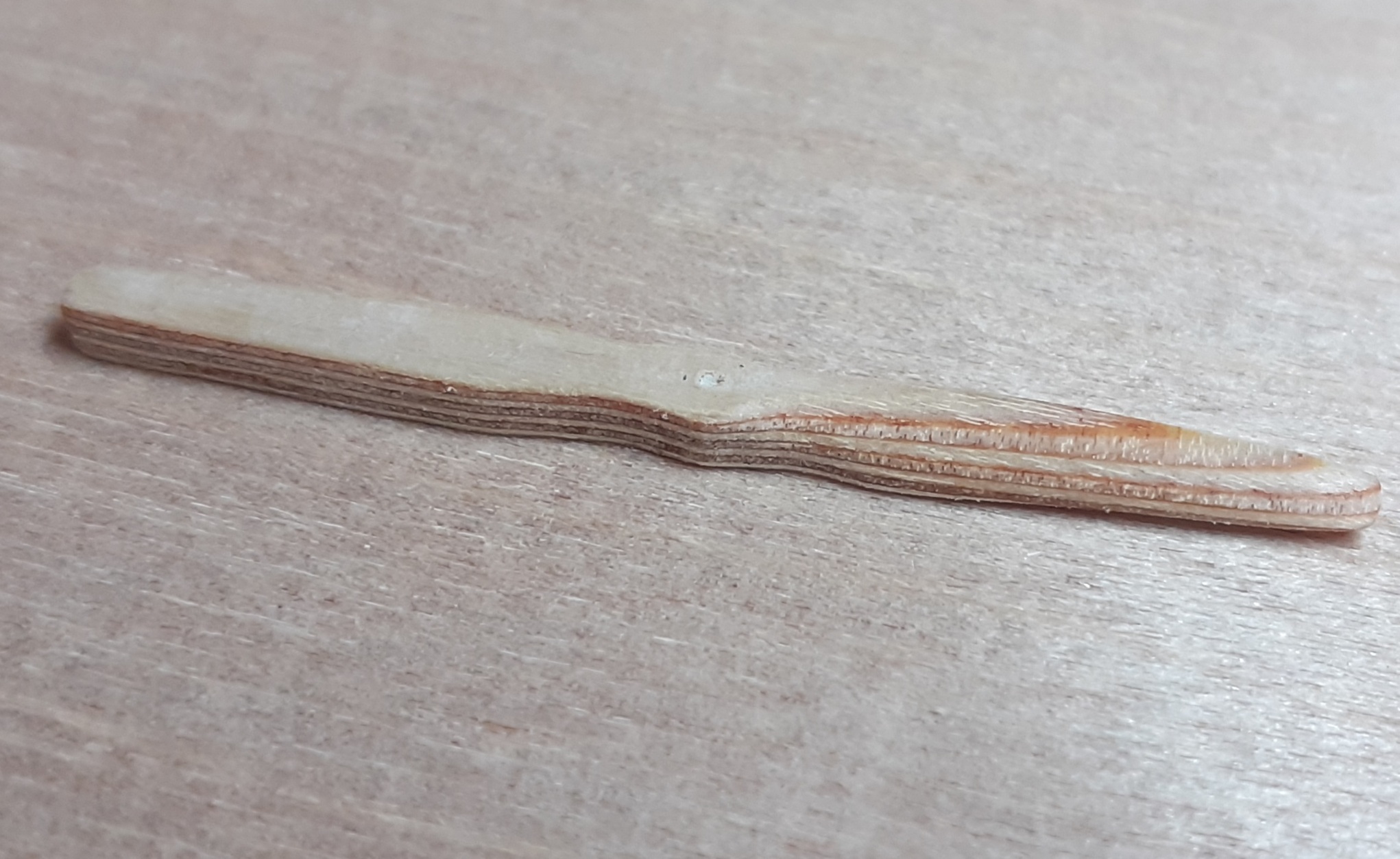

And I have finally carved the wooden prop for this little kit. I will be very unmodest and will say that I am very satisfied with the result.
I have used the 3 ply veneer of 0.8mm thickness, sanded one layer to get two sets of 2 plies and combined them with the 3 ply original to get the 7 layer composite. Then some work with a knife and sanding paper... It works!

I wanted to carve a new prop and was struggling to get the correct thickness using plywood - I'll use your method. I'm sure you will have mentioned it somewhere else (and apologies if you did) but how did you finish the propeller?
Thanks
ps I had to keep going back to confirm that this is a 1/72nd scale model! 8)
I might have not mentioned it... ;) The carved wooden piece was just sprayed with a mist of Gunze acrylic Clear Orange colour - a few passes to reach the nice warm wood hue. The prop boss is from Part PE, the Axial decals are from the kit.

        Again, you do not fail to amaze with your builds and skills. I've wanted to carve a prop, but have had trouble sourcing veneer the correct thickness.

I found that making this smaller prop is actually easier that the large one for 32nd scale. I think that the problems might occur if one wanted to carve a couple of identical ones for multi-engine aircraft :-)

I got mine from Kotebi. He says this thin plywood is generally available. And I think he can also sell it if you cannot find yours.
