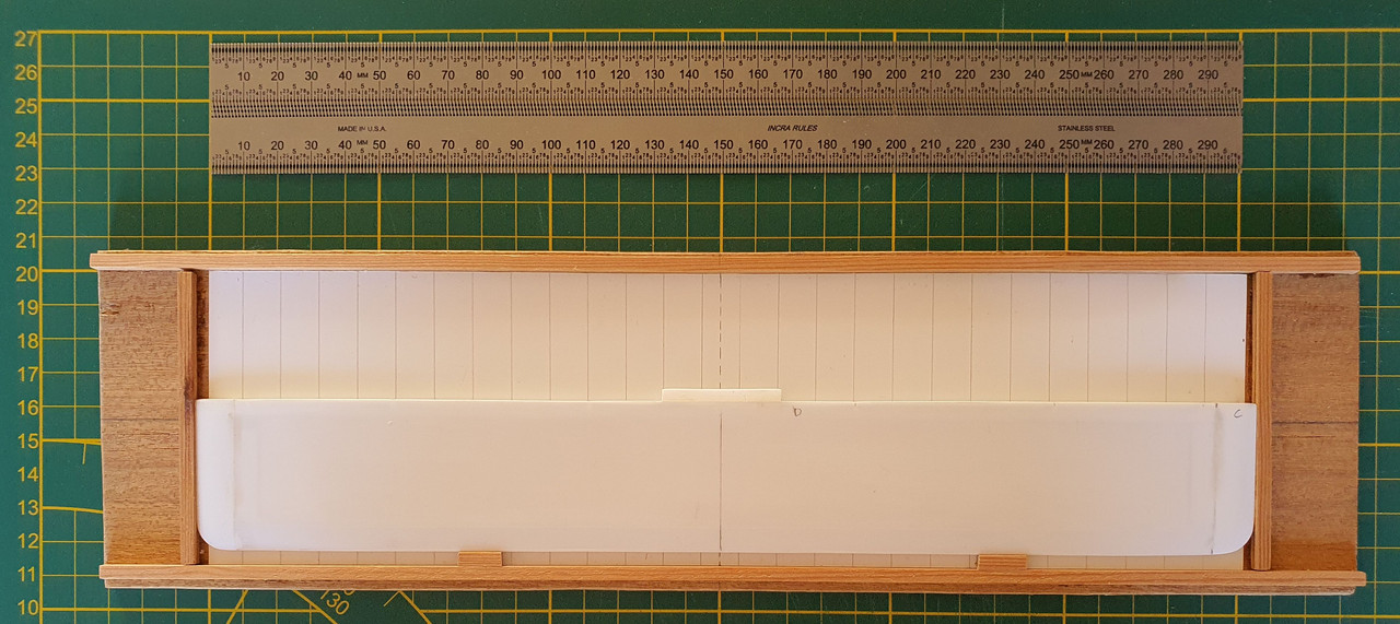

Whenever I can I make and use templates and jigs to produce parts that are supposed to have the same form or shape.
The rib jig I made really helps to get the ribs straight and evenly spaced. Even for a one-off it pays off. Because of the arthritis, it is hard for me to keep my hands steady. Now I can rest my hands on both sides of the jig on the table. This way I can position the ribs more easy in line with the pencil lines.

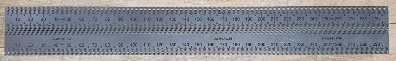

Last but not least I use this precision ruler. It has holes for every 0,25 mm and it helps me to measure very accurately. You can use a sharp tipped pencil, a mechanical pencil or even the tip of a sharp no. 11 knife blade to pin-point reference points. Again I can work more precisely than with an ordinary ruler and trembling arthritis hands.
There is also one in inches.
