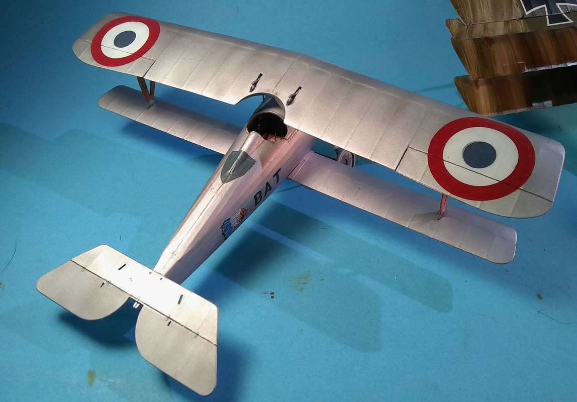

That 24 is looking quite superb, Rick. Sorry about the disaster though, you get more of your fair share! But a great recovery. I think that attaching the top wing first and using this to line up and support the lower wings is the way to go, I think I was planning something similar on mine before Covid erased my memory! The collection is stunning, thanks for posting! Marc.
Thanks Marc. I think My approach on the 24 wings was good I just rushed things and didn't quite get the cuts right. If I ever do another I know now what not to do  :o Also thanks for the comments on the collection  8)

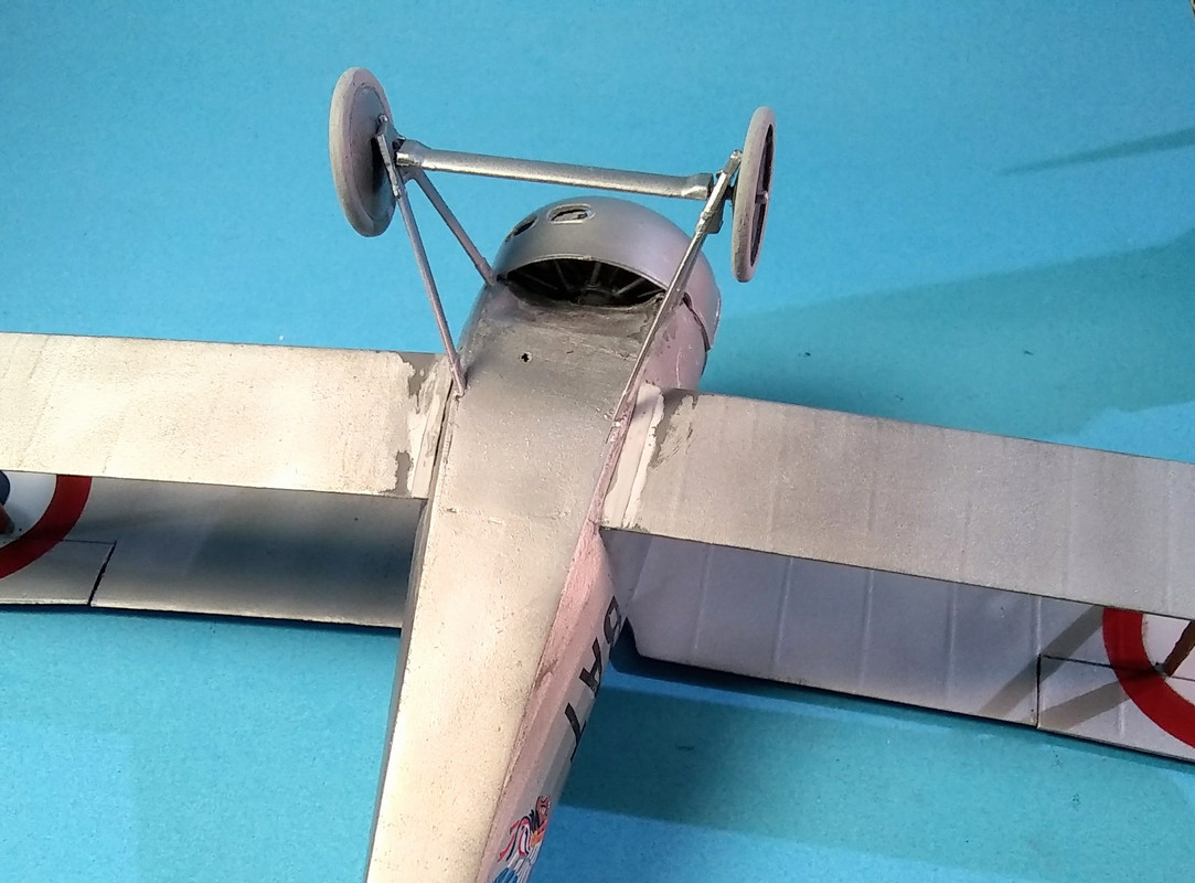

It has been a while without updates on this one but never fear it is still in the process of being built  ::) The filling of the wing root did not go as easily as I had hoped! I think I have it where I can accept the results now....Hopefully! Ready to touch up paint now!

That wing root. Did the 24bis do away with the pivoting lower wing then?

I have to admit to knowing Nothing about a "Pivoting" wing. That being said the photos make it look like the wings are filled solid to the fuselage. There is still a space between root and fuselage just not as large as before.

I'd say that was unlikely
Going waaaay back, Nieuport introduced the Sesquiplane design with the XB. One of the special features was the ability of the pilot to change the angle of attack of the lower wing via a lever in the cockpit
To do this, the wing had one spar, and it pivoted in a socket in the end of a tube running across the bottom of the cockpit. This apparently a Nie 23:
You can see the socket on the bottom longeron
Because of wanting to make the wing pivot, it lead to several features that are characteristic of the little Nieuports:
The wing is narrow chord because it has only one spar
The outer struts are a vee so the wing can pivot around the base
It has a cylindrical connection to the fuselage
Only the XB seems to have had the control lever, all subsequent Nieuports kept the narrow chord, single spar wing. The socket seems to have been useful in rigging the aeroplane
Incidentally, this single spar wing may well be why the Nieuports suffered from lower wing flutter and failure
So - I wouldn't expect to find the lower wing of a 24bis to be fully faired to the fuselage - there should be a join. Otherwise they couldn't take the wings off

Not a bad turn out on the lower wings Rick . Once the clean up is done no one will never know . Awesome !
