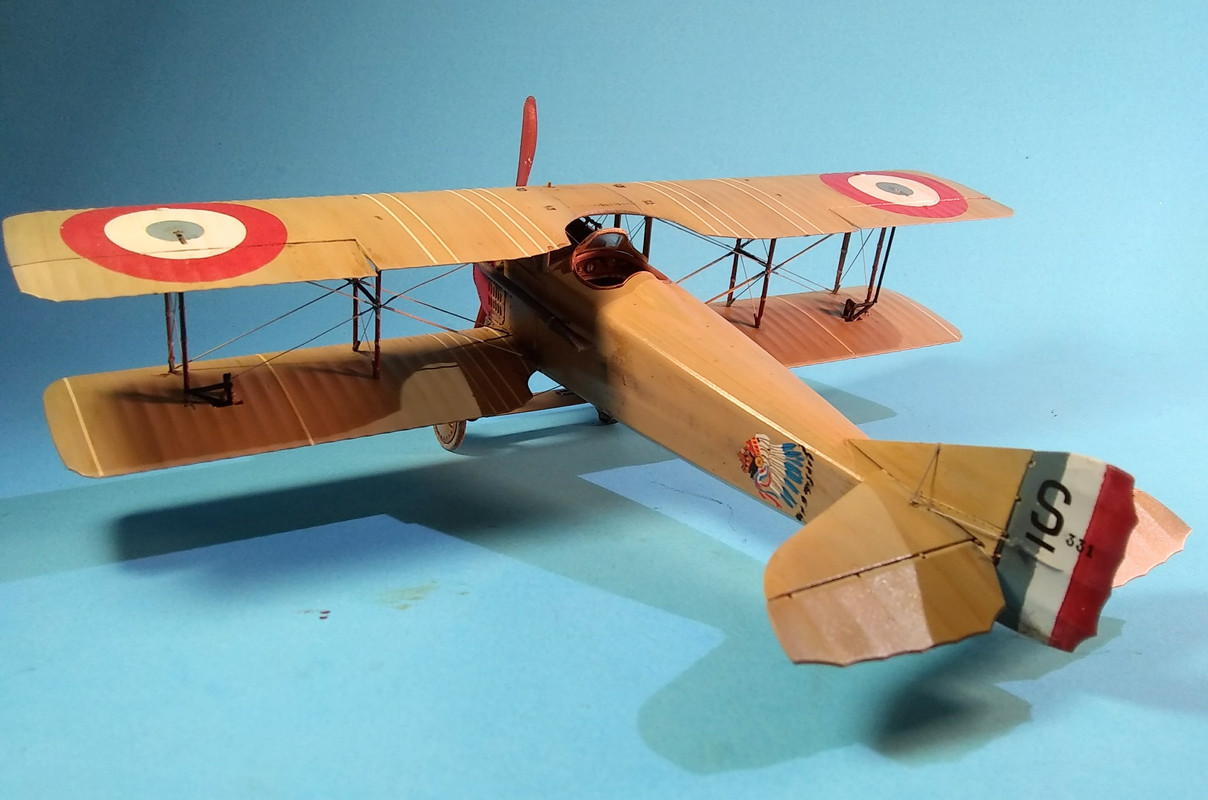

Thanks Bob! The SPAD is almost done. Just some touch up and the final clear coats left.
The Nieuport is primed and ready for paint. ( I will be using the Aviattic Cowling)
The SPA 124 Lafayette bird is now finished. Touch up and final weathering have been done. I will begin painting the Nieuport later today or tomorrow!
Final Photos in Completed Models:
