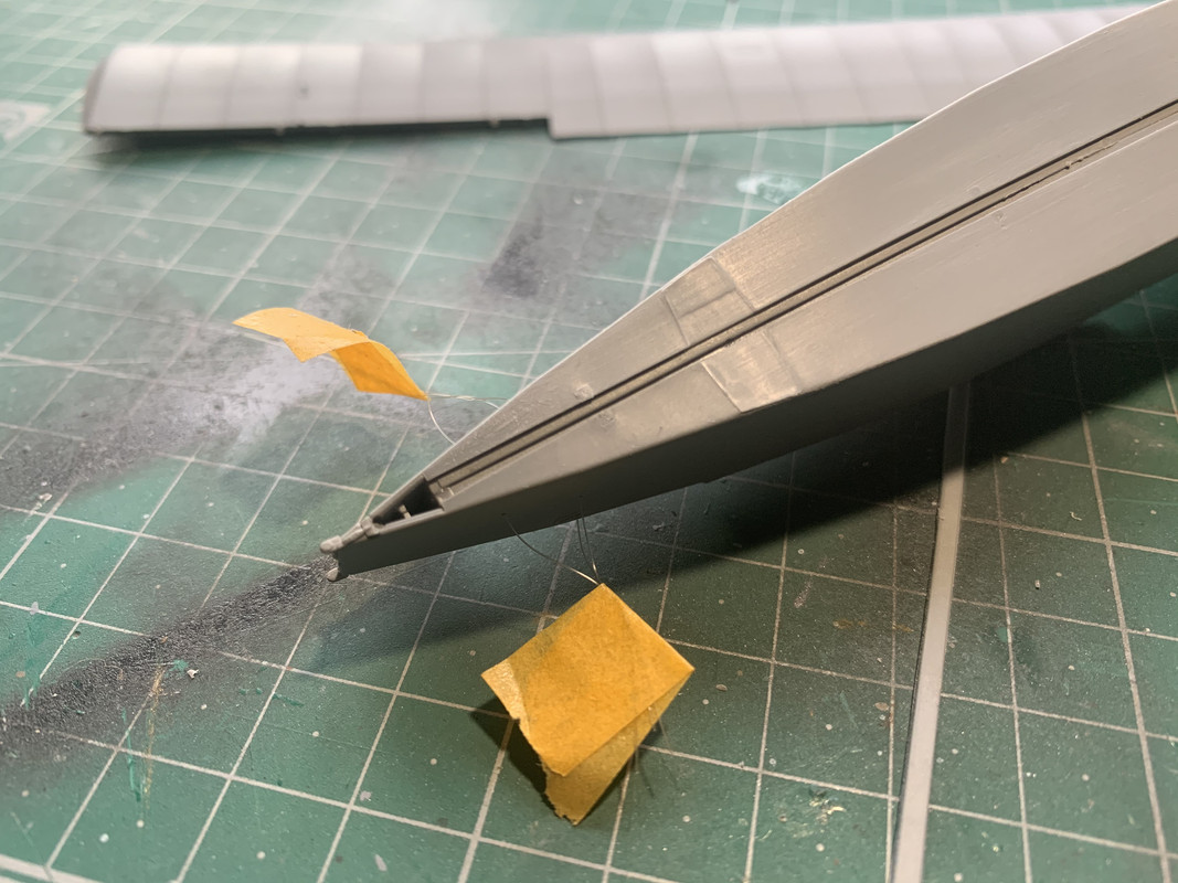

Thanks Bob,
I’m a total convert to MRP - spray like silk and never fail through the airbrush. No thinning required, just a smooth, consistent finish. Highly recommended.
I’m having a couple of issues. The join along the base of the fuselage isn’t even. Which isn’t letting me use the insert seam (with the stitching) it should be easy to fix, but for some reason I struggled - and ended up using a strip of plastic card. Don’t know if others have found this? Or is it just me...

Is this assembly like the Fokker DVII in that you do not glue the bottom seam until after inserting the strip with the stitching? Thanks for the heads up on the potential issue!
Re: Meng Fokker Dr.I
« Reply #34 on: September 10, 2020, 03:57:32 AM »
Thanks Rick,
It didn’t mention that, but the real issue was that the join line inside the trench was totally uneven- don’t know how that could happen, probably me. I’d be interested to see if anyone else has that issue...
