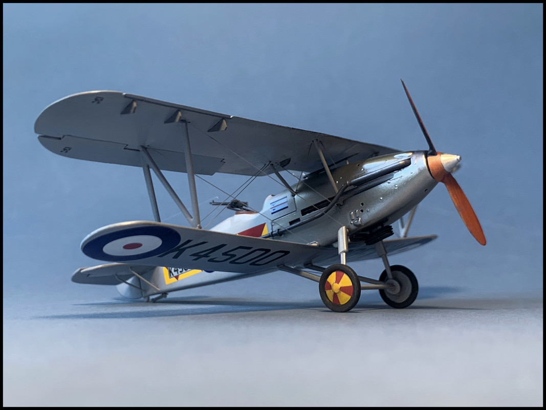

And here’s my last effort. The ‘Vintage Classic’ Airfix 1/72 Hawker Demon - new boxing but the same kit from the 60’s but with more flash! Quite a few alterations to the kit, but it’s basically still a nice model:

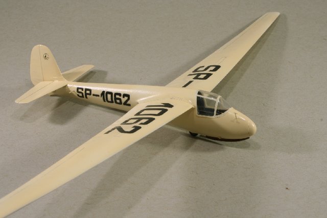

A couple examples of the 1/48 sailplanes.  I have added some details, but not much.
IS2 Mucha
SZD Bocian
Good luck with your build. You may want to replace the resin struts with wire.
