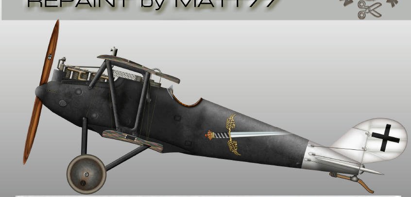

Great job!
Now that I have looked at your changes, I am no longer afraid to face the construction of the Fokker DVII.
I read that you want to make a Pfalz, if you want I can send you this DIIIa Jasta 40s (pilot Werner Hertel)
regards,
matt77

« Reply #69 on: May 18, 2020, 03:59:40 AM »
Thanks you guys...
Marco!  You sent that one along with the current Fokker so I am super excited to start it next!  Can't wait.  These are such fun to make...
Thank you again!!! :D :D :D
