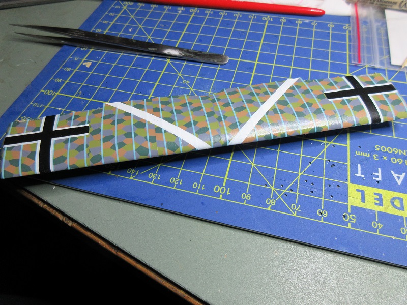

And here we go!
Doing lozenge and rib tapes was on my bucket list for decades...better late then never.  ::)
After working on it for at about 14 hours....
I don't think I ever spend so much time applying decals on a kit...let alone a top wing. :o
The Eduard manual has lilac stripes on the top wing...WNW...white.
Maybe it's unknown, but I go for white.
I'll varnish and do the stripes before I continue with the underside.
Afraid to damage what I've done so far.
The "OAW lilac". Used next to dark green on the undercarriage, wheels and engine covers.
As per WNW Ronnie Bar artwork. A greyish lilac / mauve.
More soon,
Robin  :)

Scary moments...painting the white stripes
Before masking...varnished twice with semi-gloss and stuck the masking tape to the palm of my hand several times before gently putting it on.
I was very afraid to see all my work sticking to a piece of masking tape when done....or paint underneath the tape because of poor adhesion.
Luckily it went well....only lost a tiny bit of rib tape. That was easy to replace.
Thank goodness I have decals for the black stripes on the bottom of the lower wing, but the lilac on the fuselage?  :-X
More soon,
Robin

« Reply #20 on: November 04, 2019, 08:15:59 AM »
The result of your lozenge party looks good!
Yes, I hate masking on decals too, and I'm doing shadows on the ribs on to of my decals ::)
Your lozenge looks opaque - that is the advantage of Aviattic lozenge, it is possible to shade prior decaling on bright (white or a bit darker) and put this shine-through decals after that.
Are ther some lilac parts on your decal sheet or only white/black and you can airbrush it completely?
« Last Edit: November 04, 2019, 08:36:59 AM by Bughunter »

« Reply #21 on: November 04, 2019, 08:30:25 AM »
Thanks Frank,
These are Microsculpt lozenge decals, hardly opaque.
That's not an issue with this build. I'm pleased with how the lozenge looks.
Perhaps I do some light post-shading, but might as well leave it as it is.
Masking on top of decals on the other hand....yikes!
I have to do the lilac fuselage band and rear of the fuselage underneath the tail. No decals included (I don't like the "Eduard Pink" anyway).
The engine covers I can do before I apply the lozenge.
I suppose I just have to mask it very carefully....like I did with the white stripes on the wing.
Robin :)

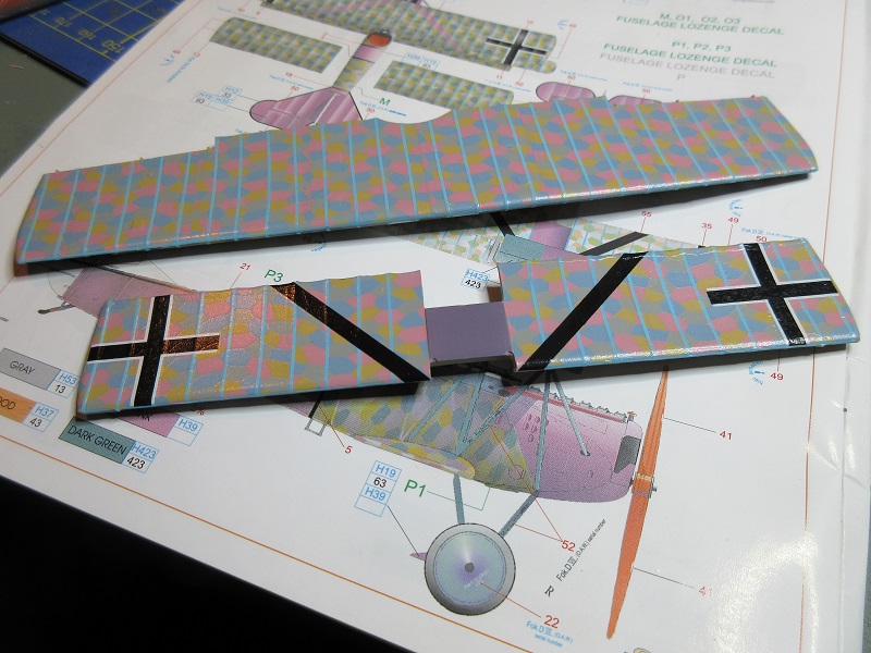

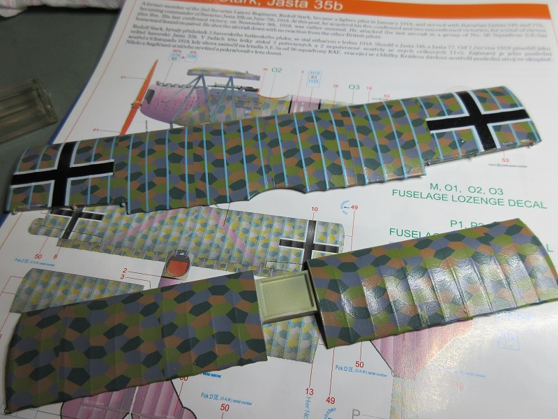

« Reply #26 on: November 06, 2019, 04:01:40 AM »
Thanks guys,
After 20 more hours behind my work bench...
Am I slow, or is this just crazy time consuming?  :o
Still some jobs to do on them, but getting there.
After that, I can do the engine and close the fuselage.
More soon,
Robin
