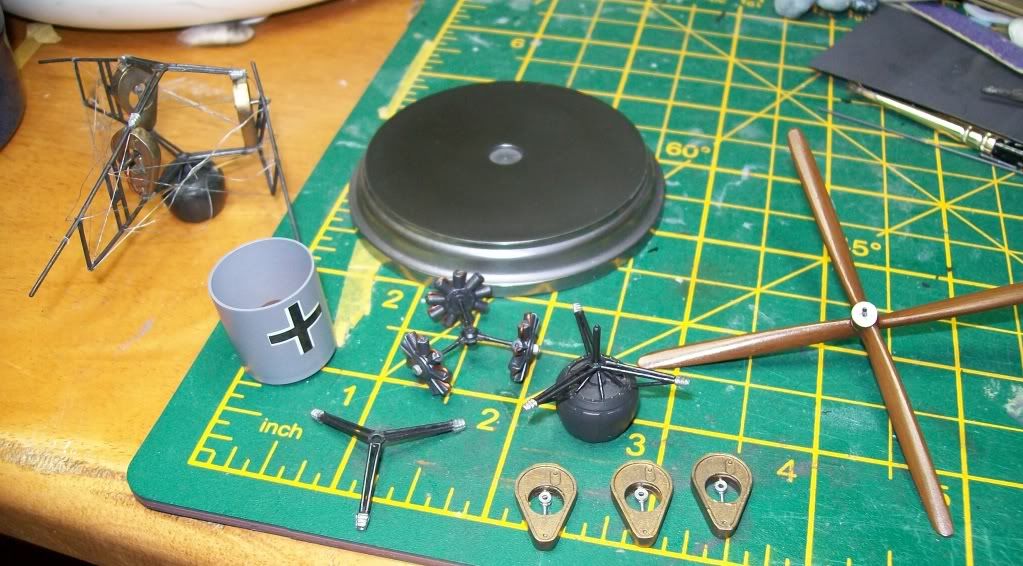

Made a bit of progress with the replacement parts.  In the first pic you can see the remains of #1.....

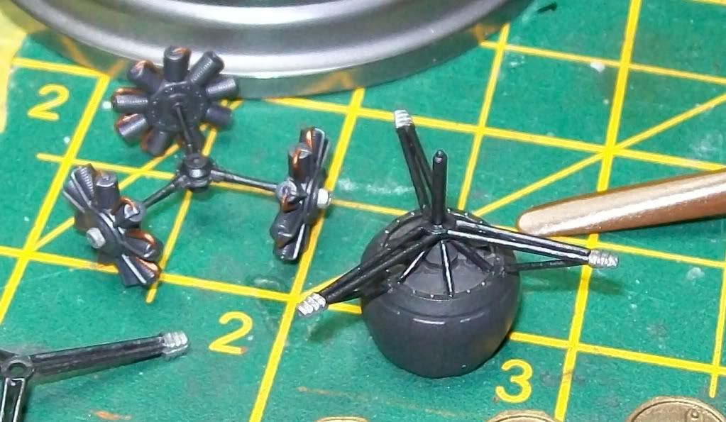

I'm happier with the components this time, so far.  Being more careful with the assembly too....

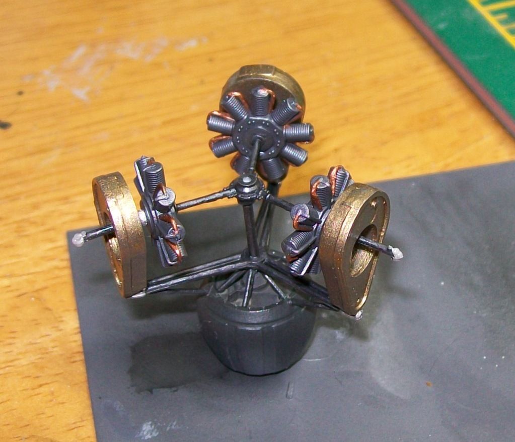

« Reply #22 on: May 20, 2012, 03:32:54 AM »

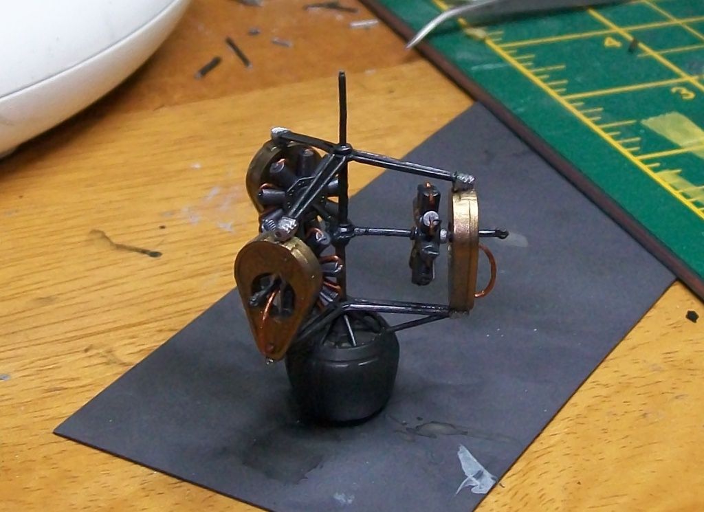

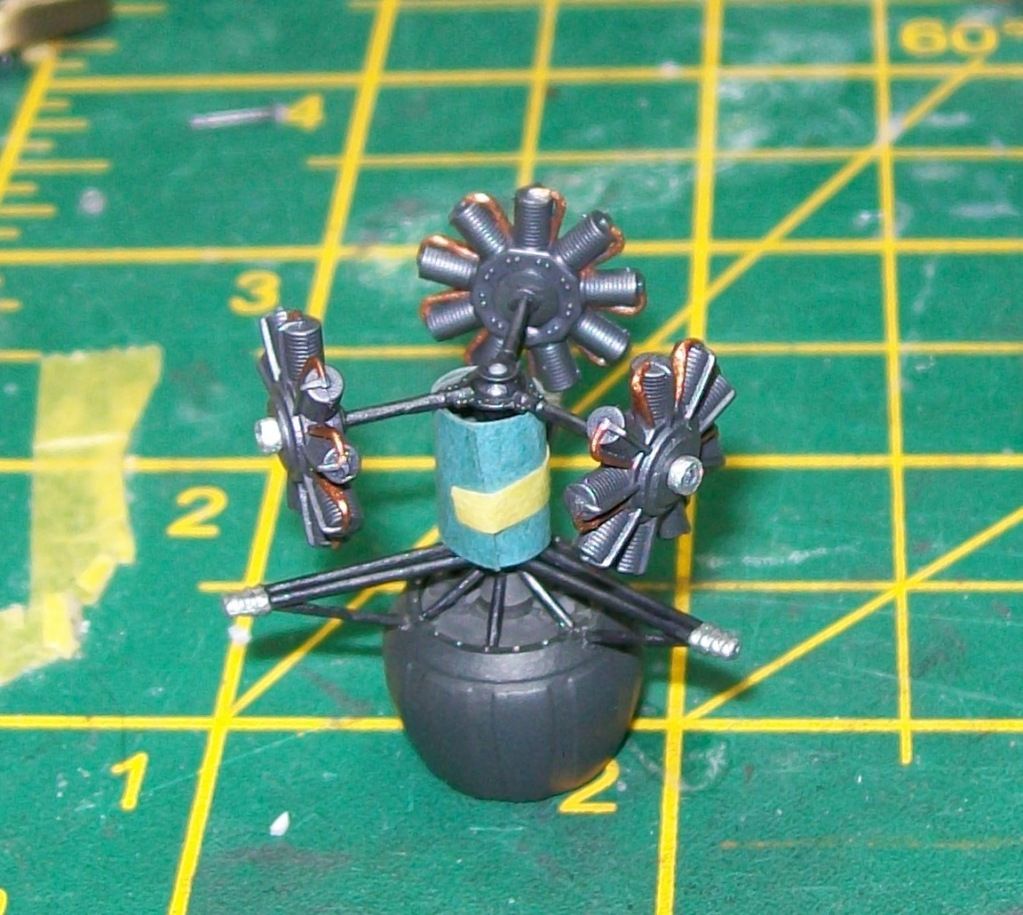

I remembered from my first efforts that I had struggled to balance the central engine assembly whilst attaching to the fuel tanks and the tanks to the outrigger attachment points.  It's a bit like balancing a mercedes car badge on a pencil end whilst using both hands to fix something to the bagde edge!
So I made a simple roll of fine grade wet and dry paper, to support the assembly whilst glueing the fuel tanks on.  The following pics show how this worked, then the central assembly is done, touched up and ready for the outriggers.  I have put this on the shelf far away from fumbling fingers - I AM NOT REPEAT NOT GOING TO DROP THIS MODEL ON THE FLOOR AGAIN......!!!! ;)
You can just see some small holes I drilled into the ends of the attachment points to help get a better joint with the outriggers, which otherwise require a < 1mm rod to butt joint onto a flat surface!
« Last Edit: May 20, 2012, 03:37:02 AM by Ian from Doncaster »

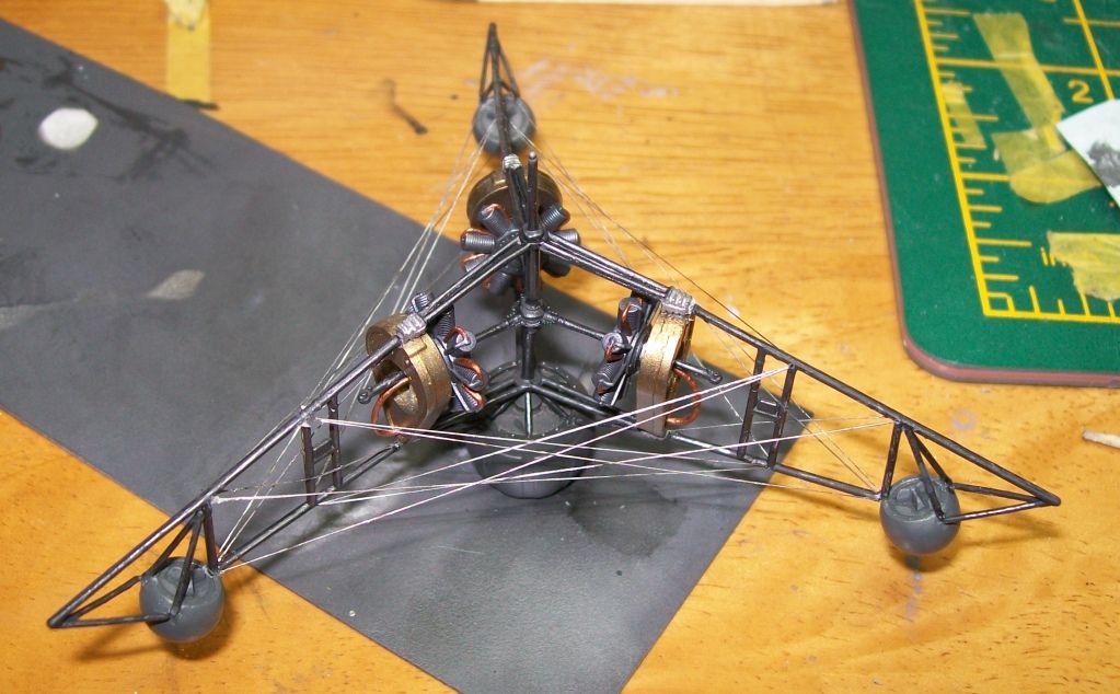

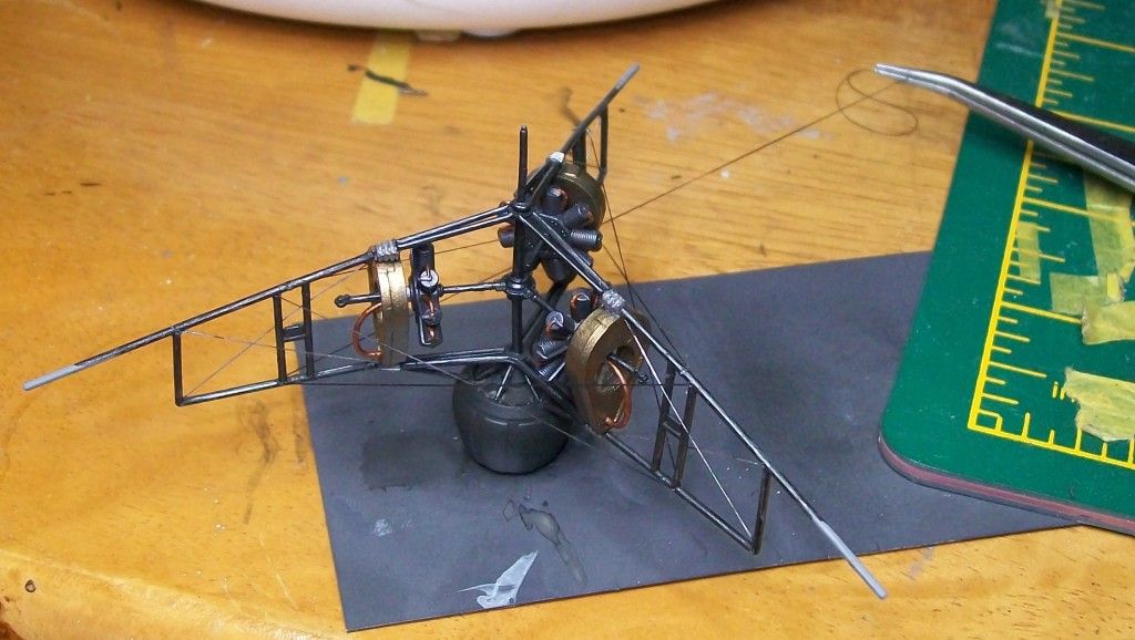

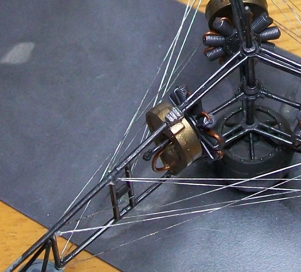

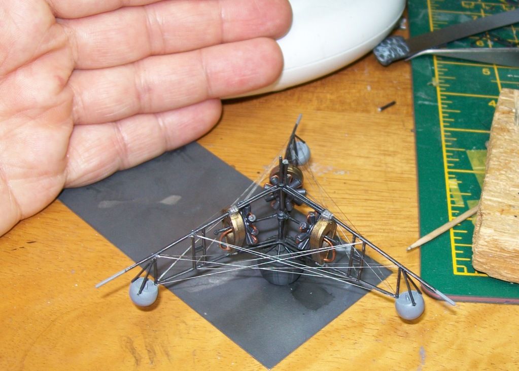

« Reply #25 on: May 22, 2012, 10:18:13 AM »
Thanks folks :)
Assembled the outriggers, rigged up with EZ Line and painted the rigging.  Added the end assemblies including the airbags.  Touched up the metalcote paint, which needs a polish tomorrow.  The hand in the pic gives an idea of scale.
This is further than I got last time, with the outrigger assembly.  Just need to attach the propellers and the bucket, the only bits to cut out and paint are the spacers for the shaft.
There have been no further mishaps, touch wood :)
