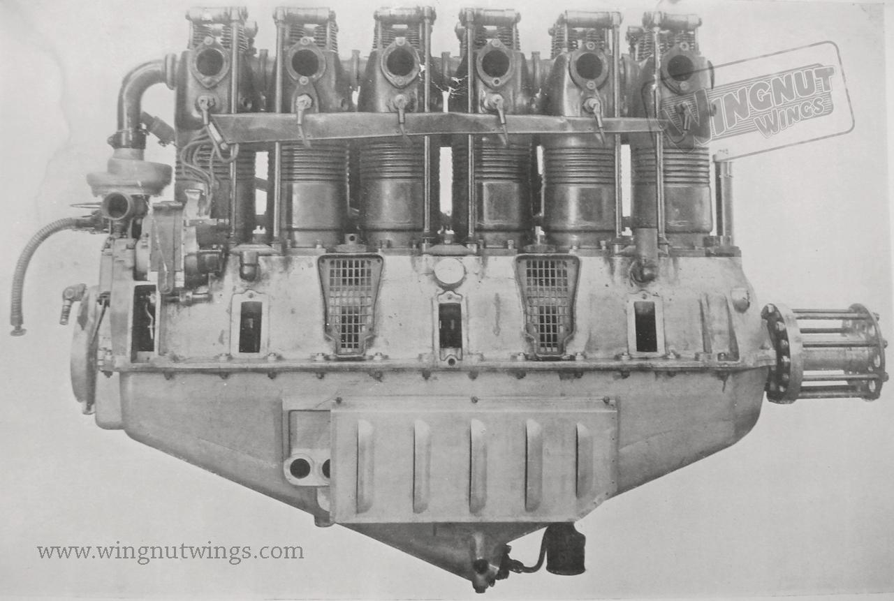

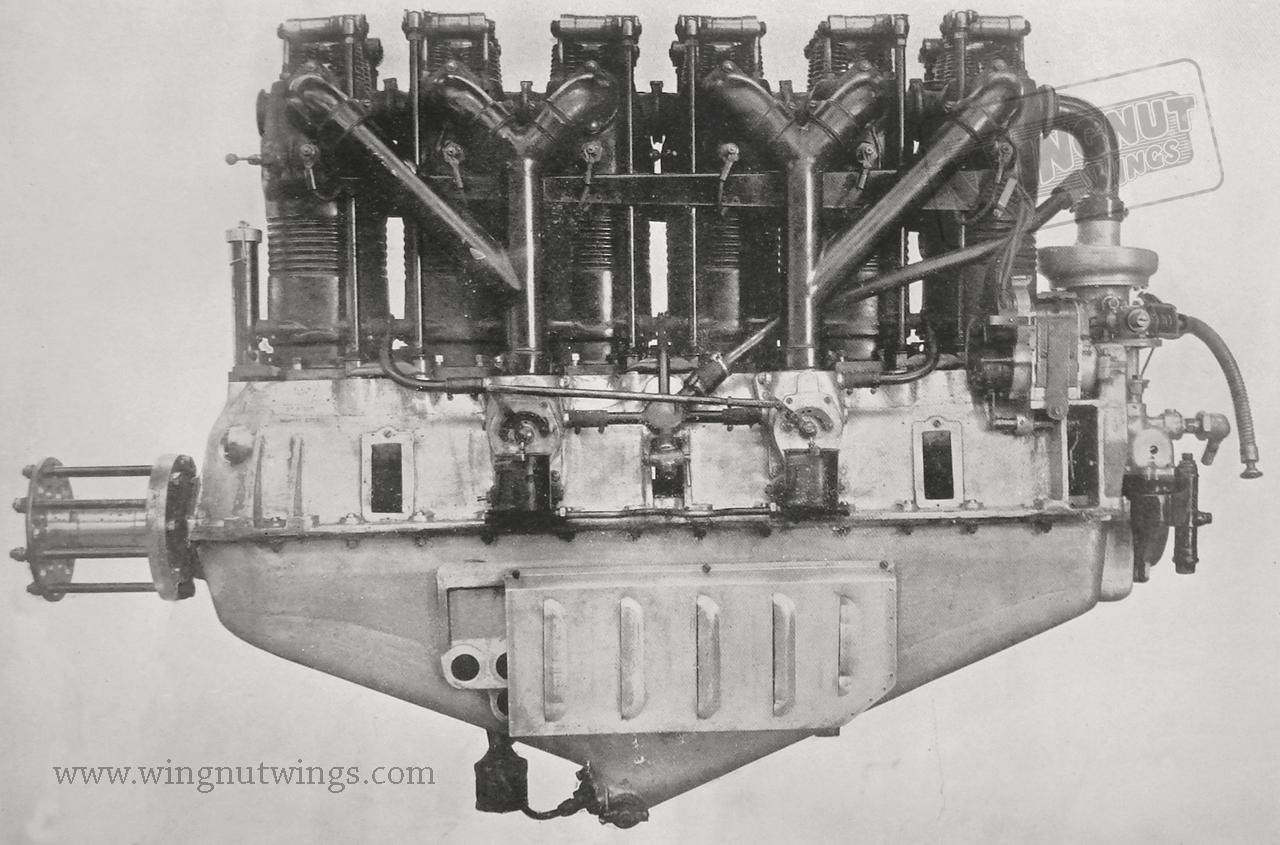

The Bz.IV was a dual-camshaft design, with two intake and two exhaust valves per cylinder. The cylinders were cast iron surrounded by a sheet metal cooling jacket. The crankcase was aluminium and pistons were initially steel but later versions had aluminium pistons. A high compression version of the engine (Bz IVü) was produced from 1917 onwards and can be recognised by the red bands painted on each cylinder.
General characteristics:
Type: 6-cylinder, water-cooled, inline aircraft piston engine
Bore: 145 mm (5.71 in)
Stroke: 190 mm (7.48 in)
Displacement: 18.83 L (1,148.9 in³)
Length: 1,990 mm (78 in)
Width: 530 mm (20 in)
Height: 1,150 mm (45 in)
Dry weight: 370 kg (820 lb)
Components
Cooling system: Water-cooled
Performance
Power output: 170 kW (230 hp) at 1,400 rpm
Applications:
AEG C.VI
AEG J.I
AGO C.IV
Albatros C.VII
Albatros J.I
Chitty 2 (racing car)
DFW C.V
Dobi-II
Friedrichshafen FF.49
Friedrichshafen G.II
Halberstadt C.V
Junkers J.I
LVG C.VI
Pfalz D.XII
R-planes, the German giants of WWI

I hope it's ok to post Wingnut Wings photographs? Posted for reference information and discussion purposes.
http://www.wingnutwings.com/ww/

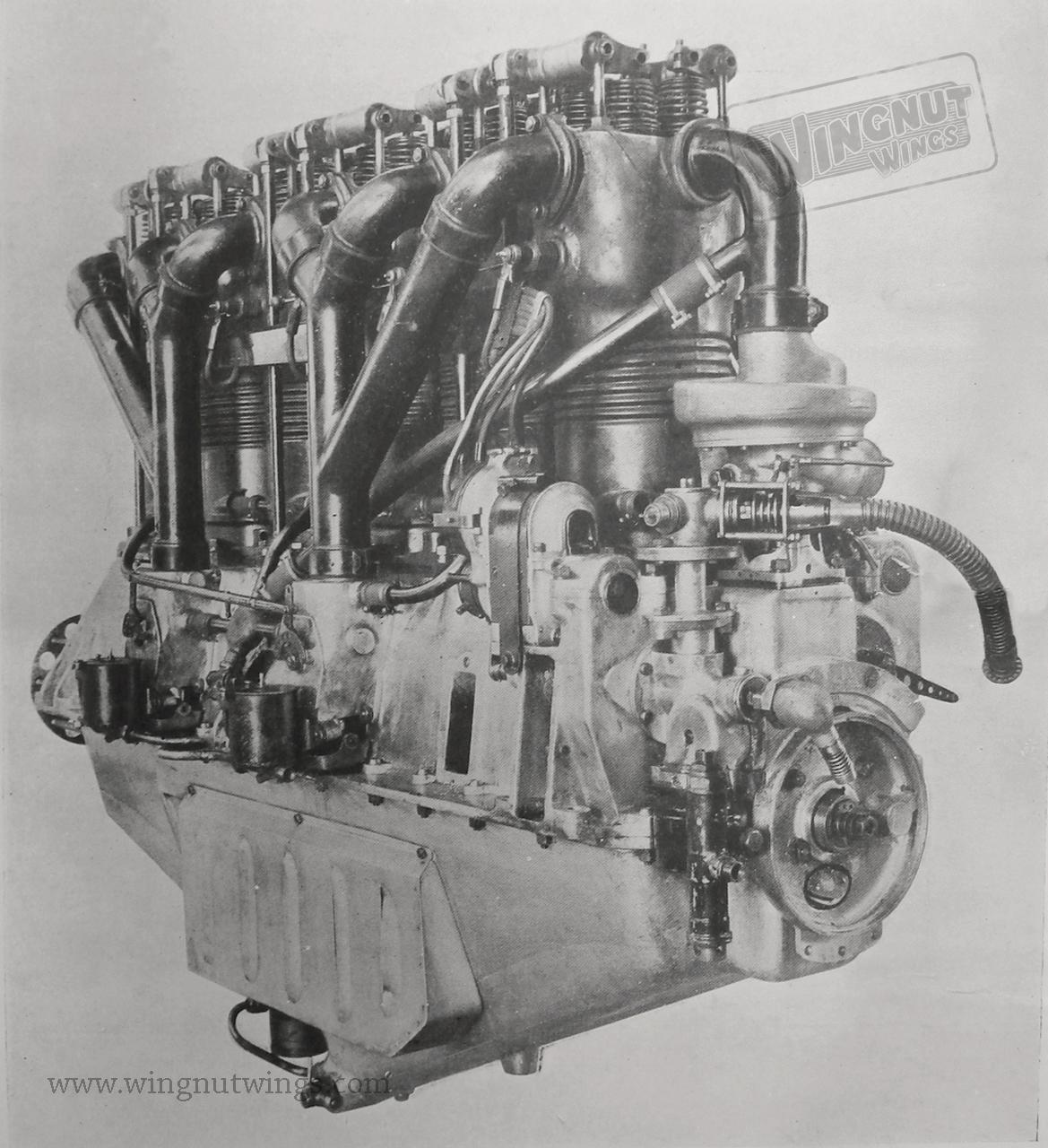

« Reply #5 on: November 06, 2012, 07:35:29 AM »
Wiring loom to magneto.
Don't believe that the connection is the same as in the D.III or D.IIIa engines. I'll check and confirm.

« Reply #6 on: November 06, 2012, 11:28:37 AM »
Thanks very much for posting these photos Loki, they are a wonderful source of reference material for anyone wanting to super detail their model engine.

The magneto's on this Bz.IV engine are different from the D.III and D.IIIa (and D.IIIaü) engines in as much that the electrical connection from the spark plugs fit to the side of the magneto rather than the front.
Please be aware.
