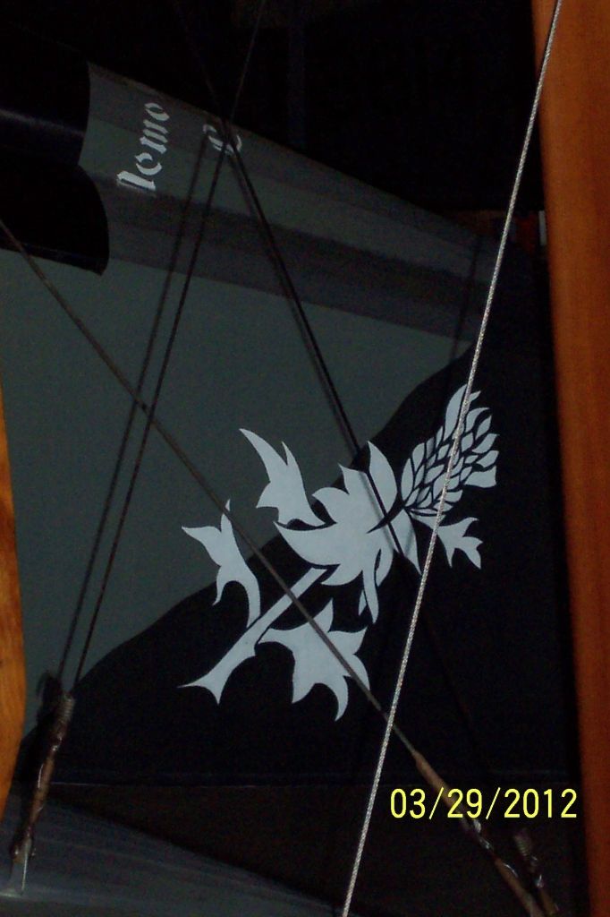

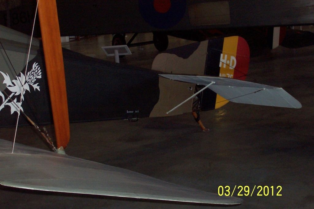

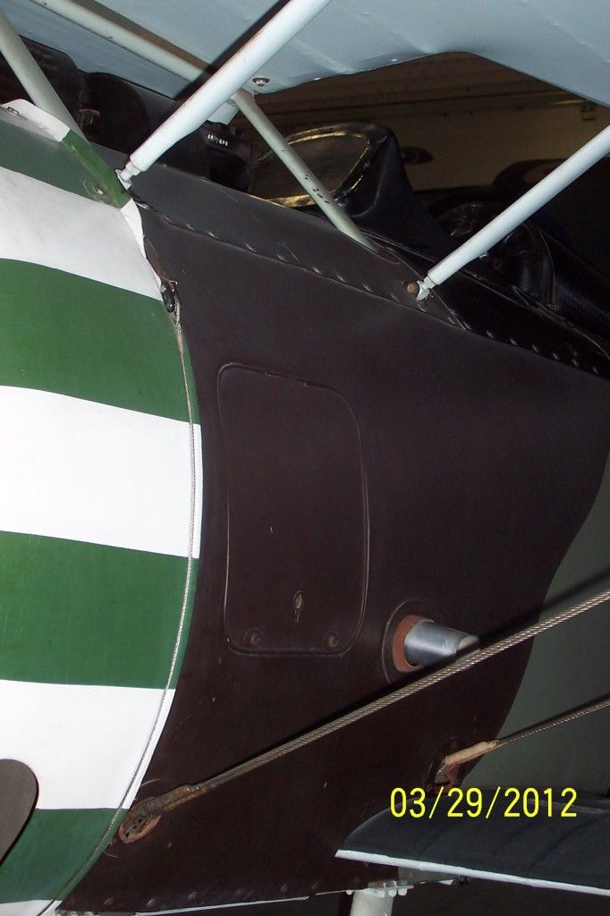

Great pics, thanks for posting them. Here are some of the RAF Museum example, not quite as good I'm afraid...
