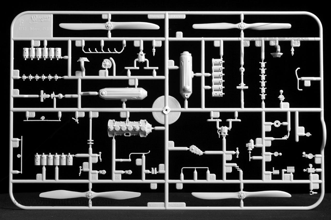

Well, I found a couple 1/32 Merc d.iii engines at Sprue Bros.  One from Roden for $20 and one from True Details for $13.50.  The TD engine looks like better details, so I ordered one and some plastic sheeting.

« Reply #11 on: October 30, 2017, 11:01:35 PM »
It's a personal thing, I'd rather not have a resin engine.
It does look a nice kit:
The Roden engine comes with a load of photoetch to stick on with CA:
Which in my hands falls of again
The WNW one covers several variants:
At $15 it a bargain!
This is going to be an interesting project. If you haven't got a copy, Harry Woodman's 'Scale Model Aircraft in Plastic Card' is highly recommended
