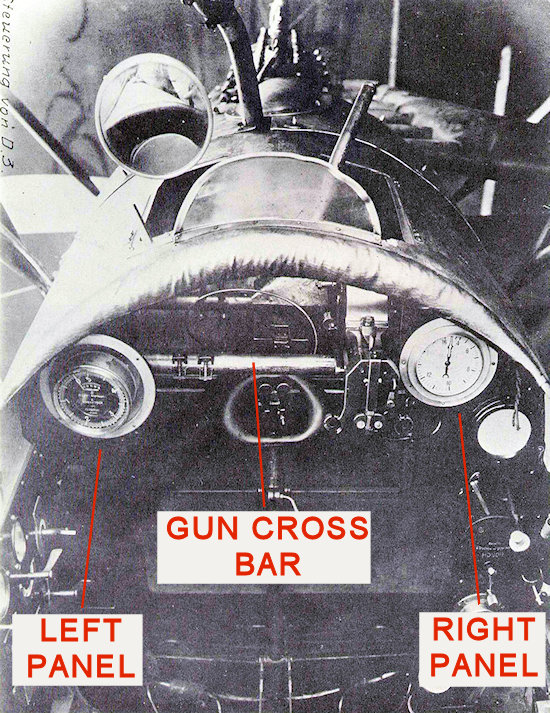

Some details of the cockpit needed modifying to better reflect a Series 253 series aircraft.

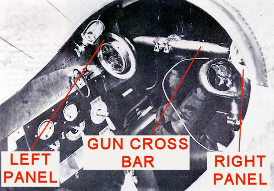

The pilot's instrument panel was not a single span panel, but two separate panels (left and right).

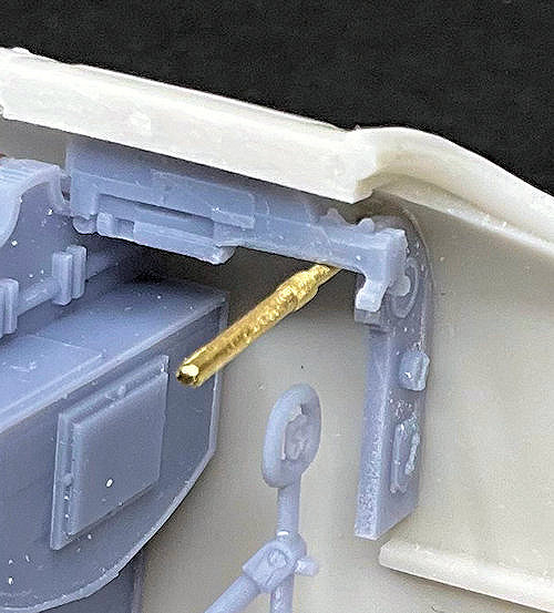

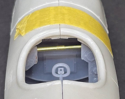

The rear of the two machine guns were mounted on a cockpit cross bar.

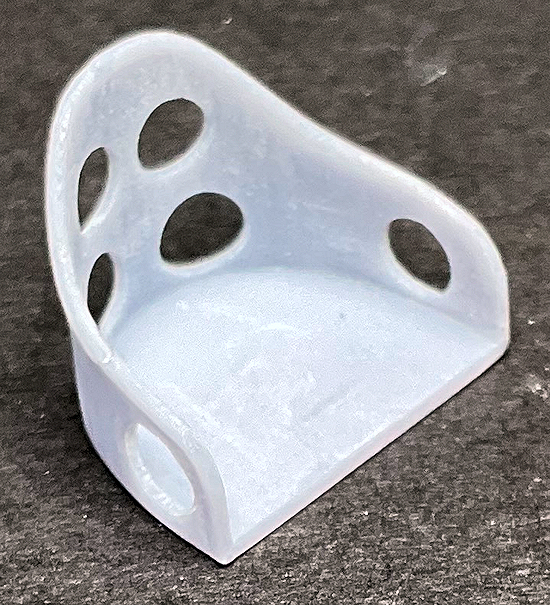

Also, the pilot's seat was not normally solid wood, but had several large lightening holes
Therefore, I've cut the instrument panel into two panels, added a Brass rod/tube cockpit cross bar for the machine guns.
Also added lightening holes in the pilot's seat.

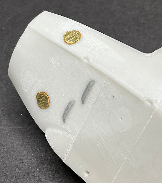

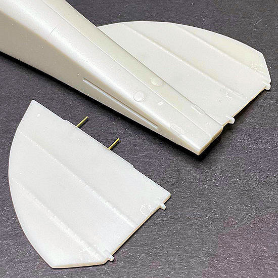

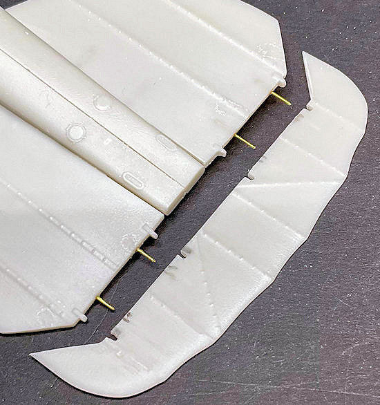

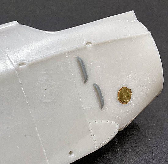

I've removed the cast hatch panels and cooling louvres from the fuselage.
Kit photo-etch alternative panels fitted with 'Proper Plane' replacement cooling louvres.

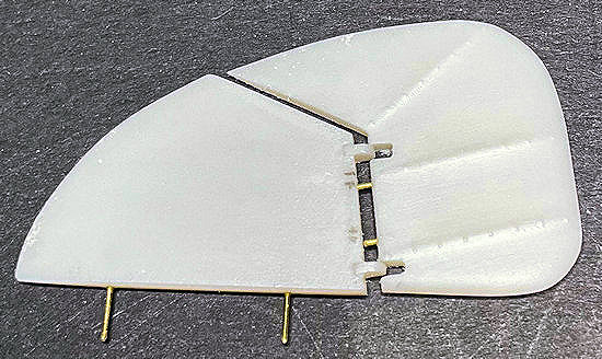

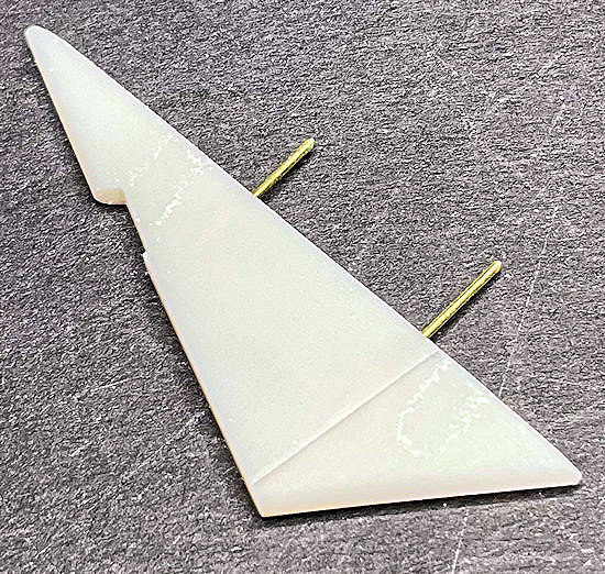

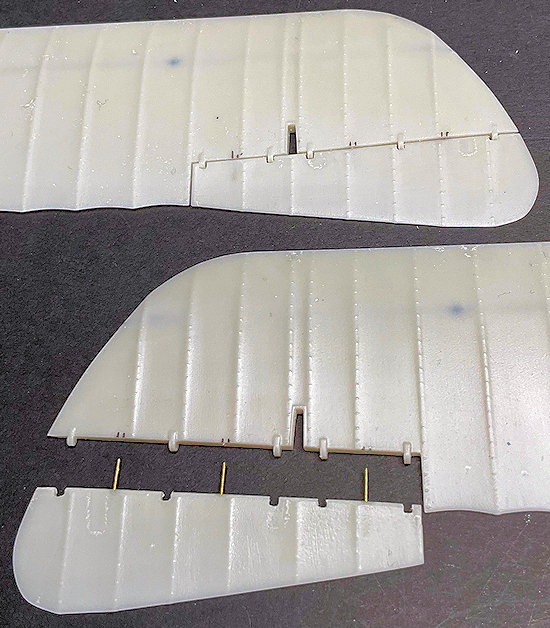

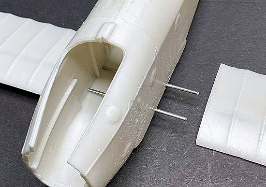

Support rods added to flight control surfaces etc,

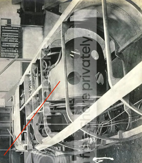

I have this one on the shelf to do at some point so I'm following with interest. I'm definitely going to put a pilot figure in it to hide the incorrect cockpit (much of it is wrong), unlike Paul I'm lazy! I'll just correct the instrument panel.

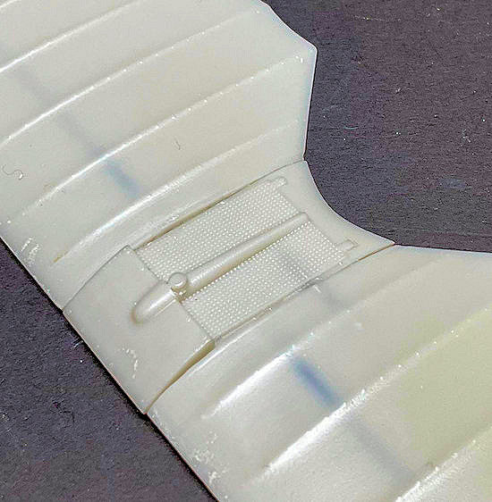

The big thing that's putting me off doing this one is removing the rib tapes. Not only are they overdone the kit IMO, there weren't any rib tapes on the Oeffag DIII anyway so they should be removed completely. Koloman Mayrhofer established this in his research for his DIII replica builds - they stitched the wing fabric directly to the ribs without rib tapes, see below:

Yes removing the cast rib tapes should be straight forward enough.
Representing the stitching could be a the problem though - we'll see,
