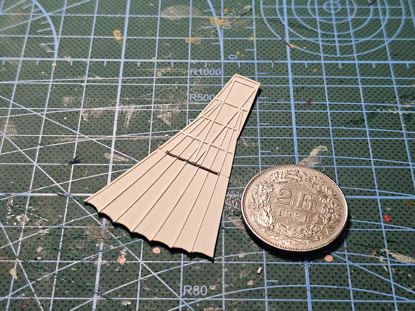

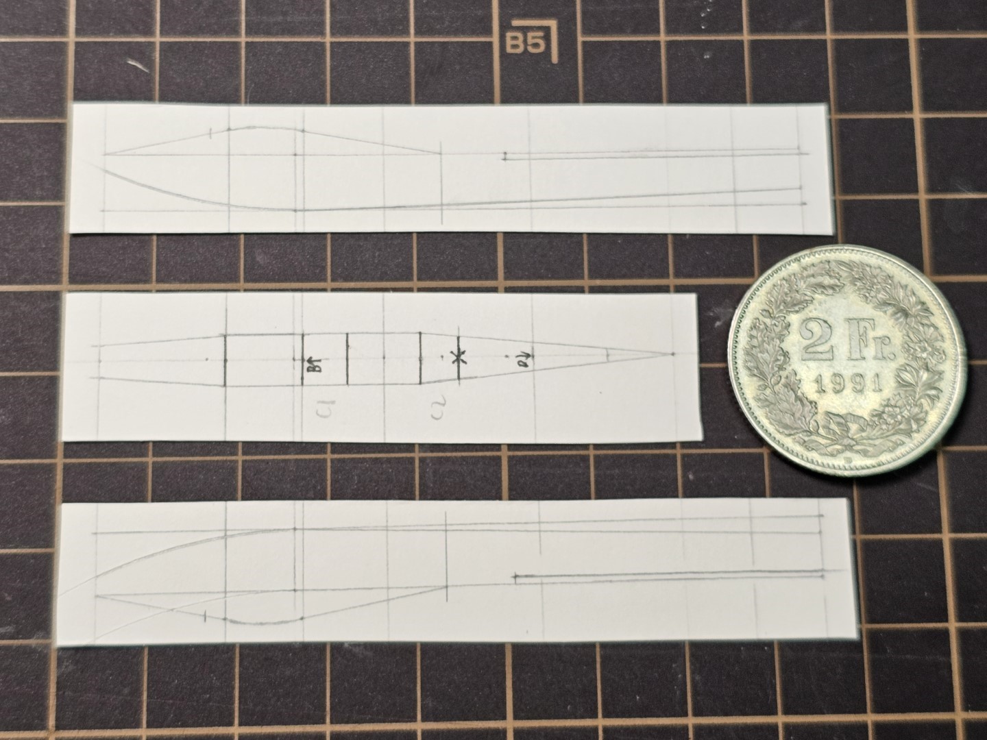

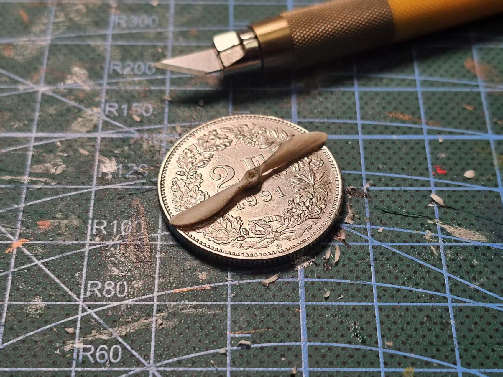

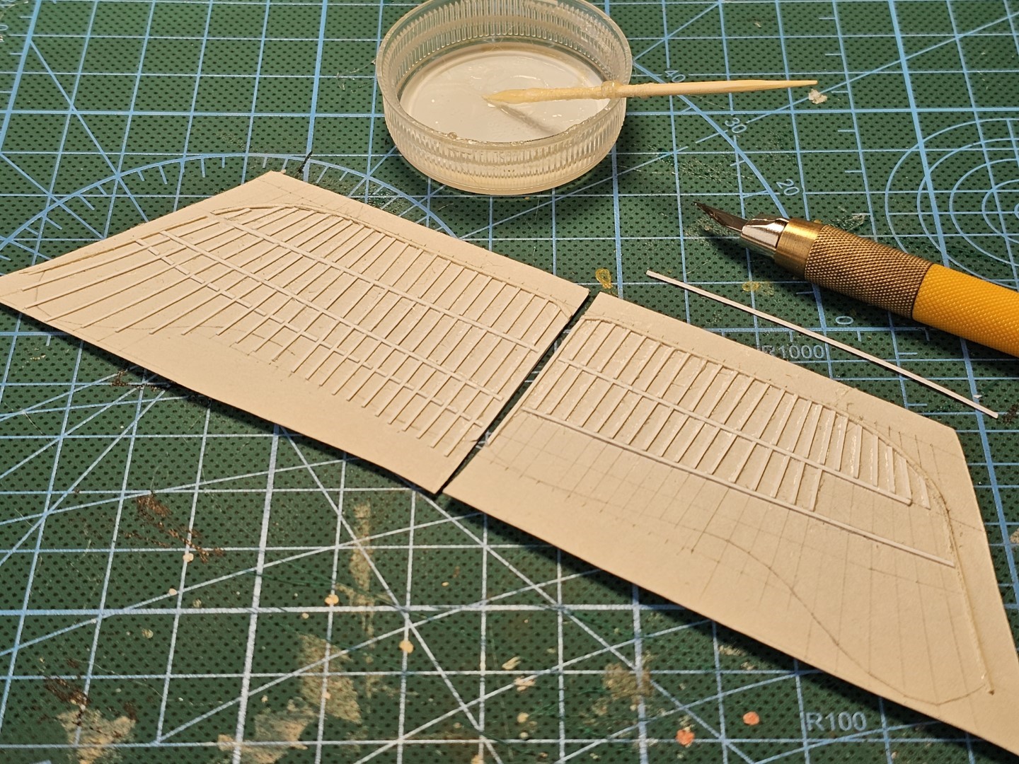

Like I said I mainly used paper and super glue. Specifically, I mainly use 200 grams thick paper card and cream-colored paper under 70 grams as the primary materials. My past experience building paper card models has really paid off.
My friend once found that when paper is fully bonded with super glue it becomes just as rigid as plasticard. When I used his building technique, I found that paper becomes more translucent when damped by super glue, and it's just perfect for replicating vintage aircrafts' fabric covering. I used 70g cream-colored paper for the covering, and cut the 200g paper card into thin strips to replicate the wing ribs.
The rest of the build is quite similar to scratchbuilding with plasticard, except that I use 200g paper card instead. The whole process requires loads of super glue, its strong fumes when drying and its high viscosity can be pretty torturous, but hey, the end result makes it all worthwhile!
Here are some work-in-progress photos.

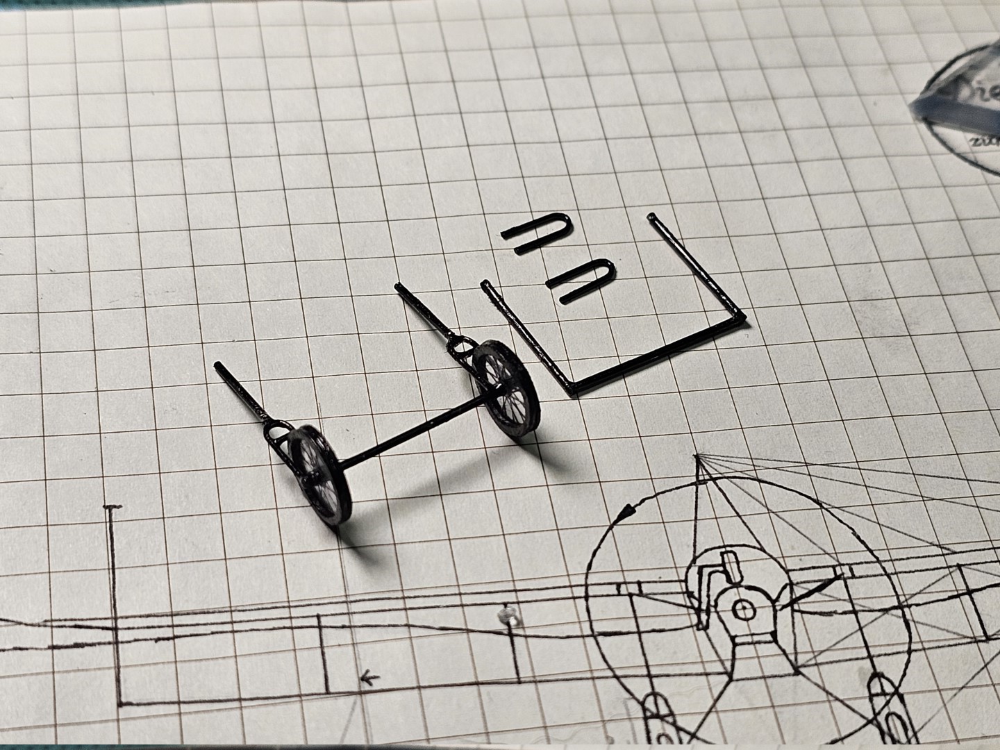

Yeah you're right, I use transparent plastic disc to replicate the wheel spokes, which is convenient when scratchbuilding in irregular scale. You know, there's no 1/90 PE parts in the market.
I solder brass and iron rods with each other which diameter is bigger than 0.4mm to replicate struts. As for rigging, I use half-dried gel-like super glue, just a little bit of glue per gluing is fine.

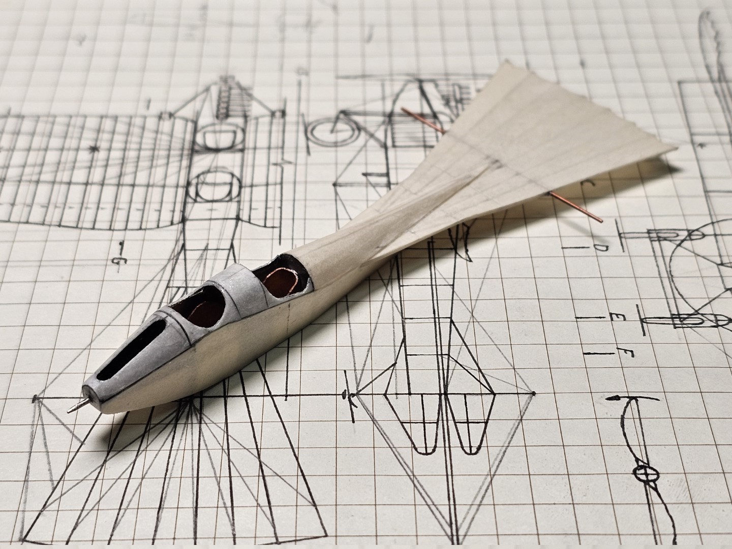

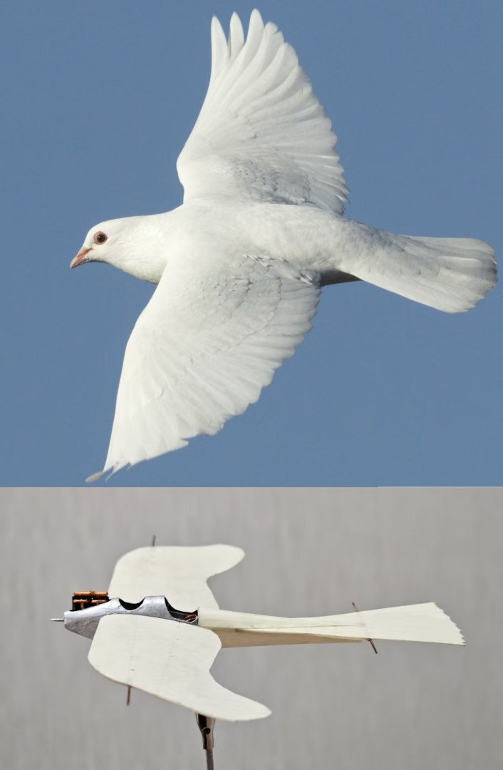

I particularly like the first two pictures you have presented. They really show the aeroplanes bird like resemblance and it's inspiration in the Zanonia seed. In fact, I find those first two images so inspiring that I have printed out copies and have posted them in my working area.

Thanks Graham! Here're some hints while using this technique:
You can control the thickness of paper to adjust the translucency level. Build some test samples to find the best translucency level you need before scratchbuilding.
Paper soaked in super glue becomes rigid, but also brittle——it will snap if bent too far, much like a thin, dry, grainless piece of wood. So be sure to shape the paper into your desired form before applying the glue, especially for curved parts. You should apply super glue on your parts in the very final stage of parts building, and very-small-area gluing.
Second, if you apply too much glue, a white haze will form around the uncured adhesive. Also, excess glue droplets, once cured, will leave an uneven surface that is very difficult to remove even with sanding. So please be careful to control the amount of glue. Not too much, just apply some super glue on the surface of paper parts, make it just wet through the other side of paper and don't have droplets on the surface is ok.
If you wanna draw lines on your paper parts before applying super glue, you'd better use a pencil, because super glue can dissolve the ink from liquid ball pens and fine markers, leaving dark blotches on your parts. Wait until the super glue on the parts is completely dry before painting.
When the super glue cures inside thick paper, the parts can get extremely hot, I don't know why, maybe “the liquid releases heat as it solidifies” also applies to super glue? So please be very careful.
There is an old Chinese saying: "One becomes a doctor after long illness(久病成医)" and these are all hard-learned lessons from my own experience. I hope they're helpful to you.
