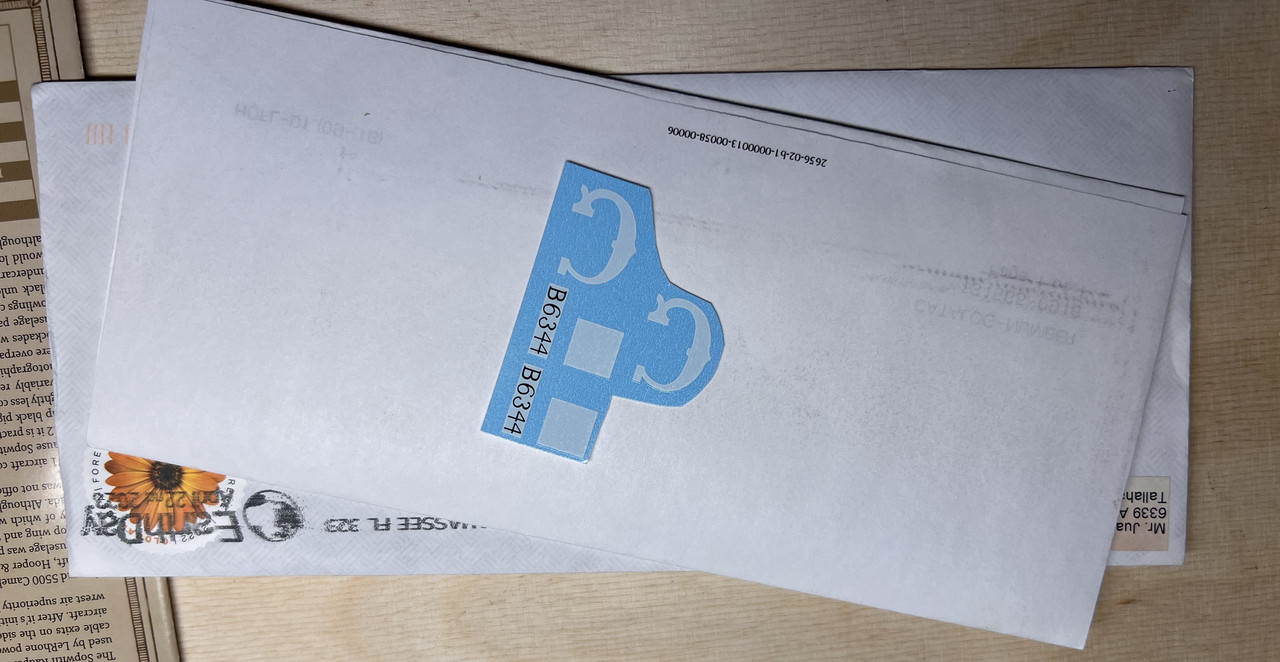

2. Since 2023 when I had decided to build this machine I have the decals for it. It is No. 2 of the Pheon set 32072 Sopwith Camel Aces of the RFC and RAF, vol 1. I do not own this decal set and back in 2023 Pheon had disappeared from the market, so I asked in this forum if anyone would be able to help me out. It is pure coincidence that this happened on April 20 2023. And I had not to wait for long at all when our member Juan was so kind to send me the decals for this machine for free. Thanks again, Juan! I sadly have not read from him for a long time, I hope he is well.
