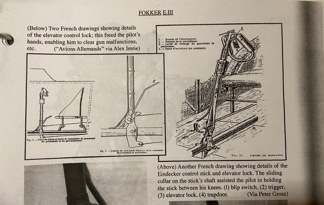

More from Achim:
Quote
You can see the elevator damping device in the upper left corner of that French report
Drawing via Achim Engels 01 by Zac Yates, on Flickr
And here is the original Factory drawing by M.A.G. of the damping device of the Fokker M.21 in Austrian service.
Drawing via Achim Engels 02 by Zac Yates, on Flickr
It is a lever arm that attaches to a friction disc which damps the forward and aft movement of the control column. Not exactly a trim device but maybe considered a forerunner?

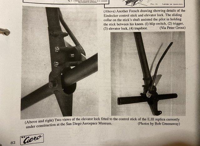

Re: Elevator trimming on Central Powers types
« Reply #7 on: December 16, 2023, 10:31:47 AM »
I happened to have these to hand, since I'd copied them out of WWI Aero (not sure which issue, but I can look it up if anybody wants) the other day in the course of my Eindecker research project. According to these captions the device is actually an elevator lock used to keep the aircraft flying level while the pilot wrestled with the machine guns when clearing jams (Fokker's misappropriated interruptor gear being still in its infancy) rather than a way of trimming the a/c per se.
