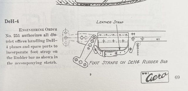

No luck finding anything about the belts in the -4, all I could come up with was this snippet about the foot straps on the rudder-bar; interesting, but pretty useless for 1/72 unless you're crazier than I am:
Odd how every once in a while you find a complete black hole where information is concerned (ever see a photo of the bottom of a French 2B2 Strutter?), where other times you have data glut (every variety of control column for a Dr.I, for example).
