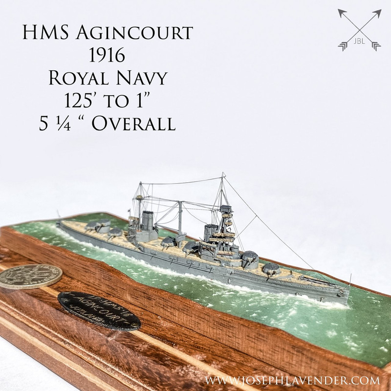

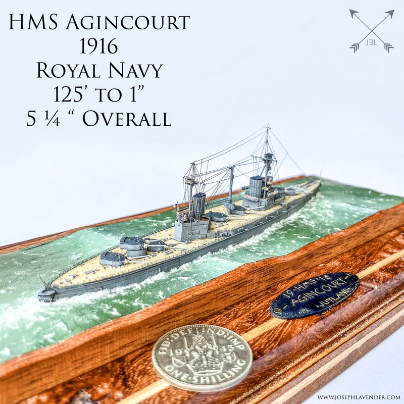

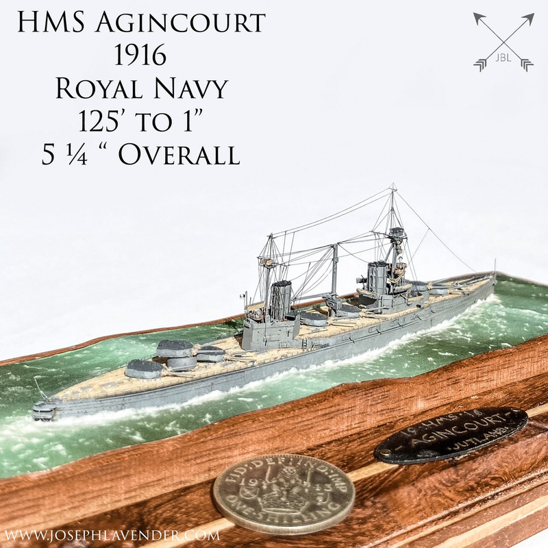

Greetings. I’m in with another 1/1500 scratch build, this time HMS Agincourt as she appeared at Jutland. The model is made from boxwood, aluminum, and brass and measures just a little over 5" or a bit more than 13cm. The rigging is Nitinol and copper wire.
If you'd like to see more of my ships, I have a website with photos of them at www.josephlavender.com
Agincourt is well-known for carrying more main caliber guns than any other battleship ever built, fourteen. She was originally built in Britain for the Brazilian Navy with the stipulation that the ship's design be "impressive", however after the rubber market collapsed, Brazil could no longer afford the ship and she was sold to the Ottoman Empire. On the eve of WWI, the ship was seized by the Royal Navy from the Ottomans at the builders yard. She was refit to RN standards and many things were changed including her torpedo net booms being removed and the distinctive flying deck over her central turrets removed as well.
Agincourt was modified throughout the war, and I chose to depict her as she appeared passing Windy Corner at the battle of Jutland, 31 May 1916. This proved to be a difficult fit to model as there are few drawings or photos of the ship in mid-1916. I was able to scrape together enough references from my library of books to redraw the plans to my satisfaction. No easy task. Agincourt was eventually scrapped in 1922. An uneventful end to the uneventful career of this very interesting ship.

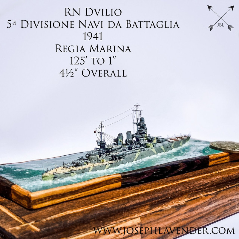

I decided a long time ago that was something I had to master if I was going to do this correctly. The sea bases are almost always boxwood, but in the past I’ve used jelutong. My mentor Philip Reed used jelutong for a lot of his construction, but I find it to be too soft, and the boxwood to be much more crisp. Personal preference I think.
The construction is pretty simple, carving to shape and painting. I don’t use any resins or gels, just paint to build up the translucent look. I sorta stumbled into the process accidentally through trial and error though. One thing I knew I wasn’t going to use was resin. I think it’s trendy and it doesn’t last, and in 20 years we’re going to have all these nice models with cracked resin sea bases. Resin also yellows. No bueno! Many layers of paint, translucent canvas paste, and a gloss canvas finish is all I use. I’ll tint the gloss coat on top ever so slightly, to give some extra depth on top, but that’s it.
Here is an example of the translucent look paint can have: This is RN Duilio in her “bones” camouflage. You can see the swell appears to be deep and rich, even though it’s just paint.
