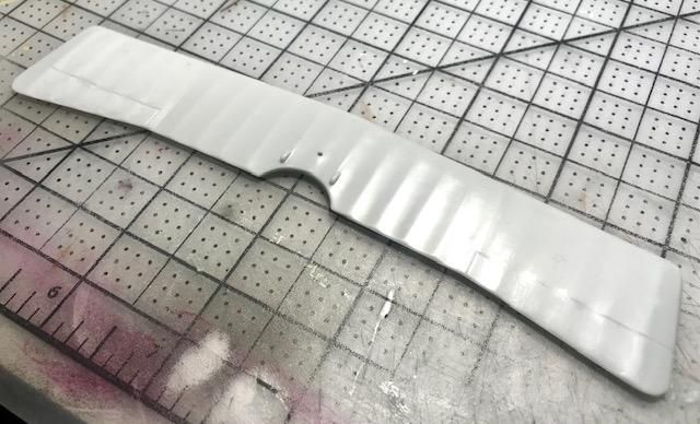

I wanted something to further practice my CDL technique and found this colorful candidate in the "olde" stash.
For years I was thinking this was a re-pop of the old Aurora kit but apparently not. Would love to put the two side by side.
Decals look usable so I started tweaking.

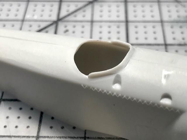

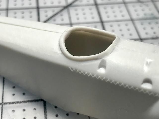

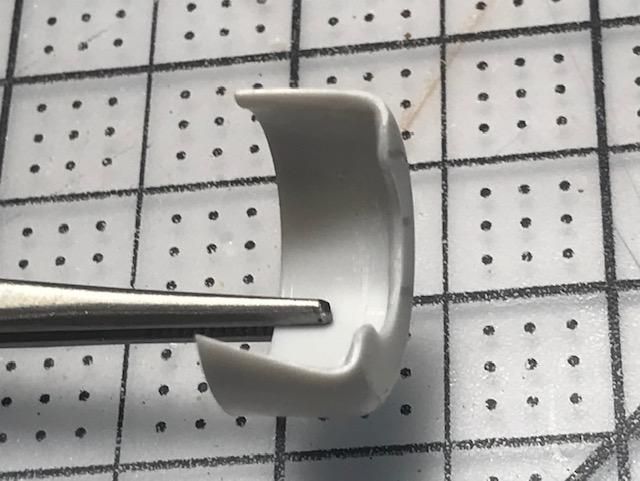

Cockpit with kit parts. Thinned down cowling.
Corrected cockpit coaming.

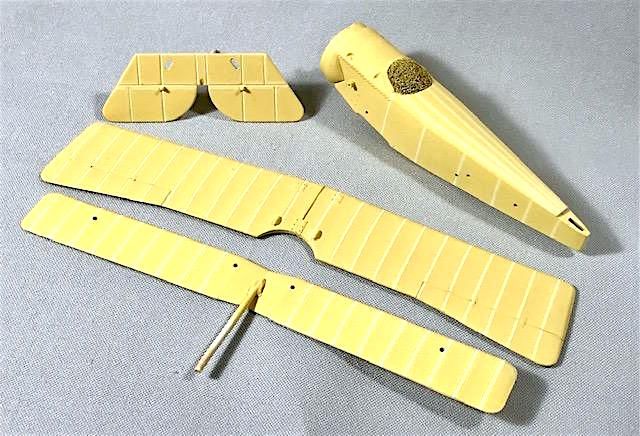

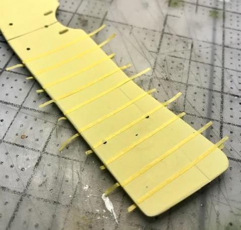

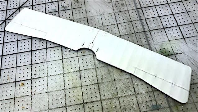

As I did with the cowling, I used furnace tape to detail the upper wing for hinges and gun mount. I added the slit for the two part wing.

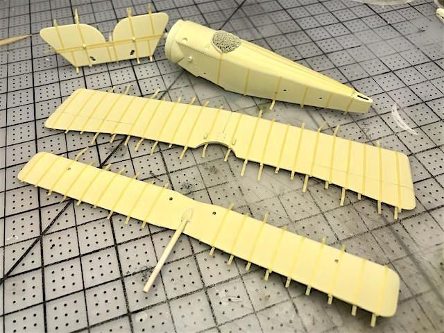

I primed everything with Tamiya fine white and then started doing the rib detail.
This is a two part process but simple and easy. I use the same for all CDL.
After the white primer I take my Vallejo beige and white and mix them 50/50 for the rib color and spray over all.
I use 1mm Tamiya tape and mask the ribs.

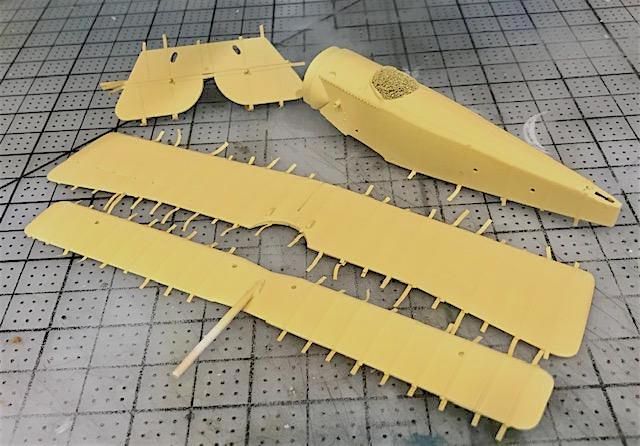

When all that is masked, I shoot the beige 100% then remove the masking tape.
Will add edge color to wings and such, Future then ready for decals.

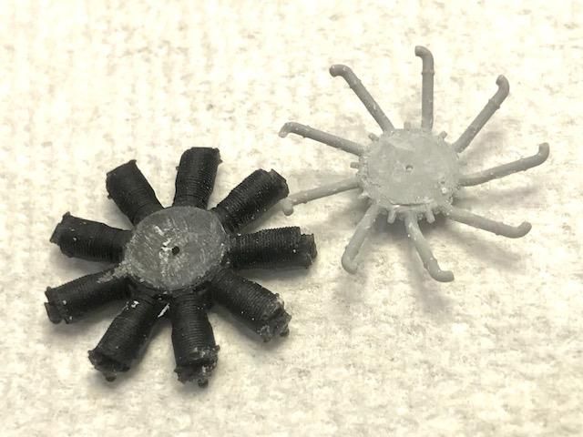

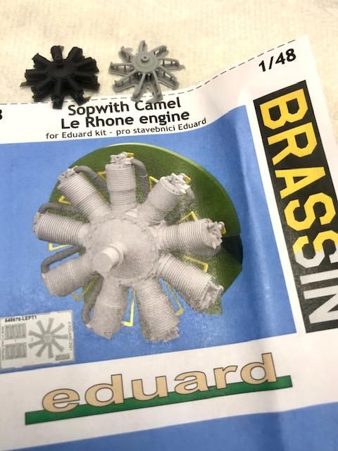

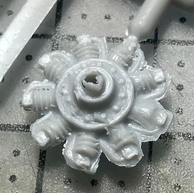

So, this is what I have in the kit for an engine and propeller.
I remember those old Alan Hall articles on scratch build engines by cutting the heads off screws and glueing them on a dowel.

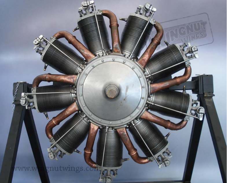

Not happening. Instead, I found a radial engine beautifully 3D printed but it's the wrong one, this is a 110 for a Sopwith Camel.
The biggest difference is of course the exhaust pipes are in front for the 80 and in back for the 110. This what I need it to look like.

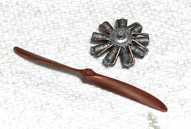

Surgery required. I ground off the front and back of the two pieces and mounted the exhaust on the front.
Close enough. Since I've kinda broken my own rule of no aftermarket, I went ahead and pinched a propeller from a Dr1.
All the major bits are done and we are ready to assemble and finish the little Bebe.

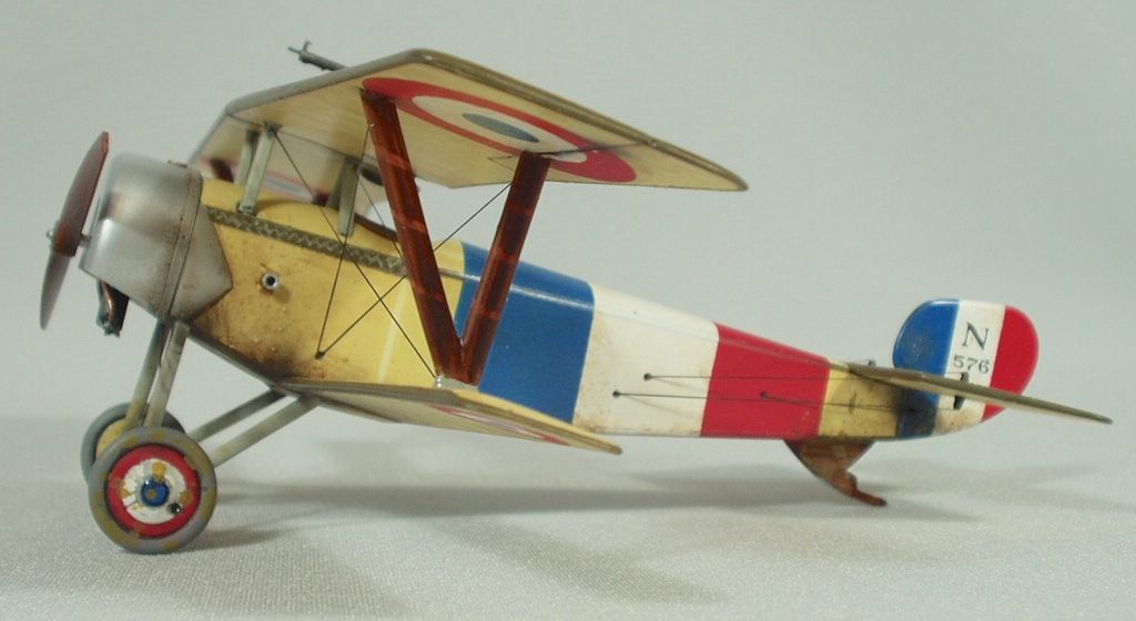

Thanks everyone for your encouragement. Finished build posted.
