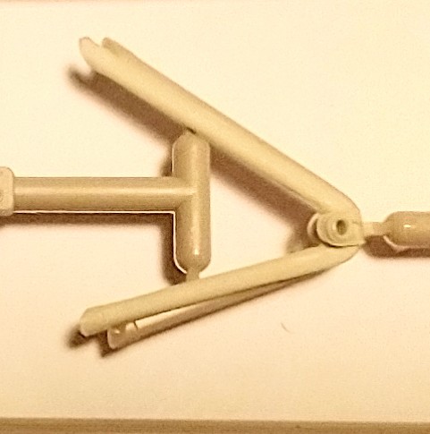

Re: Eduard 1/48 Albatros D.Va landing gear strut length?
« Reply #5 on: August 23, 2022, 11:35:03 PM »
I finally managed to measure the resin replacement part and kit part. The longest leg is 39mm on the resin part vs 37 on the kit part. So 2mm seems to be correct. The shortest leg is also 2mm different. I did take a poor photo of the resin part overlaying the kit part:
I Hope this helps,
« Reply #7 on: August 24, 2022, 07:13:57 AM »
Hi gents - a bit late to this one, but yes indeed the Eduard legs are ~2mm too short all around. The replacement parts that Rick mentioned are worth the investment if you want something quick and easy. The slightly longer legs do make quite a difference to the sit of the model.
That being said, i've built this kit a couple of times (and I am building one at the moment) and it doesn't take much to graft in extra plastic to the legs, it's just annoying and a bit time consuming smoothing everything out.
And yes the Eduard D.V wheels are about the right size; the Eduard D.III wheels are definitely undersized, though the legs are about the right length.
BC
