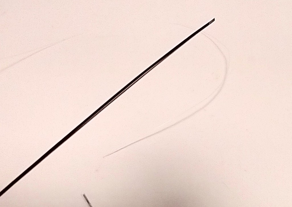

I took about 5 minutes to try an experiment with stretched sprue. I took 3 pieces and made a Sprue sandwich with the center piece being slightly shorter than the other two. With practice and figuring about half of ones efforts would fail, I think it has potential in 1/72nd for an easy solution. Sadly My Phone camera really doesn't capture the results very well. Very thin wire would probably also work. The size of the piece in the photo is 1mm width and 35mm length.

« Reply #8 on: March 07, 2022, 07:59:41 AM »
Brilliant solution Rick. Now,  . . . how to get it through a tiny hole in that H strut.
WD
Re: Doubled Landing/Flying Wires in 1/72nd
« Reply #9 on: March 07, 2022, 08:03:28 AM »
WD
I wasn't thinking of going through the strut with this solution. Just glue the ends to the center and the other end to the wing.One unit needed for fuselage to H strut and another from H strut to upper wing outer interplane strut. A little heat will eliminate any sag but with the short runs in 1/72nd there shouldn't be much sag!
PS: I also took a 1.5 mm width piece of extruded strut material and drilled one hole through. I didn't try Invisible thread but 2lb. test fishing line went through and the strut was not weakened. #80 drill bit was used. If one could use a #78 or  #79 on the kit strut I think two lines for the double wires would pass through. The single lines running from the cabanes to the lower outer interplane strut would have to be sprue or wire. I remember someone on the List advising Me to use a piece of card stock to keep the wires separate if running through one hole. Funny thing here is I now have some good ideas for My Next 1/32nd scale SPAD  8)
