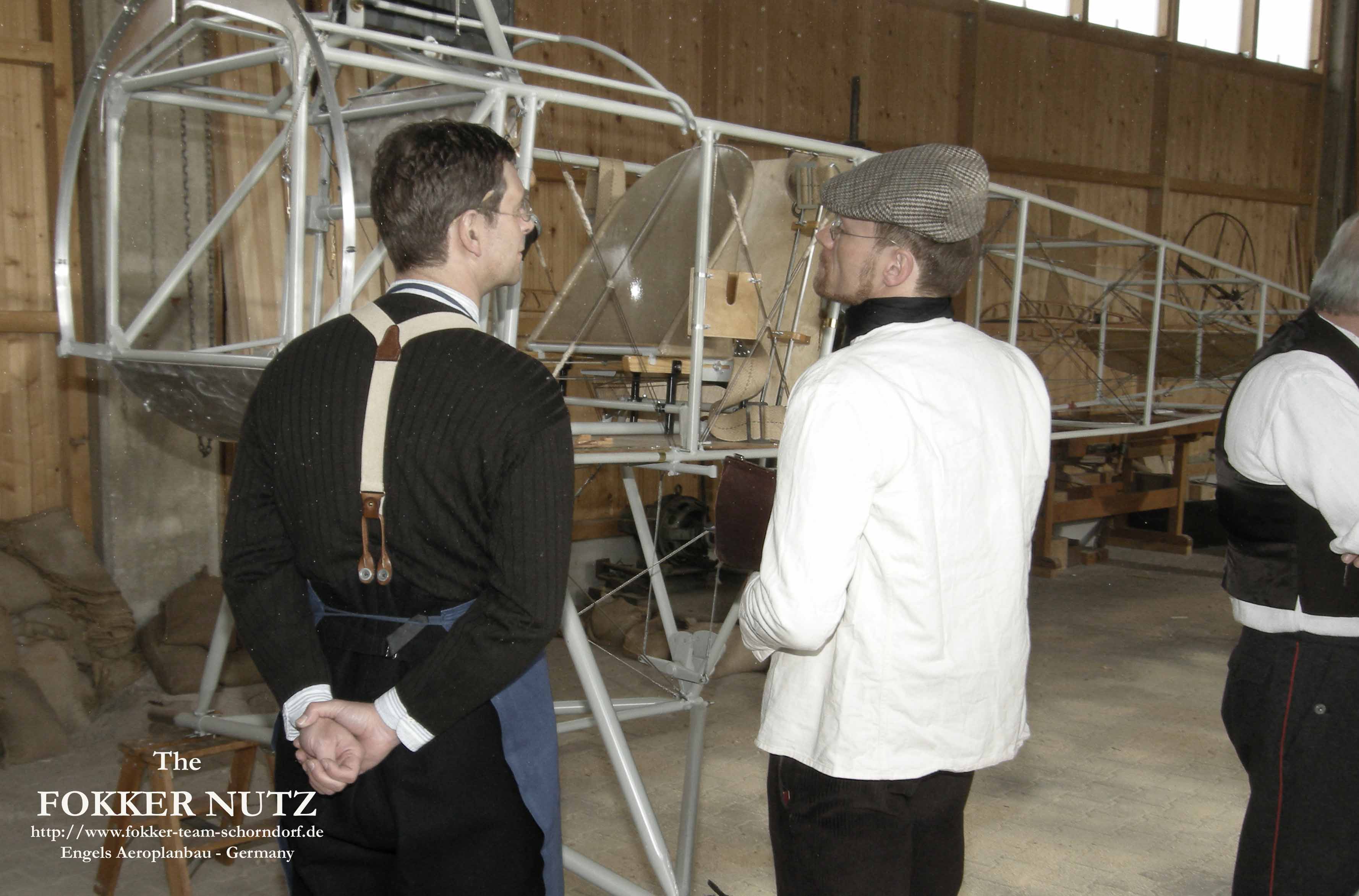

The late E.III or E.IV had a steel frame, wooden bearing surface and alu, plated with linen (or later lozenge) in the back.
Here a Engels Fokker:

In Engels pdf book on his E.III there is a picture on page 33, picture #78 showing the seat. You can clearly see that the frame is made from tube but externally it is covered with a leather like material to give it that "comfy chair" look. I am wondering now if this is just a modern attempt at adding a bit of comfort to the seat and is not period correct. Admittedly my focus on seats was of later Fokker aircraft but now I will have to start paying closer attention to earlier models not to mention Albatros, AEG, Phonix, (etc).

I meant that the seat construction is very comparable to later Fokker like the D.VII, so there alu+linen on a E.III was then alu+lozenge on a D.VII and other later ones.
Your leather pic is interesting, but I'm not sure if it was usual on all delivered aircraft. May be some special extra for some ace?
There is a "strip down" Fokker E.III in London, but it has only the seat frame (as on yours and my pic) but the back rest and wooden? seat board are missing.
