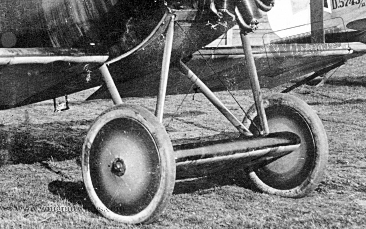

Some more poking around found some interesting images on the the Wingnut Wings site:
http://www.wingnutwings.com/ww/vFA3EFA01/www/products/model_kitsets/32027/archive_photos/Detail%20undercarriage%20Fokker%20D.VII%20(Alb)%20Jasta%2043%20Simons%20(0443-040).jpg
http://www.wingnutwings.com/ww/vFA3EFA01/www/products/model_kitsets/32027/archive_photos/Detail%20undercarriage%20Fokker%20D.VII%20(Alb)%20late%20production%20(0459-137).jpg
http://www.wingnutwings.com/ww/vFA3EFA01/www/products/model_kitsets/32027/archive_photos/Fokker%20D.VII%20(Alb)%20Jasta%2043%20Simons%20(0443-040).jpg
These are all of Albatros built D.VII and it seems that this was common on other Albatros built aircraft. For example this Albatros B.II

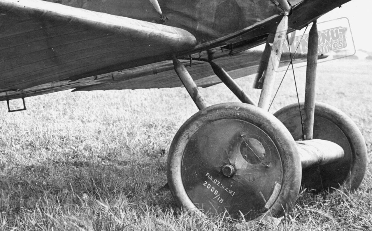

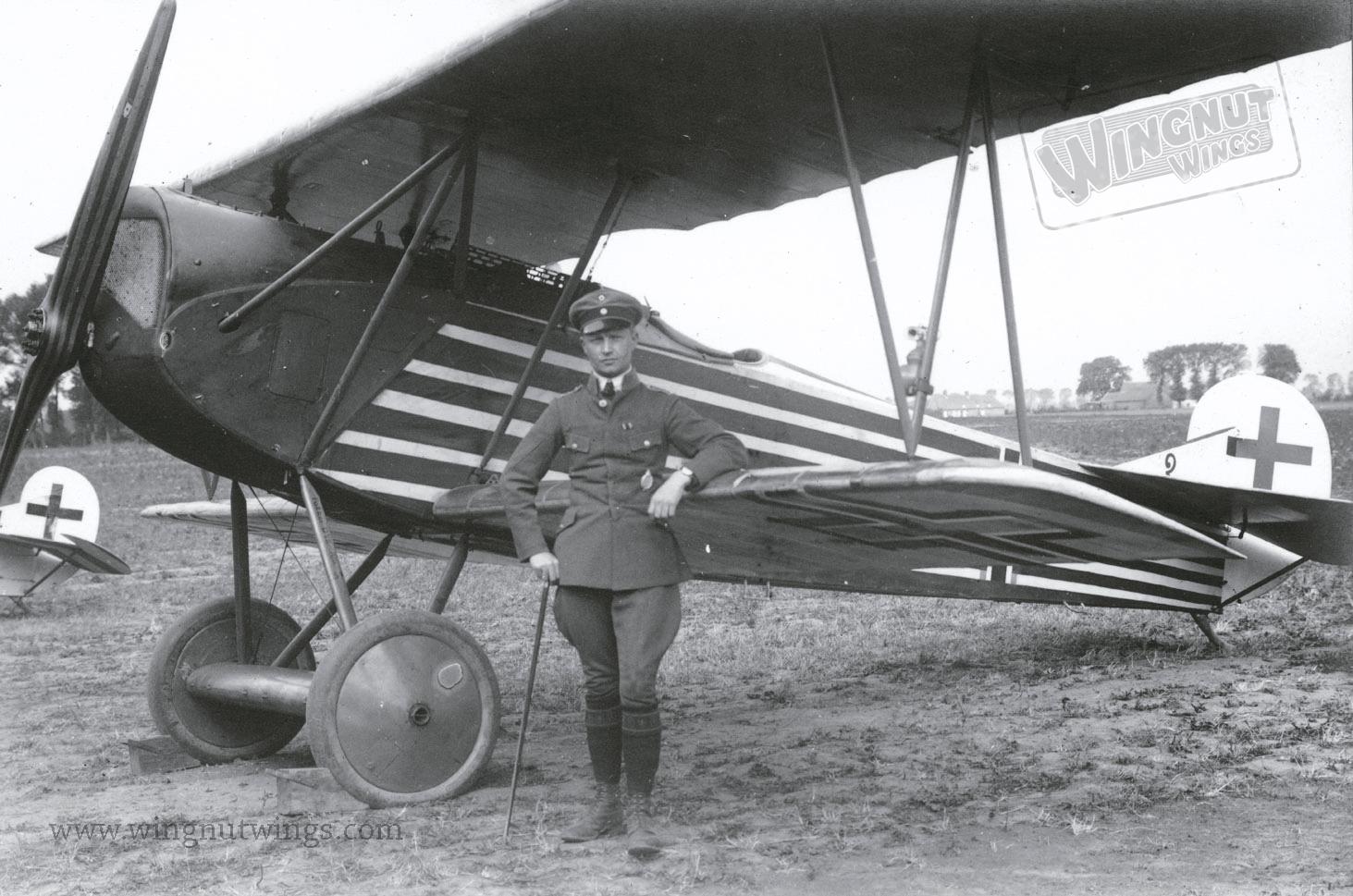

Now, this is a picture of an OAW built D.VII
http://www.wingnutwings.com/ww/vFA3EFA01/www/products/model_kitsets/32030/archive_photos/Detail%20undercarriage%20Fokker%20D.VII%20(OAW)%202009~18%20captured%20(Greg%20Van%20Wyngarden).jpg
It looks like the retaining nut either has a cap or was made in the form of a cap which screws onto the axle. Note also the visible safety pin or spit pin.

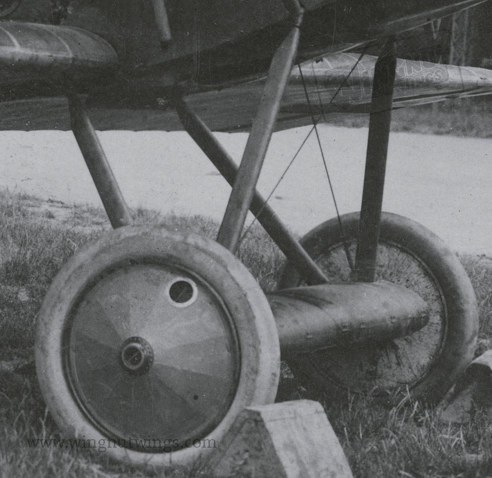

What about the Dr.I?  This image shows something similar to the Albatros built D.VII's but looks like the end is full of mud and the safety pin is also visible.

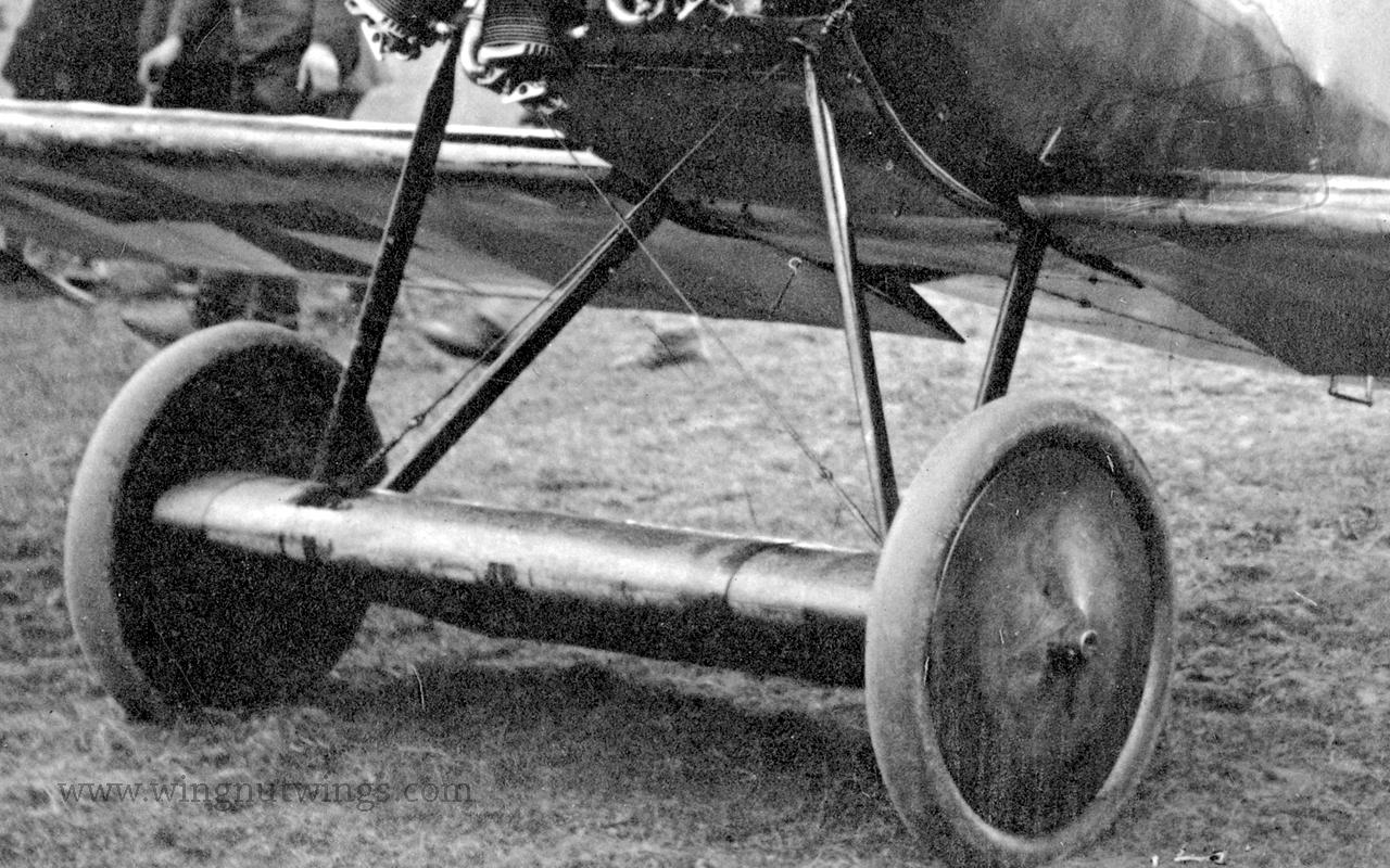

And this one of another Dr.I while not very clear looks like a cap of some sort but maybe the end is depressed in somewhat and the safety pin is also visible.
http://www.wingnutwings.com/ww/vFA3EFA01/www/products/model_kitsets/32069/archive_photos/Undercarriage%20detail%20from%20Fokker%20Dr.1%20525~17%20(0041-022).jpg

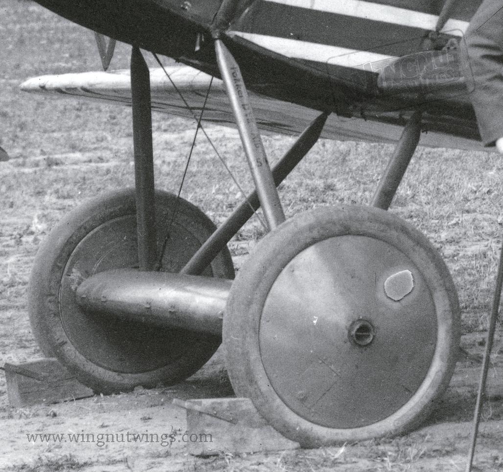

and like wise this one:
http://www.wingnutwings.com/ww/vFA3EFA01/www/products/model_kitsets/32069/archive_photos/Undercarriage%20detail%20from%20Fokker%20Dr.1%20403~17%20(001645-076).jpg

I think these are all similar solutions. It is either a ring or a cap that slips on to the end of the axle and is secured with a split pin
